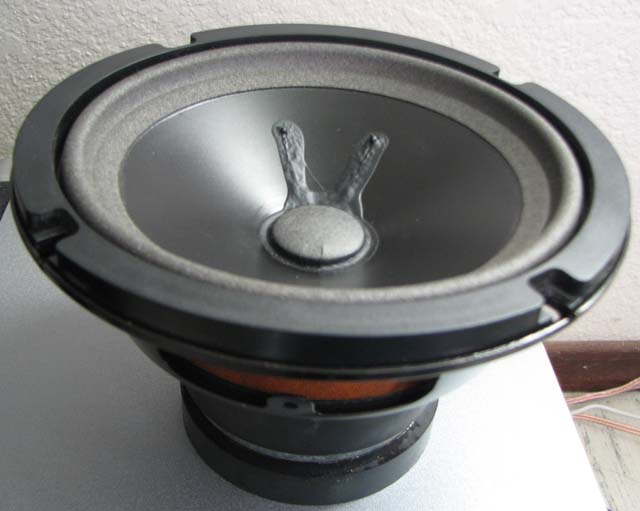

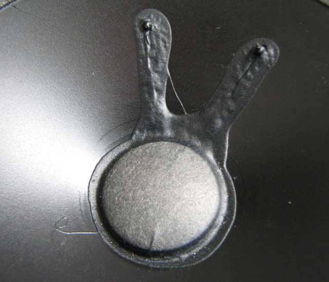

In the past I have had to do this with some 10" drivers I had, but for this speaker I am unsure how to go about it. The dust cap really does not have any sharp edges to get under. I have attached an image.
Run the driver while it's out of the box before you do anything with the dust cap. Your cap appears to be mounted directly to the voice coil.
Cal Weldon said:Run the driver while it's out of the box before you do anything with the dust cap. Your cap appears to be mounted directly to the voice coil.
Well I tried running it out of the box (at low volume) and it has the same problem so I am sure it is the driver now and not the box/amp making the noise.
Cal Weldon said:That's either good news or bad depending on how you look at it.
I will go with good news 🙂 I can always replace the driver if need be, but I dont have the tools to repair/rebuild the box at my university apartment.
