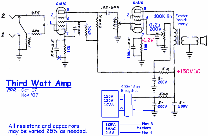

On behalf of the kid, I suggest something simpler, so it gets done before he is 8.
On behalf of his mother, and your neighbors, I suggest something smaller. 300V amps rock the whole block. A part-Watt amp is really plenty for in-home no-drummer use. (Tell me the kid's friend is a drummer.)
Hah! This plan is older than your kid!
This plan is an inside joke. Someone said the 6AU6 is not a power amp. "Sure it is!" I say, "just a very small power amp!" Another person wondered if there were anything smaller than a 6V6 Champ amp. I pulled up the first Champ (used 6AU6 preamp) and cobbled it. The OT has to be higher Z (Fender Reverb is suitable) and the supply voltage has to be lower.
Builders report it plays OK, louder than they expected, but indeed in the same speaker it is no Champ Amp.
"6AU6" can be almost any pentode rated for "IF amplifier" work. (But NOS 6AU6 is as cheap as anything.)
See the pot on V2, feeding the "extra grid"? This is an aspect of pentode operation. For a first-build, I suggest you omit the pot and wire screen (pin 6 on 6AU6) right to the B+. Full Voltage on Screen. Maximum output.
When mother complains, add the pot. As you turn it down, maximum power output drops from the whopping 0.3 Watts to 0.1W, 0.03W, and finally fizzles out when the tube is too starved to pull any load at all. (Don't say Power Scaling, that is someone else's trademark.)

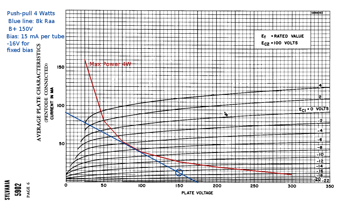

I did a little fiddling around with Catslab's original concept (push-pull 5902 or equivalent Russian valves.)
My quick-n-dirty load line attached. Easily obtained 8k Raa push-pull transformer, 150V B+, 100 volts on the screen grids, roughly -16 volts for fixed-bias operation, 15 mA idle current per valve as a starting point. Estimated 4 watts RMS audio output power. (Enough to be very loud in a home!)
As per PRR's suggestion, a 120V:120V isolation transformer feeding a (silicon) diode bridge would probably be a good way to get the 150V DC B+ voltage. Some experimenting needed to find the right resistors to get 100V for the screen grids, or one could even use a 100V, 5W zener diode and series resistor.
-Gnobuddy

There is an archaic, complex, elegant, and quite unnecessary way of combining the curves from two valves in push-pull into one giant set of compound curves; I've seen it in a few books from the valve era.I wasn't remembering (maybe I never knew) how to trace for pentodes in PP
That is probably the "right" way to do push-pull, but I've never seen the necessity for it, especially since pentodes and transformers both have fairly large tolerances, and even more especially since we're talking about guitar amps, and not trying to get things as linear as they could possibly be.
So I just look at one set of curves, but bias it for class AB, rather than class A, as you'd do for a single-ended amp. And I allow for the fact that the anode-to-anode load impedance for push-pull is four times the impedance seen by one transistor.
Technically there should be a kink in the load-line at the point where the operating point moves from class A to class B, but once again, we're talking about guitar amps here...
So the rough starting point I showed on that image should be enough to get your project going, if you choose.
The most probable answer is that you'd get destroyed output pentodes, particularly since these are subminiature tubes with electrodes crammed into a tiny, tiny envelope. But there's only one way to be 100% sure!I asked myself, what if I'd throw 230V like on the schematics I posted ? 🙂

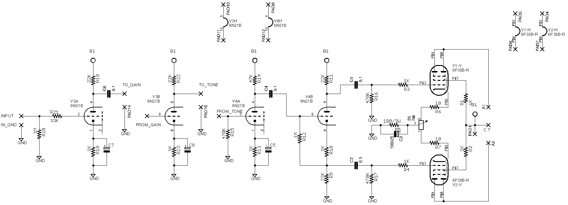

Happy New year !
I drawn a schematic of the amp
I just thrown values for the components. I did not calculated any for now. This is just a pre alpha version.
The power will be around 120V for the screen, and I do not know what will be the B+. It might be 120V as well...

Catslab, I can't see your schematic. It looks like a link to a Google Drive account, perhaps one not set for public access.
When typing up a post to this forum, you can just use the "Go Advanced" button at the bottom of the text entry window, and attach a local file from your computer. That avoids many of these remote server related issues.

I couldn't see it, it wouldn't load for me. It won't be the first time the software that runs this forum has had a problem with remotely hosted image files...Yes it's on google but it's public....
Thanks! Works for me this time!anyway I attached the file.
Let me know !
There's no grid-leak shown for V3B in the schematic - an oversight? That grid needs to be tied to zero volts DC.
I know nothing about any of these tubes, so I look forward to hearing how it all works out as you build it. 🙂

Gnobuddy: no leak resistor, in fact there's the volume pot there.
I put pads because I will not mount the pots on the board.
That said, I will test it and see if it's worse posting it in the under 100$ 🙂

Okay, I see!Gnobuddy: no leak resistor, in fact there's the volume pot there.
For myself, I don't trust potentiometers to always maintain contact. As pots age, the wiper usually goes open-circuit at some positions along its range of movement. So I don't rely on them to maintain DC operating conditions.
My two cents: adding a grid leak resistor (in parallel with the lower half of the pot) would eliminate any concern. If the pot ages and its wiper goes open-circuit, the triode will still be properly biased.

If it's an audio/log pot, I would prefer to place the grid reference resistor across the whole pot, so that the pot maintains its correct law. Alternatively, strapping the resistor to the wiper of a linear pot will give you a logarithmic end result. I think plastic pots should be more reliable than carbon in the long run. So that may be another option.
