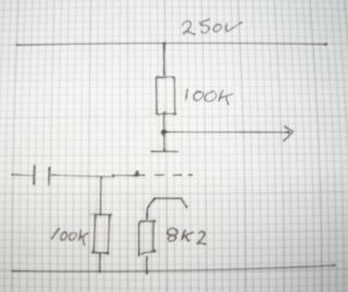

Thinking about something like this..
Perhaps a 5718..put another 100k in series with the supply and reduce the B+..140-150V??
However I'm not familiar with the micro phonics and the types. ie the "Best" one.. 😀

I assume you need that input cap because you have DC on your signal, but I do not understand the large unbiased cathode resister as well as the large plate load for a 12AU7 type. I trust you have heard 12AU7s in this circuit and like what you hear.
You should be able to plug a pair of 5977s into that circuit and get something that sounds as good as a 12AU7 in there. Remember a pair 5977s have half the filament requirement of a 12AU7 so you might want to adjust to suit.
One 6N16B will sub in as well but its filament demands are more than a 12AU7 so you will need to pay attention to that issue and see what your filament supply does.
If you want a line stage for audio I would think going with the data sheet suggestions for operating points would be a better place to start. For example, 6N16B, 100V on the plate, 325 ohm cathode resister, 6.5mA plate current, and a 30K plate resistor suggesting a B+ of 280V. For 5977, 100V plate voltage, 270 ohm cathode resister, 10mA plate current and a 20K plate resistor B+ of 300V needed. You would only need to change two resisters to adapt, given your 250V B+.
A smart tuned circuit topology impacts sound more than any special tube. Good luck.

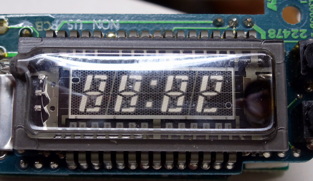

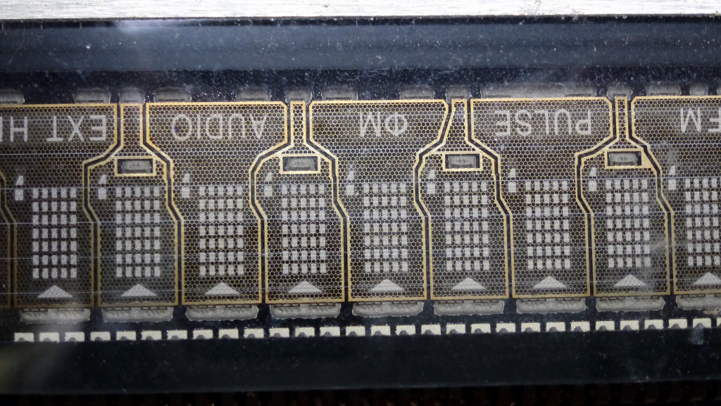

The first thing that comes to mind is the Korg Nutube, an offshoot of VFD display technology, Nutubes are small, low powered, and cool looking. The big drawback is cost. At $50 each in small quantities, 8 of these blows my entire project budget. I tested two used VFD's that I have, but they didn't work too well. The HP display turned out to be bad (gone to air) and two (out of two) of the clock displays could not be brought below 10% distortion.

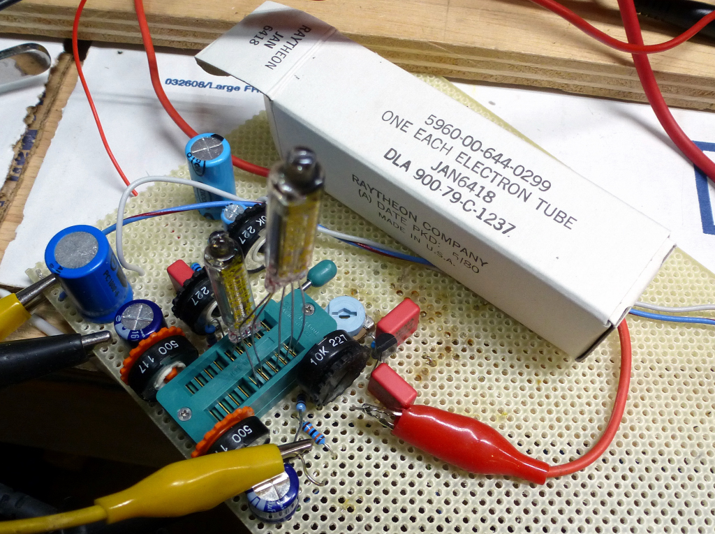

I decided to explore subminiature tubes, since I have a box full of them. Subminiature tubes come in two flavors:
Conventional indirectly heated triodes or pentodes that have been reduced in size, but don't save much power. The previously mentioned 6111, 6112 and 5840 are examples of these. Most have 8 pins or wires in a circle. They can be made to fit in the old 8 pin round IC sockets, or with some bending, an 8 pin DIP socket. Unfortunately each requires 6.3 volts at 150 mA or more for each heater. Roughly 1 watt minimum to light the heaters alone will not work in my applications, too bad, I have hundreds of several types.
Directly heated tubes intended for hearing aids or other miniature low power applications. Some run on very little power due to a tiny heater made of very thin tungsten wire, but are often microphonic because the thin wire will vibrate. Some can run on very low power. Most have 4, 5 or 6 pins or wires in a row on .050 inch centers. They will fit in a 0.10 inch machined pin strip socket, or two can go into a dip socket side by side.

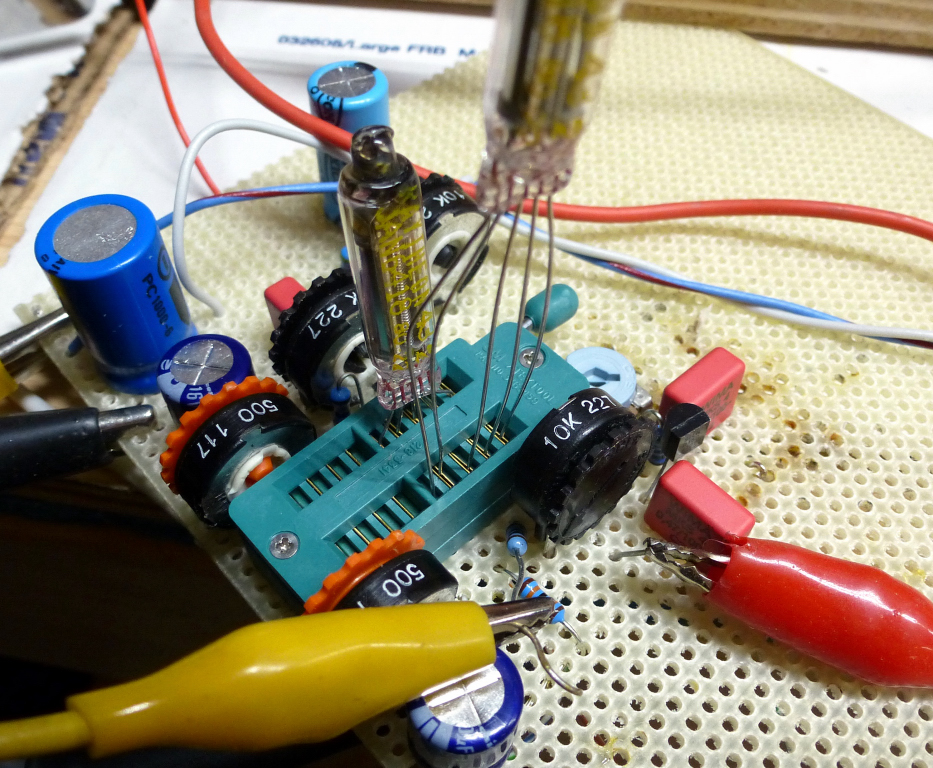

I made a test board to develop a gain stage that I will need for the projects that I am working on. I used a Textool ZIF socket originally used for programming 18 pin PIC chips. I used it to allow for testing a lot of tubes. I ran about 20 6418 tubes through the circuit several times, swapping them live without even turning off the power. I didn't blow any parts doing this. Some other tubes are on order to find the best compromise between gain, distortion, and power consumption. I made this breadboard such that EVERYTHING is adjustable, hence the collection of pots. I tweaked it for several possible operating conditions, then ran several tubes through it, finally choosing a good set for the 6418's. I will repeat for a few different tube choices after I get several of each kind.
The little breadboard that I built consumes 35 milliwatts for each gain stage (1 tube and 1 mosfet) total (heater and B+), with a 6418 tube. About 10 milliwatts is wasted in a simple filament bias scheme. This can be reclaimed if needed at the expense of circuit complexity. Total stage gain is variable from below unity to about 40 by adjusting the load impedance. Distortion can be optimized to a very low number. I saw less than 0.2% on one tube at 10 volts P-P output on a 60 volt supply with 30 volts on the plate at 400 uA. However tube to tube variation is huge, but I found a setting that allowed less than 1% on all tubes at 10 V P-P output.
