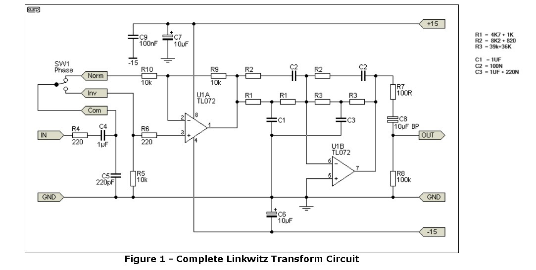

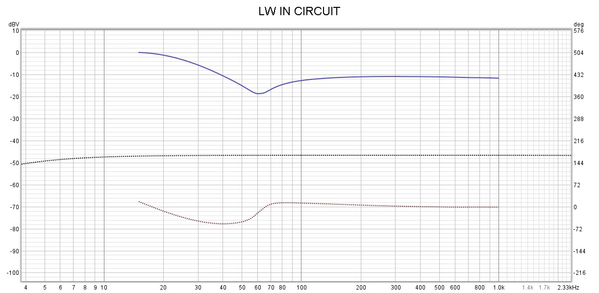

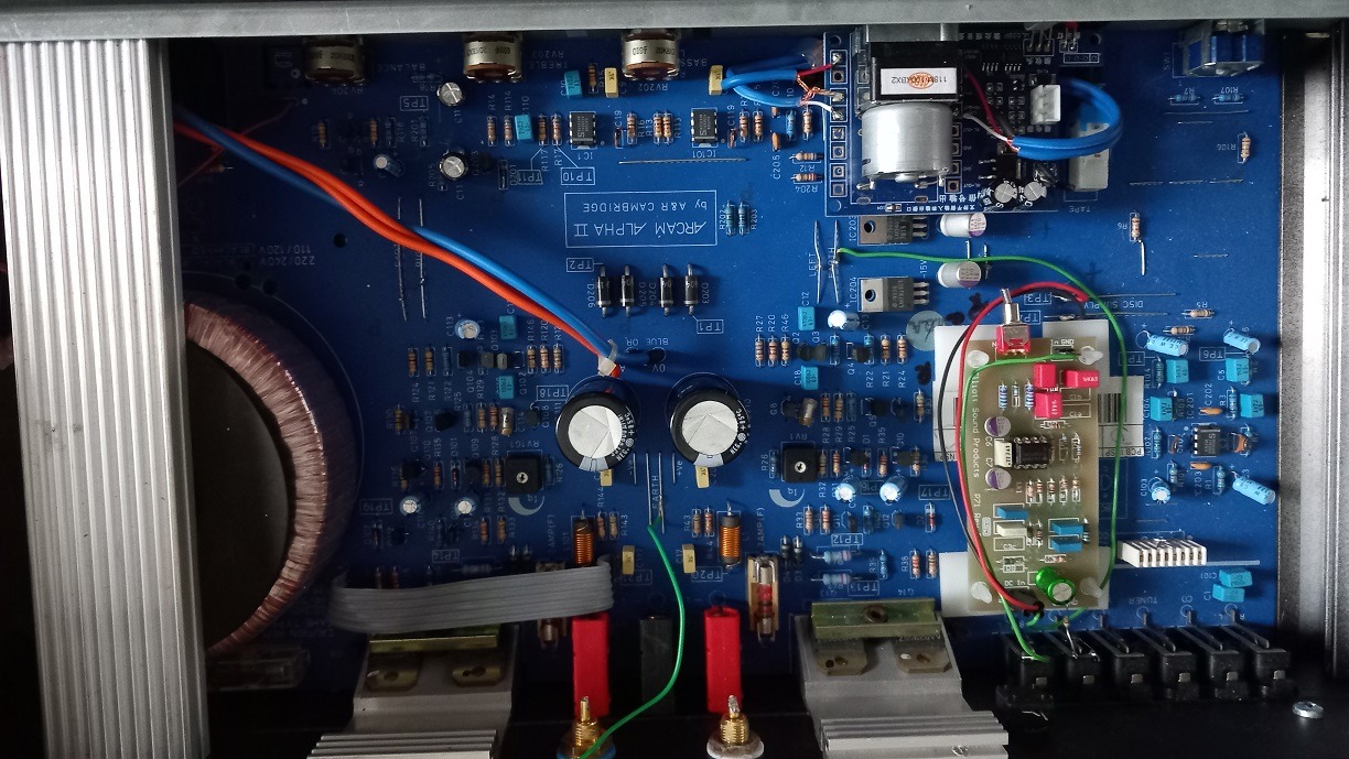

I built LW's Transform on a pcb from Rod Elliot (sound-au.com). Pcb no 71.
I used LW's values rather than rod's as these were a closer match for my subs.

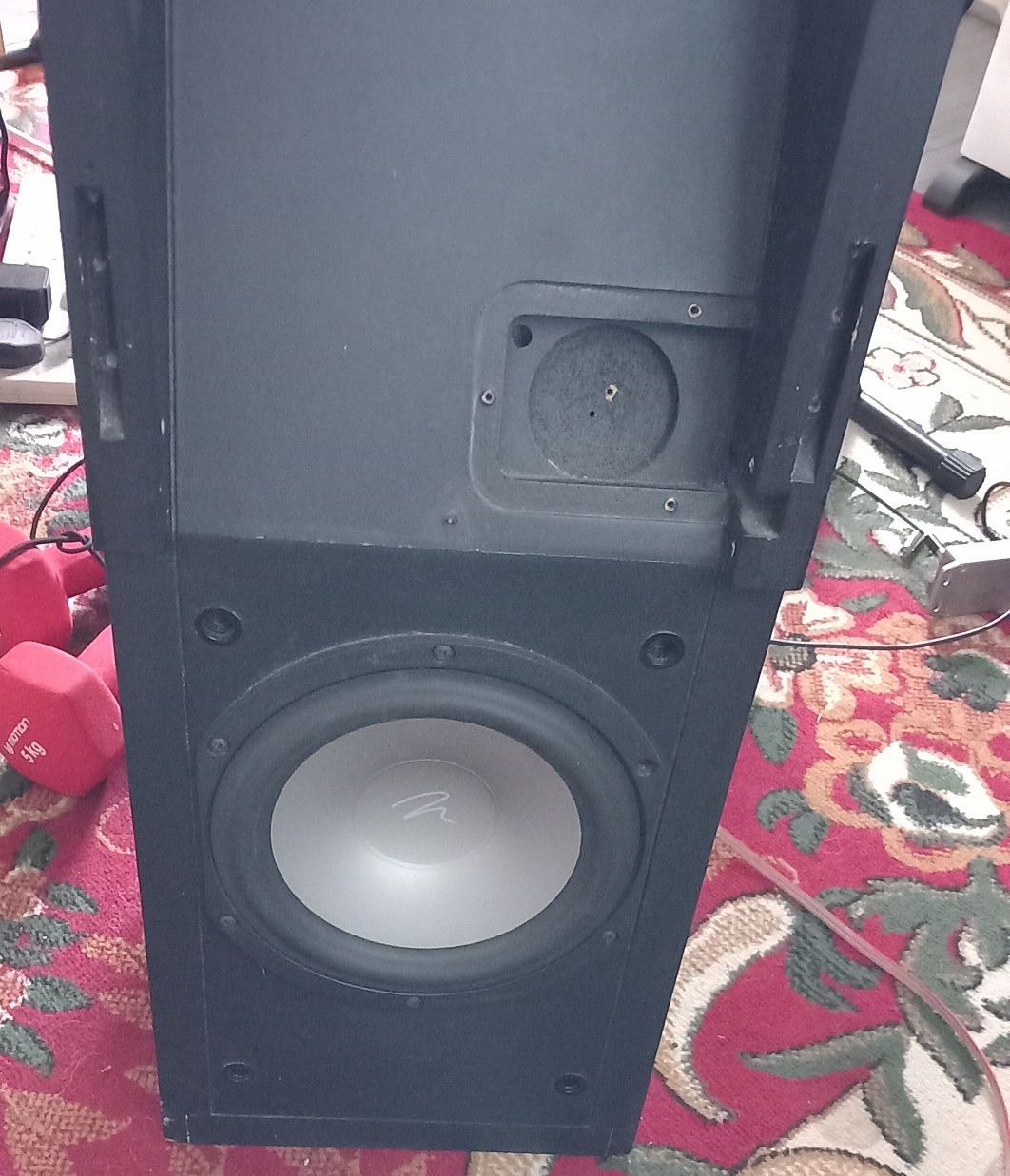

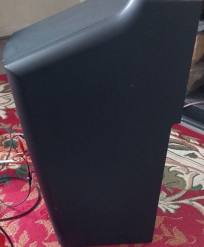

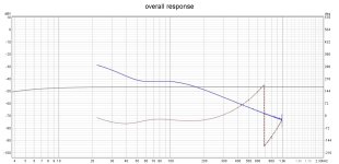

These are the lower closed box section of what were once, a pair of ML Aeon hybrid electrostatics. (I sold the worn out panels and crossovers on ebay).

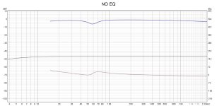

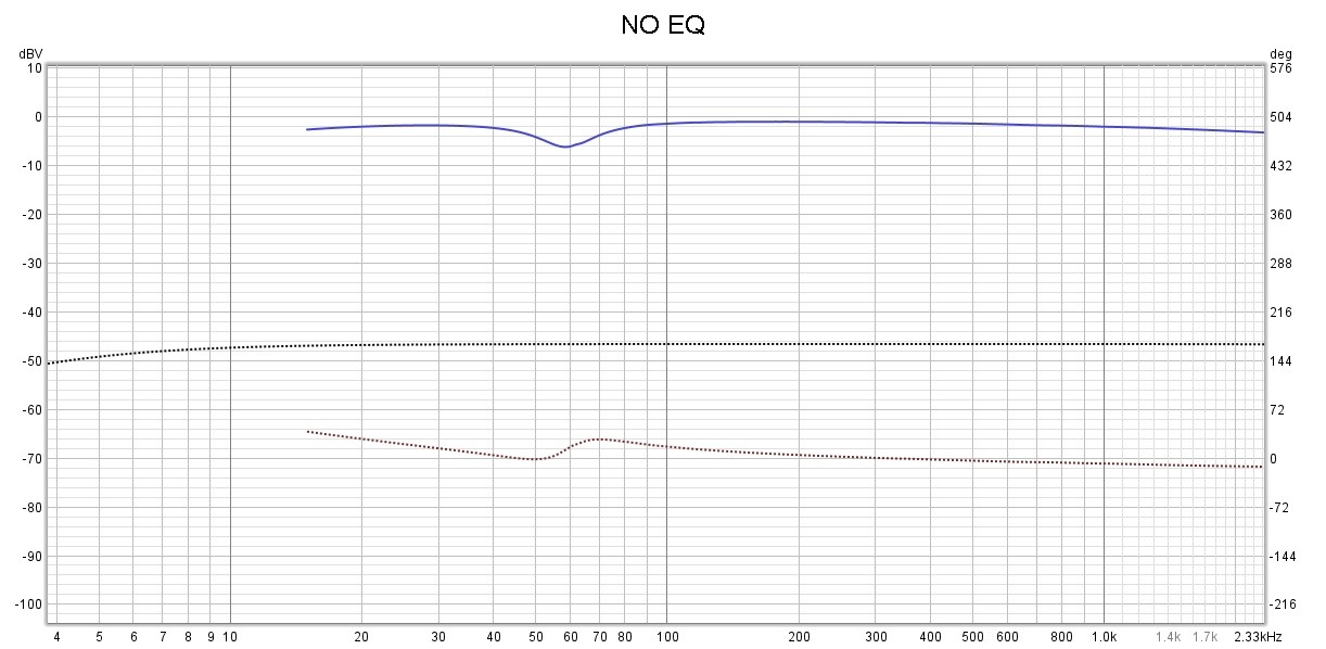

First chart is the ML response without any eq, second one is with the LW Transform in circuit. I installed it into an old Arcam Alpha IIs tape loop.
