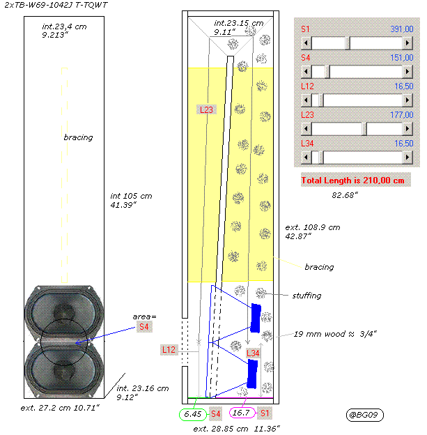

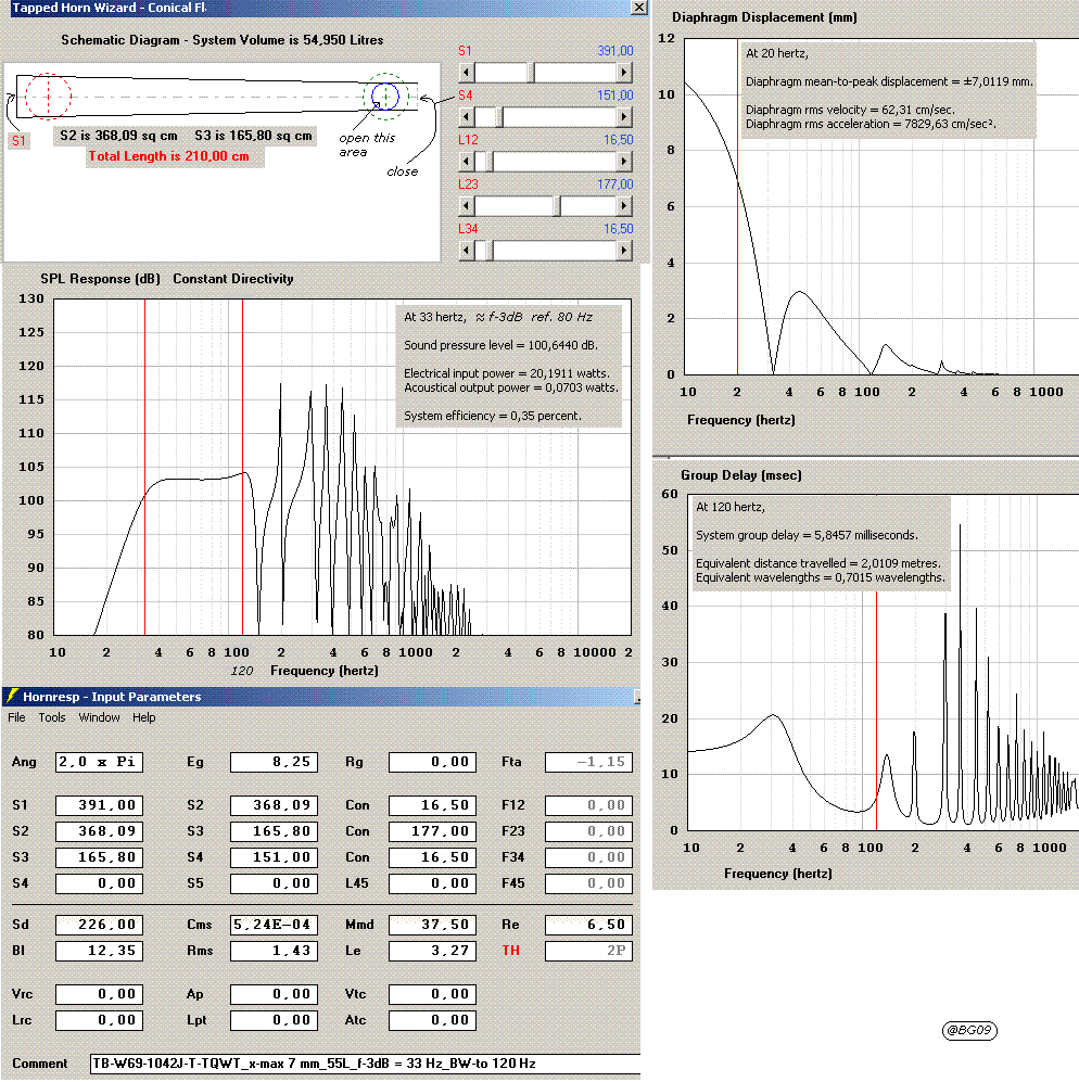

Don't know if the Tangband drivers in my suggestion are the right ones but as can be seen in the submitted pictures:
This T-TQWT can be XO:ed at 120 Hz and fulfills the requirement:
'Should go down to 30-40hz' and has a small footprint less than a sq.foot.
IMO: This sub delivers very good SQ and should '..keep pace with line arrays..' as any matching SPL would be set by using the volume knob of the required sub-amp.

Size is a huge factor here, since my room is damn small, and i've a pair of arrays in there, plus my PC workstation. So i'm really looking for sth under 2cuft. The T-TQWT, though having a small footprint, is too tall.

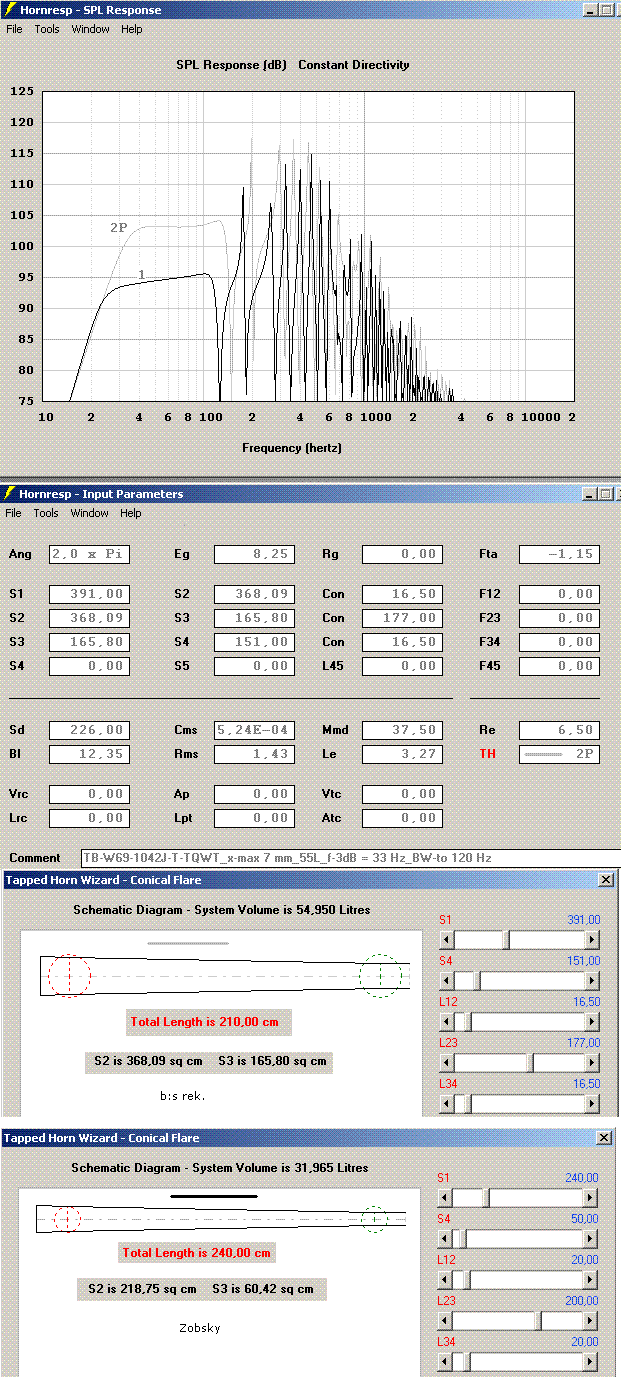

Hi Zobsky, Look at the picture where yours and the one I suggested Cacophonix
using the same driver input power level and space angle is shown.
..I think he wants something smaller, though (he has access to my drivers) . Need to brainwash him into believing that box subs are inferior 🙂..
😀 Agree, Box subs are not the :key:to SQ🙂
