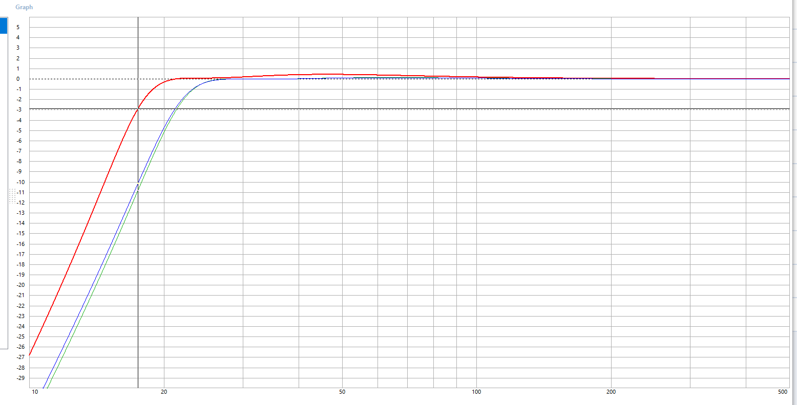

The available drivers are Alpine 12" with the following specs
I've simulated them in WinISD and got these curves:
Running environment:
The conclusions I arrived to were the following:
All 3 drivers in closed boxes will give a -3dB of 45Hz with pretty much the same curve. 20Hz will be at -16dB in all cases. I read about using room gain to take advantage of subwoofer rolloff. I'm all for using a small box but, is room gain predictable or reliable? Is it a curve or is it spikey depending on what's in the room and its layout, etc? I don't think it'll be very helpful if the room only gives me gains on a single frequency but the rest is the same.
I imagine it's always possible to tame down the excess bass with DSP, than trying to recreate it with DSP gain?
- Vented box will be required for low freq (of course)
- Series S will be the cheapest but requires a large box
- Series R will perform the same as an S in a much smaller box
- Series X will go much lower, in a box the same size as S
- What's the required SPL for "feeling" LFE channel? If I'm watching a movie and I want to feel the explosion on my chest, how many decibels is that?
- Do I want such a big-and-deep driver as the Series X which will go low , but will require a considerable box? Or will I get enough with a Series R that requires a fair bit smaller box and delivers very respectable -3dB of 21Hz in a 67L box?
- I suppose the answers to the second question is actuall the first: if the required SPL is enough for a R-series with more power I'm willing to sacrifice efficiency for space. I guess it's fine to run the driver at 100W instead of the larger and more expensive one at 50W to compensate, if the required SPL dB is reached?

Take this with somewhat of a grain of salt:I've simulated them in WinISD and got these curves:
- The simulations going to zero and flat above that indicates to me that WinISD must model things as electric filters. That's fine, thank you Dick Small (and Thiele and Benson!) however it is a limited simulation. A more sophisticated model with frequency dependent impedance would show rolloff above sometimes even 80 Hz for big heavy drivers with massive coils.
- And "0 dB" will not be the same for all those. It would be surreal if sensitivity was the same for all those. And I don't mean the specification from Alpine or whoever, I mean plugging into the actual equation.* Then you'd have to offset each curve accordingly. The sensitivity spec is a MIDRANGE value which doesn't necessarily have anything to do with the bass sensitivity.
- Room gain can very above the lowest frequencies...at the lowest it depends on cubic volume of the room according to some formula I cannot remember for the life of me. That presumes though that the room walls and doors are all sealed and solid. I would want none of those responses-I'd want something that would "droop" more that is move down the tuning so the LF rolloff will begin higher but more slowly.
