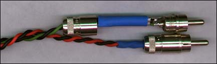

Hi again all...I'm tapping into factory RCA outs from the head unit for my new amp, which are unfortunately in a harness instead of a plug (for OEM woofer amps). The factory wiring is woofer +, woofer -, woofer shield. Obviously the + goes to the center conductor, but where do the - and/or shield go?

If you had a pair of shielded TP(twisted-pair) or differential, you would tie the ground to the outer conductor. With regular RCAs, you can just tie the ground to the shield and the shield to the shield.
I should clarify: I made something like this:
The factory wiring uses pre-outs from the HU but they are just wires that run into a harness rather than RCAs. I tapped into the + and - for my cables, and it works but A) it's very noisy (cd changer sounds amplified, bad squelch on turn-off) and B) I think the voltage is lower than it should be since I have to turn the gain all the way up to match the other speakers. I also connected the shield wires to the RCA plug shields, but it made no difference.

Make sure that both the HU and the CD changer have local grounds. since you have noise in your system, I would bet that you have a ground-loop. They may have been using the shield to ground your equipment before.
Hmmmm...the cd changer is in the HU. I always thought ground loops involved alternator noise, but this is the player reading discs heard thru the speaker. I think the pre-outs are definitely not grounded/shielded right, but I'm not sure how to go about it. I'm only hearing the noise thru the woofers (only thing connected to the amp), so I doubt it's the whole HU that's not grounded, but maybe...
If you use a ground loop isolator (on the preamp side of the amp) or a Line Output Converter on the speaker side of the amp, you will break the ground loop.
Ground loop isolators have transformers that pass the AC but break the DC path that's giving you the noise. Most all LOCs have transformers and also break the ground loop. If you get an LOC that has 'ground' wires (often brown), you will have to experiment with their ground connection point. Some amplifiers can operate with the ground wires left unconnected but some amps oscillate or have other problems if they are not grounded.

So are your woofers amplified separately? If so, that is where the ground-loop is happening.
Ground-loops are caused by dissimilar potentials between grounds. This causes current to flow through alternate paths. Usually this happens with amplifiers that have poor ground connections and are grounded through the RCA shields.

Be careful what you do with the speaker negative from the woofer amp, it's probably not at ground potential -- from what I understand, a LOT of car audio gear runs in bridge mode, due to the fact that it's hard to get decent supply voltages. (Disregard this pargraph if this is a question about the inputs).
If this were MY car, the first thing I'd try is running the woofer through shielded twisted pair -- + to RCA tip, - to RCA outside, shield connected at a one end and left hanging at the other. The hanging end can be connected back to the car's ground through a small ceramic non-polarized capacitor (100pF?) to kill radio noise.

I would strongly recommend against using a isolator. The people that sell these are like the same people that sell dehydrated water to parched people. The underlying problem still remains, you are just "masking" it. Fix the problem, where it originates, and not only will your equipment be happier, you will also sleep better at night knowing your fixed it instead of covering it up.

On a system where a standard head unit is driving a standard amplifier input circuit, an isolator is generally a bad idea but sometimes they are required especially if two different input circuits are fighting each other. I know of at least 2 very well known brands that pass a small biasing current (for the input circuits) through the shields of the RCAs. This type of input circuit can cause problems for other amplifiers. In those situations, an isolator is sometimes the only solution.
In his situation, there may well be ~5 volts of DC on both of the signal lines going to the OEM amplifier. Some OEM head units don't have DC blocking capacitors on the output signal and the 1/2 regulated power supply biasing could be on both of the signal leads. If this is the case, he's trying to feed that 5 volts into the signal ground of the amplifier. The isolator will block the DC. It will also create a signal that's free of ground loops. Noise may still be present since the the shield ground of the amp's input circuit may be floating. To correct this, you could ground the RCA shield input to the amplifier at the amplifier.
The isolator should be connected to the two signal leads of the OEM signal lines. There will be no connection to any shield wires of the OEM signal lines. The output of the isolator will go to the amp. Try grounding the shield ground at the amp (where the isolator plugs into the amp). I would suggest making the connection with the amplifier off.
