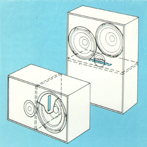

Just a quick one, what's the best stuffing to go from adiabatic to isothermal compression? It's for a second chamber of an aperiodic enclosure, so sound absorbing is of no importance. I just presume high specific heat, high density and high thermal conductivity would be desirable. Would copper wire ( screening from old coax? ) have any worthwhile advantage over polyester?
perhaps...
