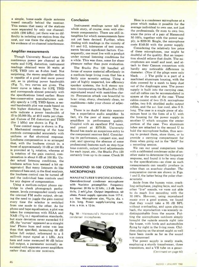

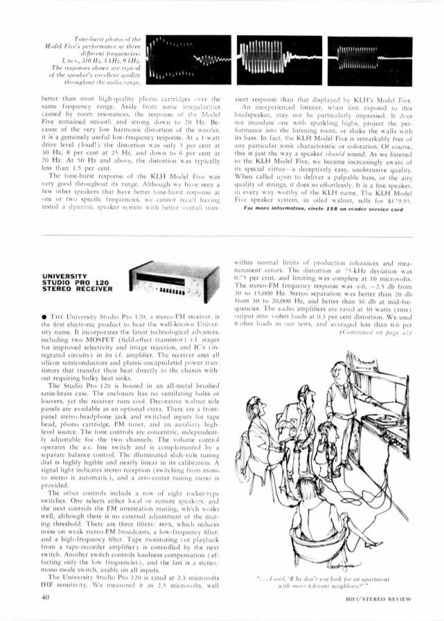

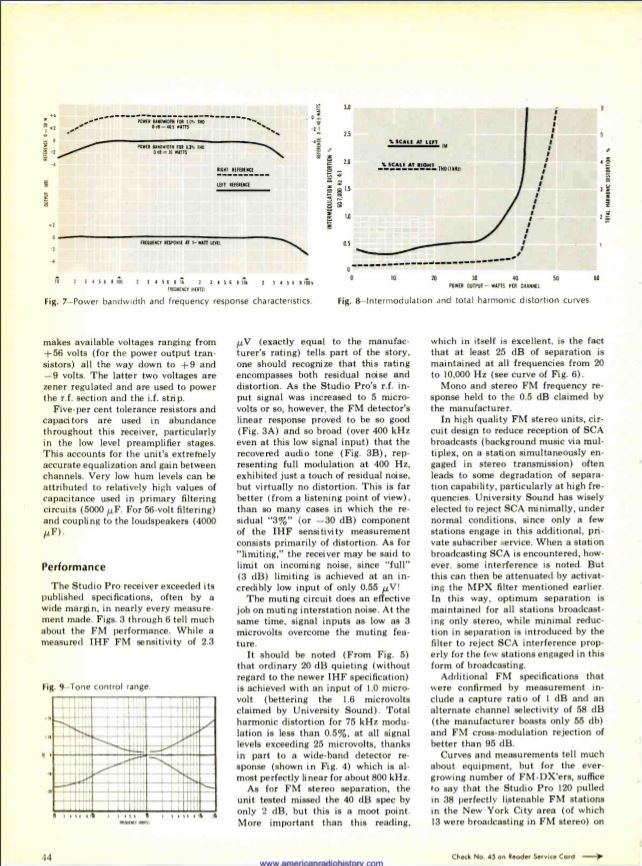

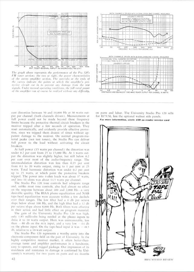

In my postings which will follow (below) are scans of some reviews, advertisements and a Studio Pro 120A sales brochure. A number of these advertisements appeared in a variety of magazines. I have chosen the best of each one that I could find.
Credit must be given to David Gleason, the owner of worldradiohistory.com (formerly americanradiohistory.com) for the majority of the magazine scans as well as Roger Russells website: roger-russell.com for the McIntosh photos.
Here are some University Sound "Studio Pro 120" advertisements which appeared between 12/1967-12/1968.
As well as some University Sound "Studio Pro 120A" related ads which appeared in 1969.
