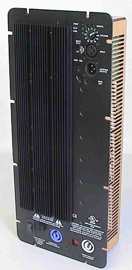

I think the following is quite feasible for DIY. I would submit as an idea for your consideration a near-field monitor with two CSS FR 4.5" drivers in a sealed enclosure, driven by four chipamps, two each bridged for the upper and lower end. Crossover would be active, OR passive. Currently I have this combination running actively bi-amped with X-over around 196Hz (via Behringer DCX), which will also compensate for the small baffle such an enclosure would have (BSC). Result: pin-point imagining with less distortions on the bottom end due to driver doubling. I suppose one would call this a 1.5 way? 😀
I still think that perhaps one of the new SPEAKERPOWER digital modules would work brilliantly for this kind of application. I am looking at a Bi-amp powerpack with 250W/250W (see pix). But I do not know whether these are available for the DIY community.
