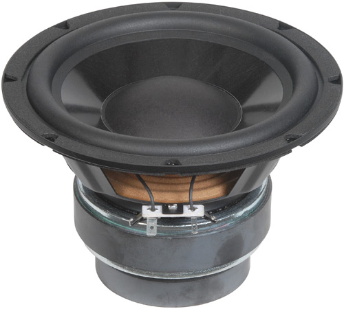

Im in a position to buy some studio monitors under $1k Aud ..
Options are pretty much - Alesis Mk1 6" / KRK RP5 or RP6 or Yamaha HS80M
Is it possible to build something as good or better than these powered monitors for similar pricing?
or am i wasting my time as i guess amplifier cost might drive the diy option through the 1k limit.
I have no problems building boxes etc, not interested in building an amplifer so that would be a purchased item.
Any opinions or gear options would be greatful.

Building a powered monitor for under $1K is difficult, but building a passive speaker and powering it with a separate amp is easier.
The main difficulty that I'm finding is sourcing a decent 50Wx2 (or better) plate amplifier to whack on the back of the speaker.
If you're interested in the passive route, there are a handful of speakers that I could recommend that would beat the entry level monitors like Alesis/KRK hands down...

I am building a passive speaker now for $700 worth of parts plus cabinet. But learning to build takes some time if you design yourself. If you build speakers from Zalph, Troel, or Tony Gee is quicker and easier.
I am sure it will beat any off the shelf speakers worth $1K. $1K speakers in Australia is not really top notch, ie monitor class.

When my mid/woofers needed to be replaced, I found buying ScanSpeaks with shipping was only a little less than buying the originals from ProAc. ProAc also said the mid/woofers were made to their spec so this was a no brainer but the tweeter is the original ScanSpeak. You can make your own PCBs for the crossovers and acquire the correct components and wiring yourself to keep that cost down and make your own cabinets!
I bet you could do it for $750. With the amp, $1K is do-able with very nice results!

To spend $1,000 I suggest you look seriously at one of the projects by Zalph, Troel, or Tony Gee, you will get monitor class or near monitor class quality full stop.
Also parts in Australia are expensive, if you decide on 2 or 3-way projects try drivers from scanspeaks(expensive), you will very happy with them. I use scanspeak clone drivers(usher drivers) they sound very good already, and if you use scanspeak, it would be even better. $1,000 well spent. The speakers will last for many years to come.

Building DIY speakers is much like cooking. If you've never cooked you can create a horrible meal using even the finest gourmet ingredients. If you are a chef, you could create several tasty meals with only left overs in the kitchen.
So for now I would advise against spendy big sums on premium European made parts, but instead finding a good recipe (design) that will suit your needs.
Please tell me more about your intended usage. Is this for a small project studio in a house, or dedicated studio. Is it for personal use or a commercial client? What kind of music will they be monitoring primarily
For the speakers, what are your size, placement, SPL and bass requirements?

I use "Polk audio monitor 10b's" for monitoring. Came from an op shop . Cost me $80 the pair. They are reasonably flat right down to about 45 hz. Check out eBay for something similar. I have found from 8 years of music production monitors aren't the world i have owned alesis mk2's and found my $80 finds to be just as good!
Unless you are knoledgable and experienced in speaker design, either buy something or build a known design. Several designers have been suggested earleir.
A better option is simply to buy something secondhand. Check ebay etc then research the ones you find.
Most of the 'monitors' I've heard sound dire at best and my old KEF's kill them.
A final option is a really good set of headphones and a dedicated driver for them. Apart from soundstaging, which is fairly irrelevant in multitracked near miked recordings, they will give you far more insight into what you're recording than anything else, until you spend heaps of money.

Its just for my personal home studio.
Im producing mainly psytrance/electronica, so clear responsive bass is fairly important, as is the rest of the range.
Using PC with a firewire outboard soundcard in a room about W 4.5m x L 4m x 3m H thats carpeted.
At the moment im using some old 4" full range in closed boxes with an old marantz sr140 amp thats seen better days, all this is sitting on a desk nearfield of me. so something similar would be nice, but not necessary as i can change the room around how i like.

There are a range of DIY speakers built for domestic "hi-fi" that may be suitable for your intended use.
However, the main concern is that most speakers designed by hobbyist serious about hi-fi is that that crossover design is suited mainly for free-standing placement, even if placed in relatively small rooms.
When placed near walls, or on a desk, tonality can change.
There are variety of designs with reduced baffle-step compensation to suit. I will check and get back to you...

The Zaph Audio SR71 is a moderately priced DIY-design that can be built from the ground up, or purchased as a ready-to-assemble kit.
http://www.zaphaudio.com/SR71.html
Is is a good idea to have monitors clear of walls/ground planes etc, so having them on small stands is the idea, instead of sitting directly on your desk.
If you do decide to place them directly on your desk, imaging will suffer, and you may find the bass is a bit heavy handed.
In that case, there are a couple of approaches to modifying the crossover for reducing the baffle step compensation.
