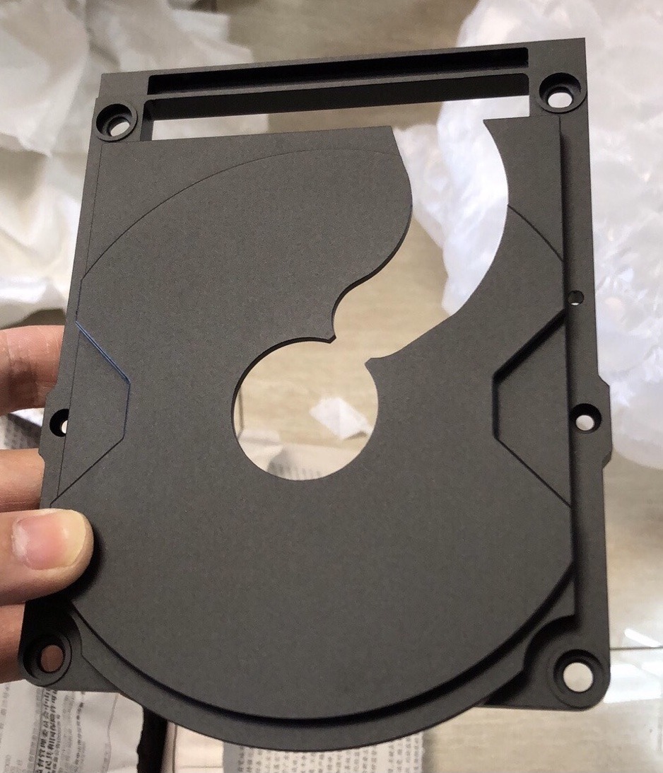

Hi, I need the plastic tray of Studer D730 because mine one is broken . I searched and searched , but I'm not a Pro , not sure where to look . Can any good man help with some idea / info where can I find black plastic CD tray for my much loved Studer D 730 ? Thank you ! Ana Meola :xeye:

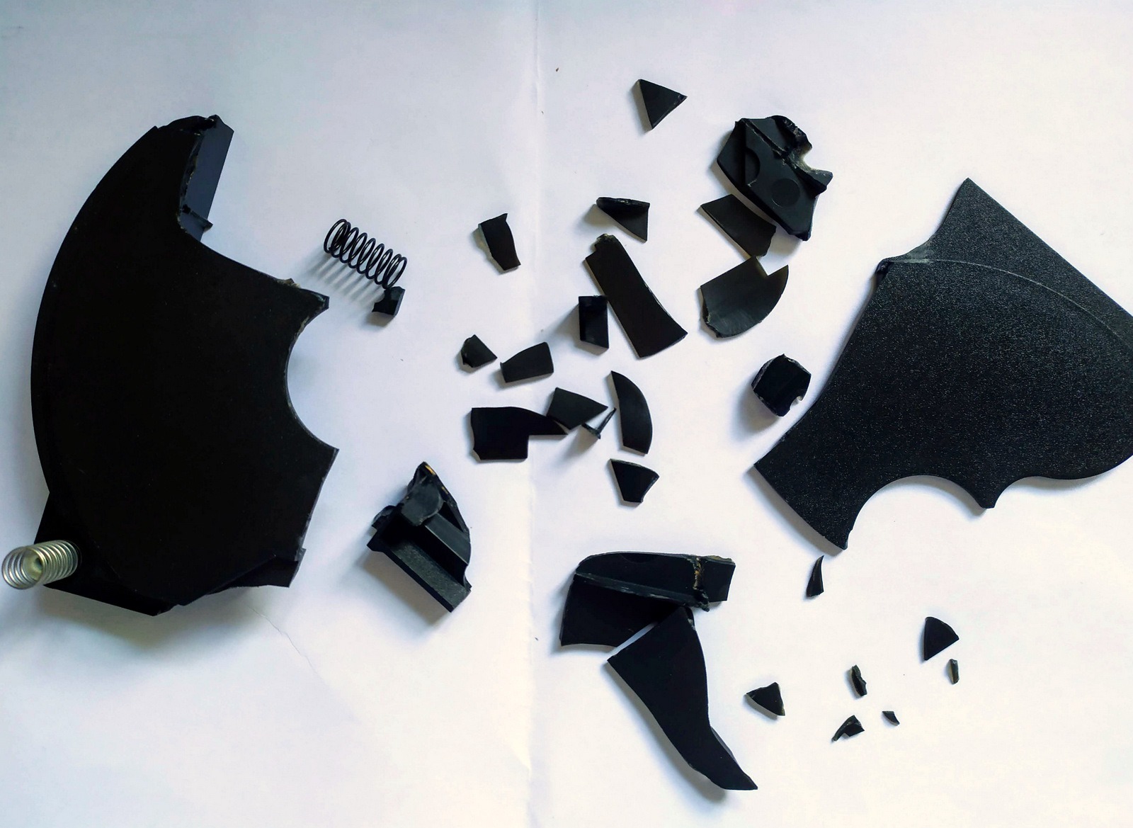

Well......some 10 years later my suggestion is the same......can you glue it back together? A picture of the tray could tell us if this is likely to be possible.

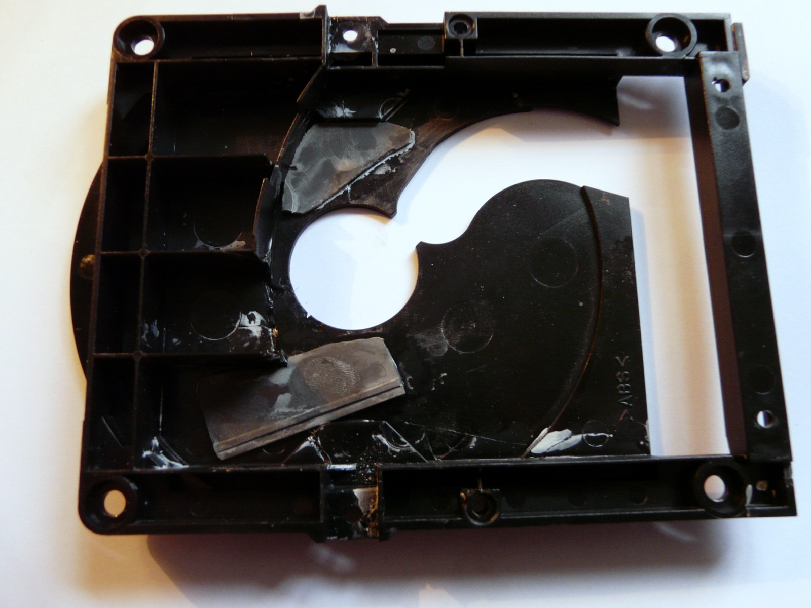

Been there, done that 🙂
Player was poorly packed and mechanism wasn't locked. As a result, tray exploded... I had to reinforce an area from the underside with a bit of plastic (3rd photo)

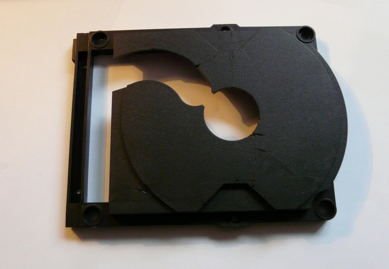

I am attaching photo of broken tray.
Do you think that I can glue it back & manage?

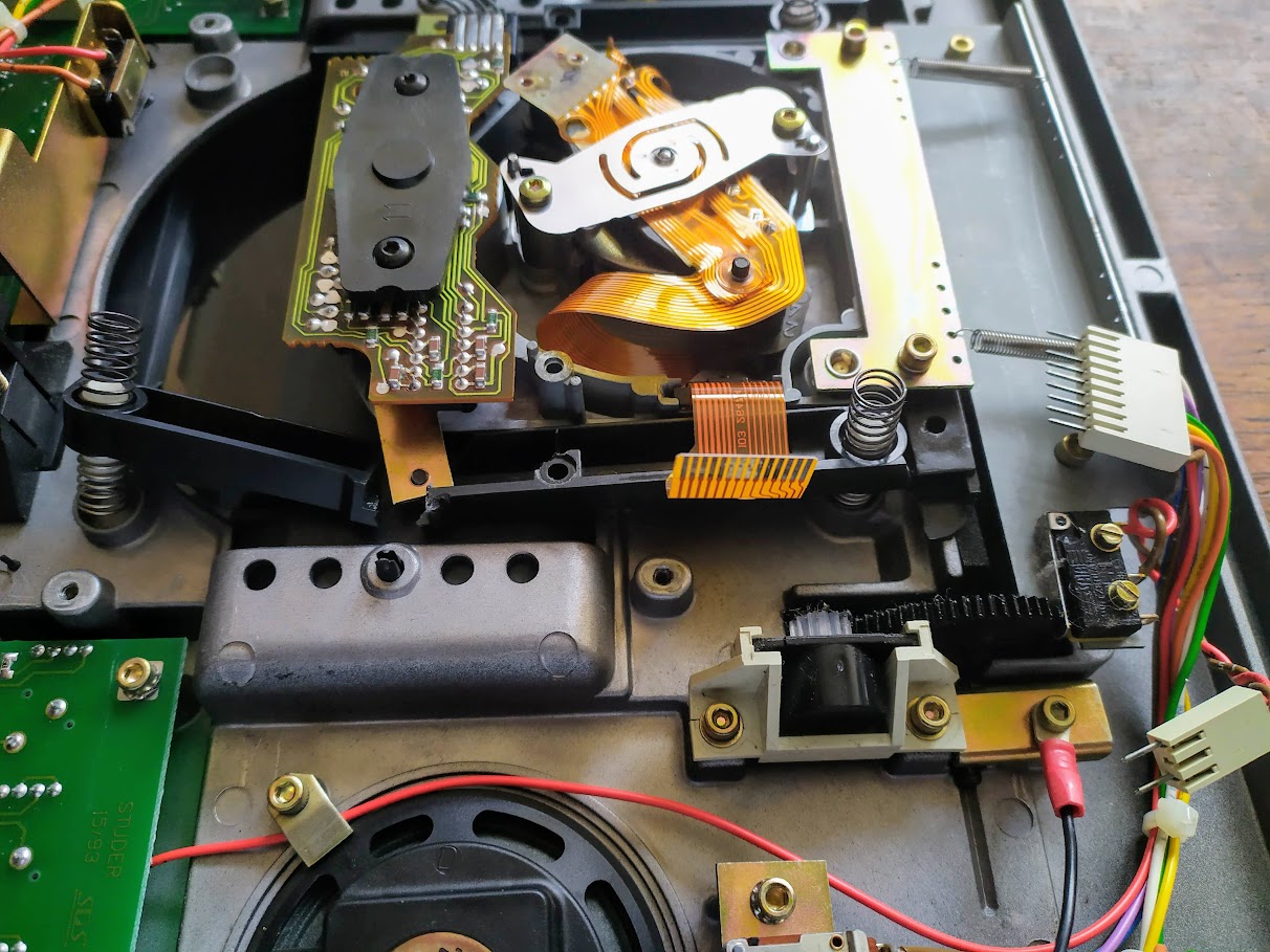

Sorry for my ignorance, how do I remove this broken tray? I can open/access it from top or I need to open the machine?

Compared to what I had to deal with, this is a very easy one.

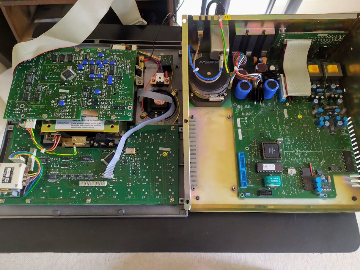

It's not accessible from top, you have to open the player and dismantle completely the drive mechanism to remove the tray. You should get the Service Manual.

You can purchase original STUDER D730 plastic tray form AUDIOHOUSE in Switzerland.
Part number for plastic tray 1.630.110.03 Price : 25.00 CHF Swiss Franc
SITE: https://www.audiohouse.ch....Contact: MARCEL CATTANI
Replacing the tray takes some skill to transplant the 4 rubber grommets form the broken tray
