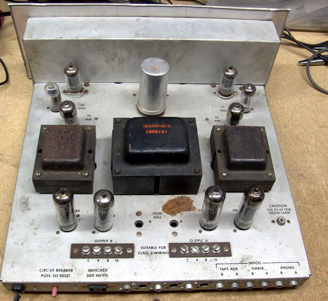

I've had this amp sitting in my basement for about ten years and have decided to put it to use. It looks like everything is original including the S-C tubes. The schematic is conveniently glued to the inside of the bottom cover and is in great shape.
I'd like to use it and possibly restore it but have no idea what to expect. I've read on-line that it's not a good idea to power-up an old tube amp that has been sitting around for a long time.
I know nothing about electronics but am handy with a soldering gun. I replaced the PCB of my Dynaco ST-70 and also did a Curcio mod to my Dyna Pas-3 but that's the extent of my experience.
Any suggestions would be greatly appreciated.

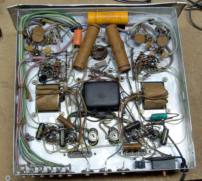

It's a well-regarded amp. The coupling capacitors probably are leaky, electrolytics are dried out. The circuit breaker will fall apart if you look at it cross-eyed (I've replaced with a clip type fuseholder underneath - it's tight but I insulated it with Nomex).
If you want to power it up first... put a 100W light bulb in series to limit the current. ANY positive voltage on a grid pin is a sign of a leaky cap, certain death to an output tube...
The big can cap may measure good, but I wouldn't leave the room with it running if it hasn't been replaced. You can disconnect it, leave it in place and put separate caps on a terminal strip underneath.

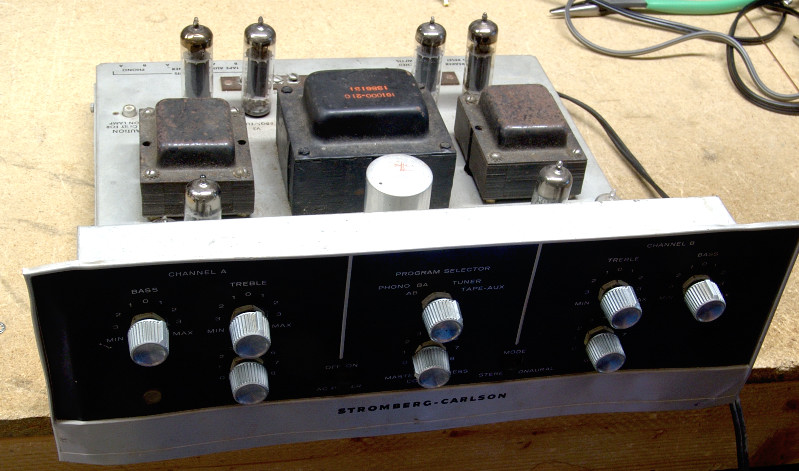

I went over to my warehouse today to look for something that I could use for as a chassis for quickly building a Simple P-P amplifier. I found a Stromberg Carlson amplifier with no model number. It had places for 10 tubes, but only 3 tubes were present. The output tubes (all missing) were 6BQ5's so the iron would likely be good for a Simple P-P build. I remember dragging this home from a hamfest at least 10 years ago and probably never hooked it up. I brought it home with the idea of using the chassis and iron.
I removed the bottom cover and found the schematic and the model number ASR-333. I remembered this thread because of the model numbers similarity to an old Teletype that I used to own (ASR-33). After visiting Toms web page it became obvious that this was an ASR-333 but someone had added a magnetic phono preamp. I don't know if they copied the ASR-433 design or not. Some capacitors have been added in parallel with the can cap. One looks as old as the amp (an old Sprague Atom) but the other is much newer, so it may have been worked on 2 or 3 times. All other components and circuitry is original (including the coupling caps). The next thing that became obvious is that this amp uses a solid state voltage doubler so the power transformer would not be compatible with the Simple P-P which uses a 5AR4. I have plenty of OPT's so it doesn't make since to part this amp out for its iron to build a Simple P-P.
OK, what do I do with it? Well the answer to that question may become clear if I had a better idea of the amps condition. If the power transformer was toast, I would have no problem gutting the whole thing and using the chassis.
Since this amp had no special meaning to me, and I am inherently impatient, I decided to do exactly what you shouldn't do, just plug it in. Leaky coupling caps (usually the case) will make life short and unpleasant for the output tubes, so I dug up some junk tubes. 4 different tubes made in 4 different countries. Yeah these are a matched quad, honest! I had no idea what to put in the unmarked socket for the added phono stage, so I popped in a pair of 12AX7's.
I was convinced that there would be some smoke, maybe some guts spewing from the electrolytics, or at least a bright red glow, but nothing, no smoke, bang, or fizzle. OK, hook up some speakers and try again. Maybe there will be a loud hum or some snap crackle pop. Nope, just a faint hum. Could this thing actually work? I connected up a CD player, put in a CD, and......YES, it does work, It isn't even distorted. The controls work even the tone controls. I played a few tracks through it and decided that it sounded pretty good, but isn't a Simple P-P, but then my Simple P-P's are made with all new parts and use much bigger OPT's and good tubes. I decided to hook up my turntable. OK, I found something wrong. The phono stage works, but there is some hum and the amp motorboats if the volume and the bass controls are advanced to nearly full. Even in this condition I played a 10 minute track from an Al DiMeola record and it was listenable. After almost an hour of listening the can cap became quite warm. This is bad, very bad. Experience has shown me that it will explode if not replaced. These do not vent, they go bang. The cap is bad, and is possibly the reason for the motorboating.
OK, so now what? I can't justify killing off a working amp just for the chassis. I don't need any more amps since I can't use all of the ones that I have made. Does this amp have a warm place in someones heart, does someone out there jest have to own it. If so email me. If I don't get any interest I will probably list it on Ebay next month. As noted the can cap needs to be replaced or eliminated and the power cord has some bare spots. The front panel is also bent.
