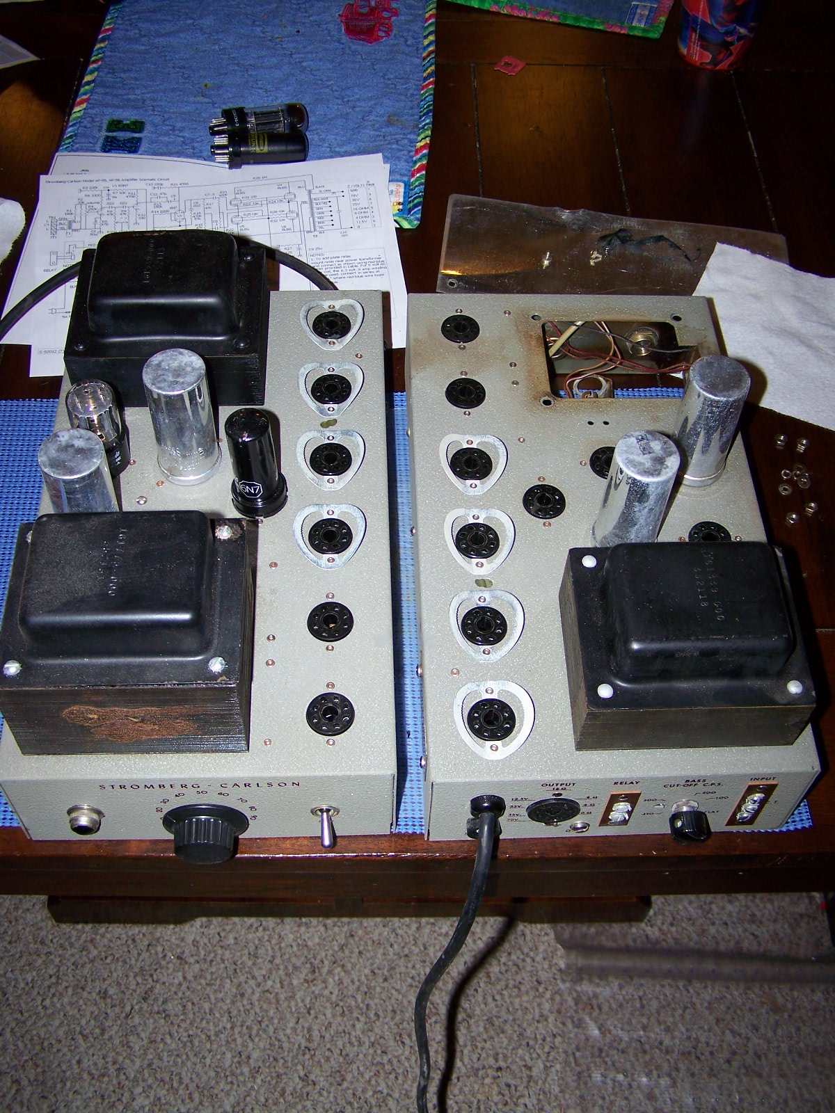

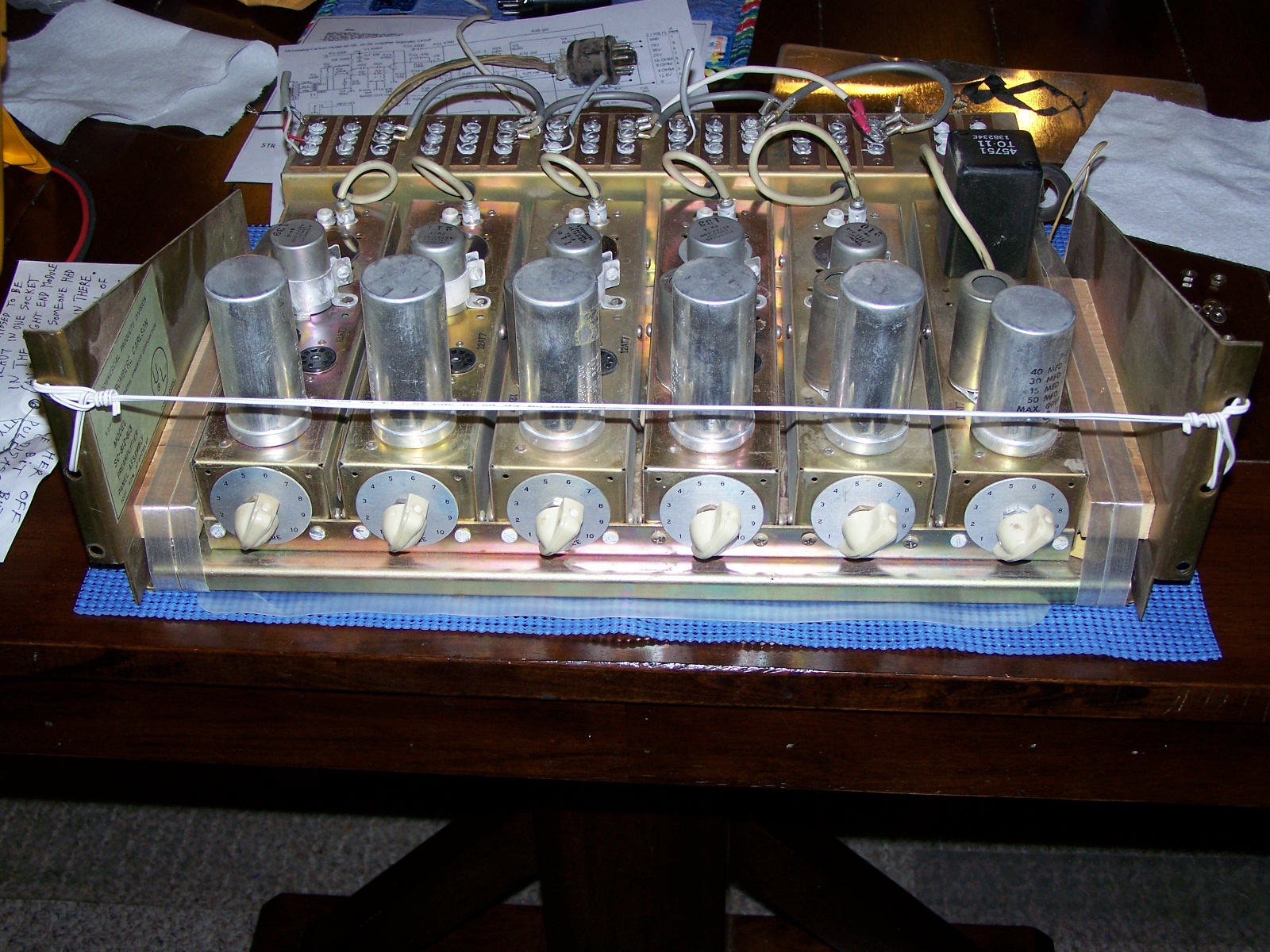

I have come in to possession of two SC AP-55's and the matching 6ch preamp.
They were an absolute steal at $60 for the set.
There is an unknown problem with both amps but the explanation makes no sense.
Evidently something bad happened and it fried the power transformers.
That is about all of an explanation I got.
I will start by Ohming out the PT and hope for no shorts or opens.
I have a schematic and I'm hoping for the best.

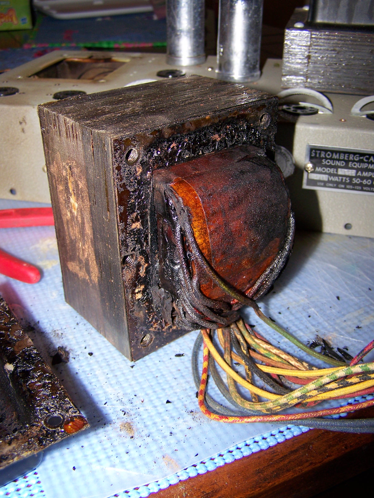

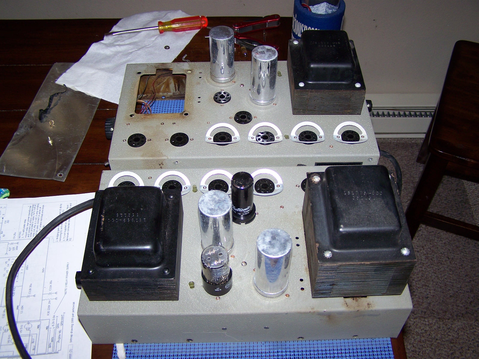

Fried Power Trannies?
NOW, I have seen my fair share of fried things in my life but !HOLY CRAPPP!
This is totally crispy.
I take it this is not common for even 60yr old power trannies to look like this.
Looks like new trannies are in order huh?
The next question is what would cause both power amps to have the same problem at the same time.
They were pulled from service as a pair.
They stink bad, I have not completely finished all the cross short testing yet.
I pulled it from the chassis to make testing easier and I figured I would pull the endbells while I was at it.
They came off really easy for being so old.

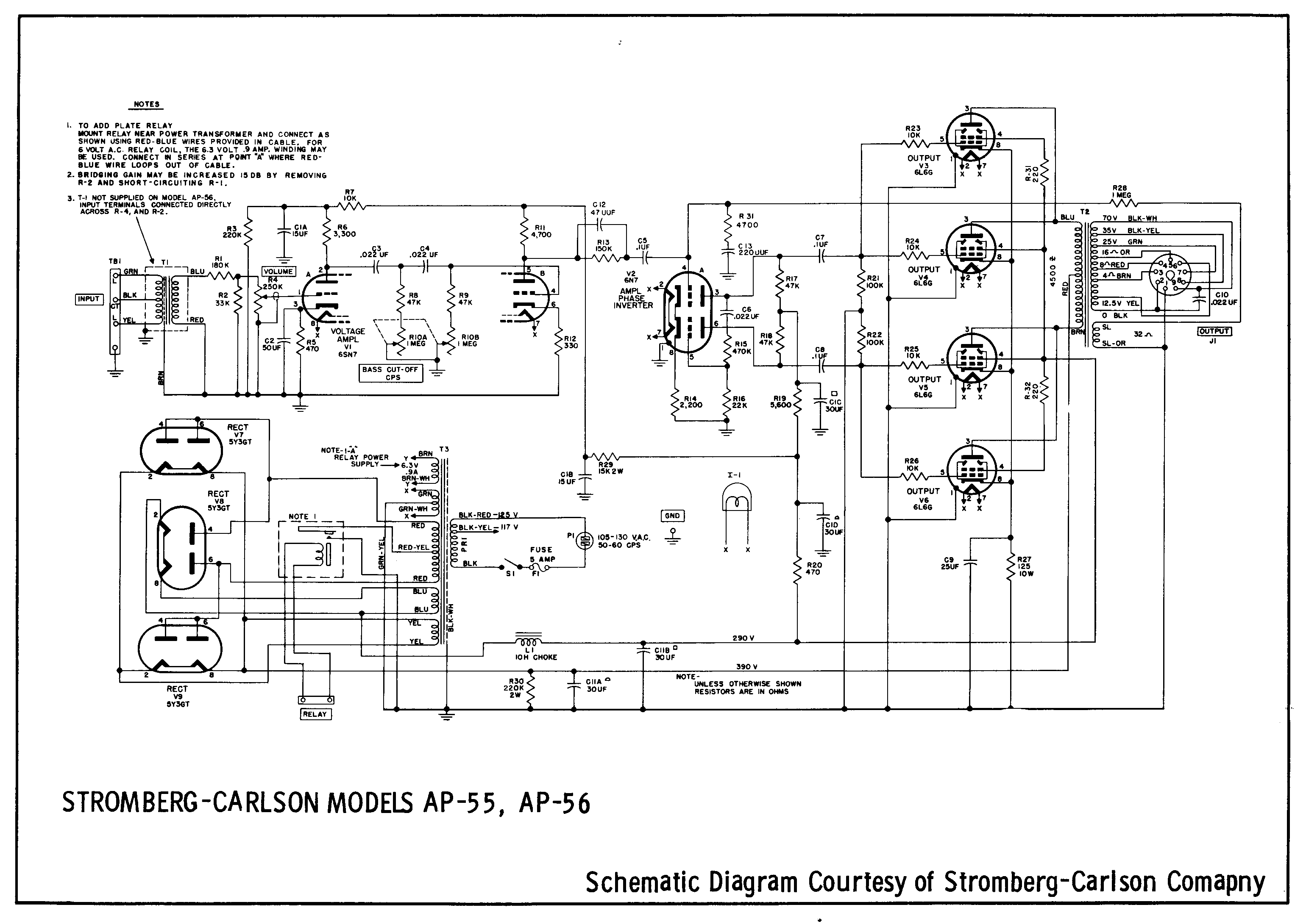

The AP-55 schematic is interesting. Notice 3X 125 mA. 5Y3 rectifiers, 2 of which feed a cap I/P filtered 390 V. rail and the 3rd feeds a 290 V. choke I/P filtered rail.
If you SS rectify the B+ voltages, the $38.50 AnTek AS-2T300 looks like a suitable replacement for the "fried" power "iron".

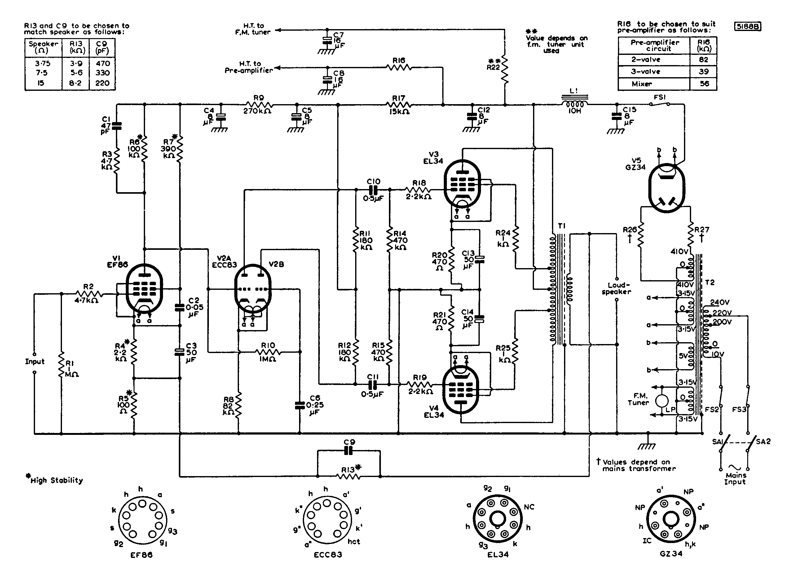

No matter how you twist and turn, a lot of work has to be done in bringing those monoblocks up to a high performing level. I suggest you consider Mullard 5-20 style circuitry (schematic attached), using a 6SJ7 as the voltage amplifier and a 6N7 as the long tailed pair phase splitter. Use a 10M45S CCS in the LTP's tail, instead of a resistor.

Oz series rectifiers are high failure parts, IMHO. I wouldn't put one back. If there is a selenium rectifier in the FM stage not shown running off the 15v , It also could have taken out the power transformer. Selenium was about a 10000 hour part - I caught mine just as they were getting leaky at 9 years of age, before they damaged anything. I put new selenium rectifiers in (no internet in those days) about 10 years they needed replacing again. The counter salesman told me I didn't want selenium, but he didn't explain how to buy cinch terminal strips to mount silicon diodes using screws. I had to figure that out by myself. I didn't want diodes connected to wires flying in the air in a big ball of electrical tape.
I might look into a set of Toroids to get the HV, 6.3V & 5V I need.
I don't think you will find off the shelf toroids with 5 VAC rectifier windings. SS rectify the B+ and use the Antek toroid I linked. The 5Y3 is directly heated and starts almost as fast as SS diodes start.

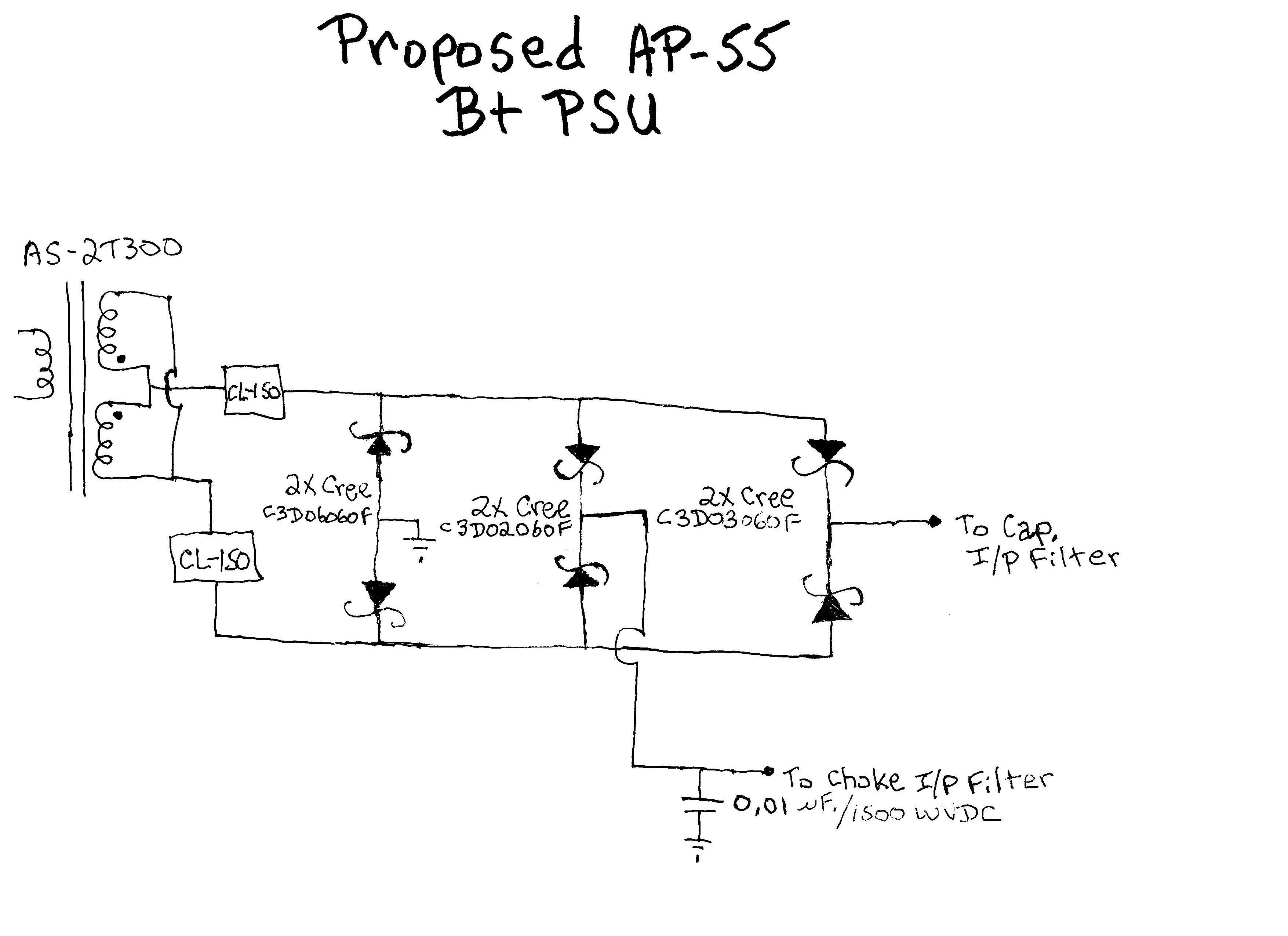

Forget vacuum rectification! It's easy enough to phase up the paired B+ windings on an AS-2T300 and bridge rectify with 600 PIV Schottky diodes. Use 5 A. diodes on the ground side of the bridge and combos of 3 A. and 2 A. parts on the "hot" side of the bridge. Doing so follows the OEM pattern and allows for a cap. I/P filtered and a choke I/P filtered rail. A couple of CL-150 inrush current limiting thermistors between the power transformer and the rectifier bridge will "soften" the B+ rails' rise.
You will place clamp mounted filter caps. in the openings currently occupied by rectifier tube sockets.
S/C used a paraphase splitter. For technical reasons, that topology has fallen out of favor. The "concertina" and long tailed pair topologies are what is currently well regarded. I suggested Mullard style circuitry, as it works well with O/P "iron" whose "pedigree" is questionable. The AP-55 sure looks like a PA amp to me, with O/P transformers of dubious "pedigree".

I've uploaded a "hen scratch" version of the proposed SS rectified B+ PSU. The 0.01 μF. cap. in the choke I/P filter circuitry provides protection against inductive kick back spikes, which can destroy SS diodes. Not shown, but quite important, are ferrite beads on the primary wires. Toroids are wide bandwidth and crud riding on the AC mains needs to be suppressed. Mouser stocks the diodes, thermistors, and ferrite beads needed to execute this concept.
BTW, substantial increases in the amount of capacitance employed in the PSU filters is safe, when SS rectification is used. IMO, those increases are highly desirable.

I have the 6550 version of those amps and one of mine had a bad power transformer when I got it. The power transformers in these commercial applications are made hefty and overbuilt but what many people neglect to realize is,a short circuit is a short circuit.
Overtime,people neglect to change filter caps and they all of a sudden become leaky and putting excess loading on the rectifier tubes and then the transformer..This is also happens in the case where the stripped bumblebee coupling caps weren't changed out..They start leaking DC voltage causing the output tubes to draw grid current,putting excess loading on the power and even output transformers.
Last but not least,many of these amps were used in outdoor applications..What is outdoors that we fight get out of many times in the summer and spring? Yes,humidity and rain..Do you have any idea what that can do to a transformer as they trap moisture inside their cores? Right again...They can take a royal dump..
I would check the transformers out but do it on a variac if you have one handy.
