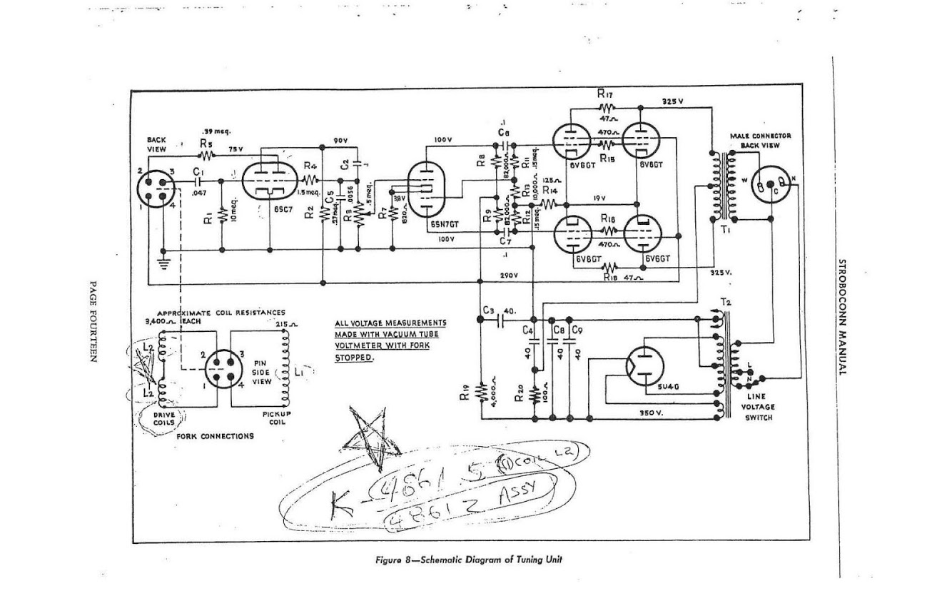

Stroboconn tubing unit PPP 6V6 plate & grid connection questions
I don’t have a direct schematic link yet, which I’ll try to do this weekend, which seems preferable to sending people to a complete PDF manual elsewhere with a ‘see page 14’ instruction.
But this seems simple, so I’ll try describing. It’s the tuning unit of the Stroboconn, an AC source to drive the synchronous motor in the other chassis with the strobe dials.
Two push-pull pairs of 6V6GTA, B+ From 5U4GB (350 VDC) to CT of OPT thru a 100 ohm resistor (no UL taps).
One of the upper tubes and one of the lower tubes each have plate connected directly to ‘ends’ of OPT primary (325 VDC). Each parallel pair has a 47 ohm resistor between the plates (one is connected directly to the OPT, the other through the 47 ohm resistor).
The upper and lower pairs both have a 470 ohm resistor between their (control) grids. (One resistor per pair). Possibly a shared grid stopper. Two tubes have their grids capacitor coupled to the plates of a 6SN7GT phase splitter that each have 82k plate resistors fed from the 290 VDC (B+#2?, same source as 6V6 acreens).
All four 6V6GTA’s have screens connected together (290 VDC) to a common 4k dropping/decoupling resistor that goes to the 5U4GB (same 350 VDC the 100 ohm plate decoupling resistor is fed by).
All 4 cathodes are connected together and share a common cathode resistor of 125 ohms (unbypassed) to a common ground point. 19 VDC at cathodes per schematic.
The control grids have a little more complex compound connection I should leave for a schematic graphic. They are not symmetrical. The lower pair have a 150k grid leak resistor to ground, but the upper pair’s 150k grid resistor goes to a 10k resistor (160k to ground). The upper and lower tube that have no grid stopper before the coupling capacitor.
The 10k between ground and the 150k upper grid leak resistor goes to the ‘lower’ 6SN7GT phade splitter grid. Uh-oh, some kind of feedback?
There is no adjustment or measurement option to balance the cathode currents.
The questions (if this is a vivid and accurate enough description):
Do the 47 ohm ‘series’ resistors in one plate circuit ‘balance’ the current in each parallel pair like emitter resistors in parallel BJT’s? (I should use the analogy of separate cathode resistors, but something is holding me back).
Does anyone else think the grid stopper arrangement is marginal?
What I do know is that the signal level is uniform, other than aging, etc. in other words it’s set up and only adjusted perhaps in a calibration step.
I’ll figure out a way to link to a schematic image when I get home.
Thanks for reading, if not looking.

Tuning Unit amplifier
Stroboconn 6T5 Tuning Unit amplifier - Google Photos
Of course I am going to make some changes, but want to study/learn from the things I haven't seen before.

...I’ll try describing. ...if this is a vivid and accurate enough description...
MUCH TL;DR.
Time it took to type that, you cudda put an image IN the forum posting so it would be handy even as external hosts go out of business.
The 10K.... how does the lower side of the driver get signal? This is a VERY common type of "phase splitter", you should know it.
"Grid stoppers" are for overdrive. This has an internal trimmer which is adjusted just to the edge of overload.
The 47 and 470 tube to tube... you think this is a low-frequency amplifier. But the tubes do not know that. They have gain to MHz. At those freqs the OT is a fat capacitor, every wire is an inductor, every electrode is a capacitance. A lot of little tuned circuits! When you strap two tubes together with non-zero length wires, and have the least capacitance each plate to other grid, you have a *push-pull* oscillator which may try to sing 13MHz. This will disturb the intended 55Hz signal several ways. But only if the tuned circuits are low-loss. Tossing a few Ohms in can damp the tendency to oscillate. In this build they are also jumpers, same cost as cutting and skinning a length of wire.
Tube idle current is moot: the amp only has to drive a motor. If it won't drive the motor, fix it. We are not looking for "sweet sound".
