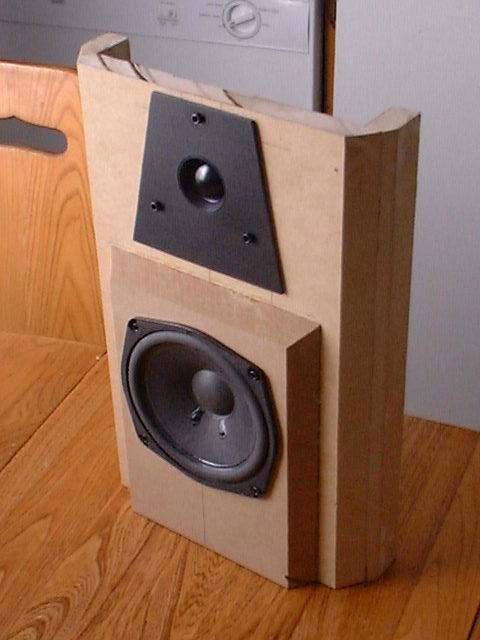

I made this dipole speaker with a 5" driver and a 1" tweeter I had off hand [pic].
After further listening I noticed that on some female singers, the long "ssssshssshssh's" in some words sounds a bit harsh and I thought that maybe because of some crossover problems the freq response had some strange spikes.
I measured its frequency response and everything is as predicted.
Even baffle difraction is as predicted.
Evrything is +\- 3 db flat.
Any idea what might cause that? It gets very anyoing sometimes...

Is the tweeter crossover 12 dB per octave???

no, a simple first order at 6khz, and I'd guess the tweeter can take that at normal listening volumes without encountering problems.
Many tweeters are made to be crossed at 2khz with a second order and at 4khz with a first order.
But yhea.. I tryed using a second order at 4khz and it did not help.

I suspect that...try a 12 dB octave...your tweeter is overloading ...
Or the problem maybe in your amp...try another...

I run it using my main amp, it played many speakers and I never noticed anything like that.
But I just tested it using a gainclone of mine, same problem.
The problem sounds alot like room resonance, but frequency responce plots do not show any when I test the speaker.
The strange part is that nothing else does that, only female vocals.

Hehe, I would have given driver brands if I knew them 🙂 some unnamed drivers I had off hand, I only had the thiel-small specs that I measured.
the filter is a 3.3 uF cap 😉
Anyway, I just found the problem, The cap seems to be faulty (or just really bad quality), I changed and everything is perfect now, its a electrocube film cap now, used to be some film unnamed cap I use for tests.
