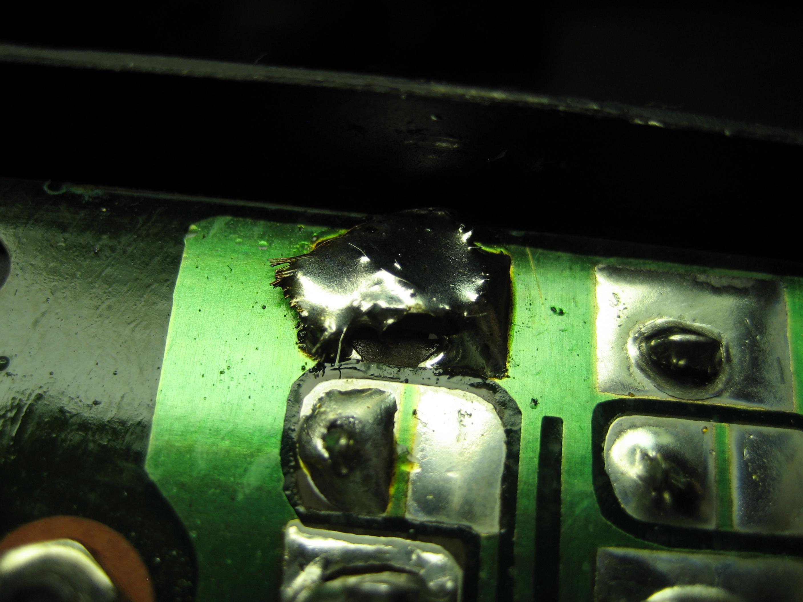

I purchased a NAD 1020a preamplifier last week with what I thought was just a minor defect with the stereo/mono switch which after cleaning, functions again as it should. However, only one channel is fully functional on the Phono input. Tape in works fine so I concluded the problem must be within the Phono pre-amp section.
Using Phono, the Right channel is good but the Left is quite weak. I swapped sides of the interconnects and the weak channel became the Right and the good channel was then the Left. Seemed like a bad cable so I used a different pair but got the same thing. Although unlikely, I thought perhaps the second set of interconnects was also faulty so I tried a 3rd but they too produced the same result.

If the L and R phono input plugs touch each other when both are inserted, that could make a bad contact.

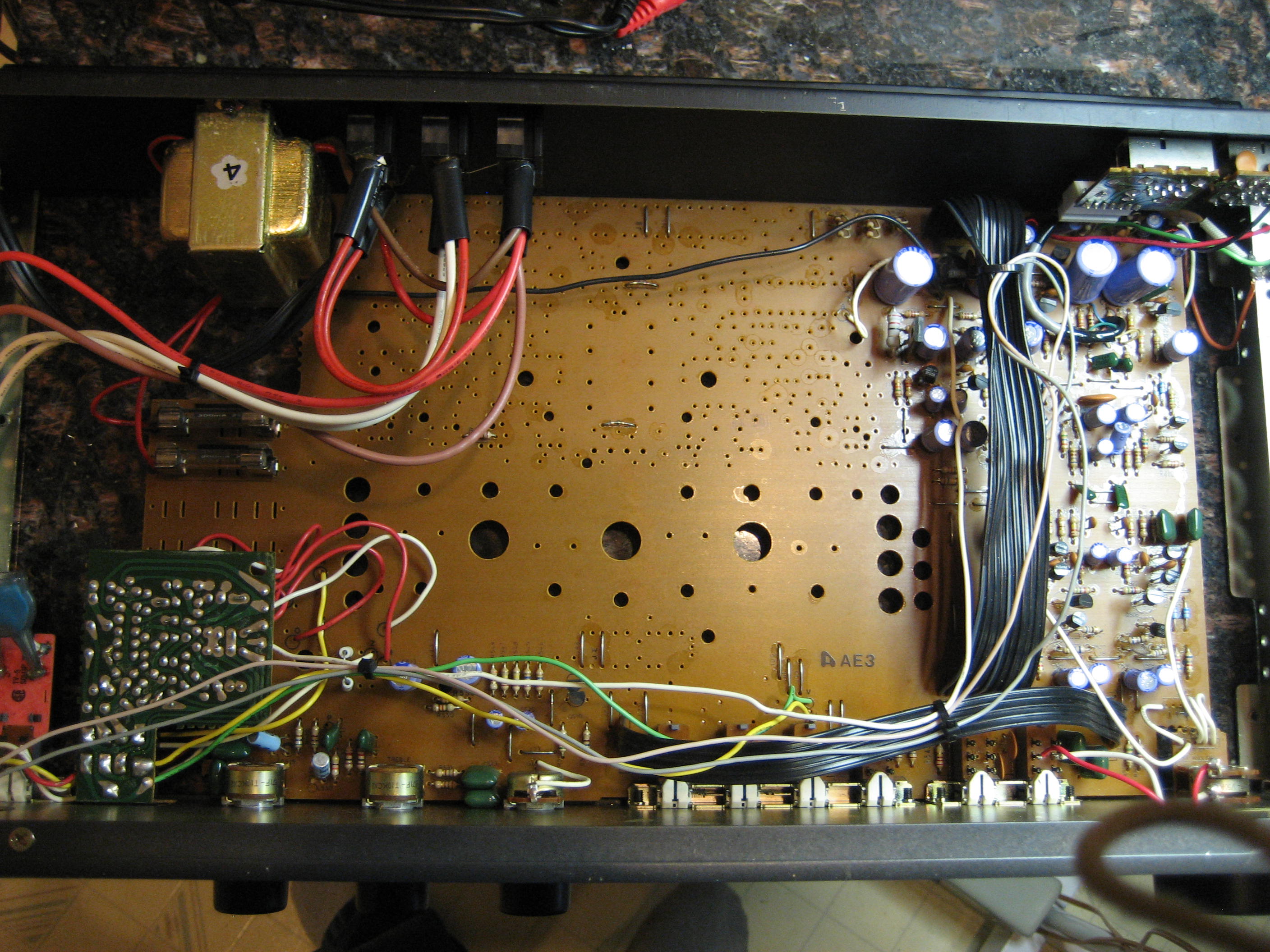

The phono circuit is fine if the channels work independently. Can you post a photo of the back, and the inside back?

It was one of those Eureka! moments - sort of. And it looks like Mooly nailed it.

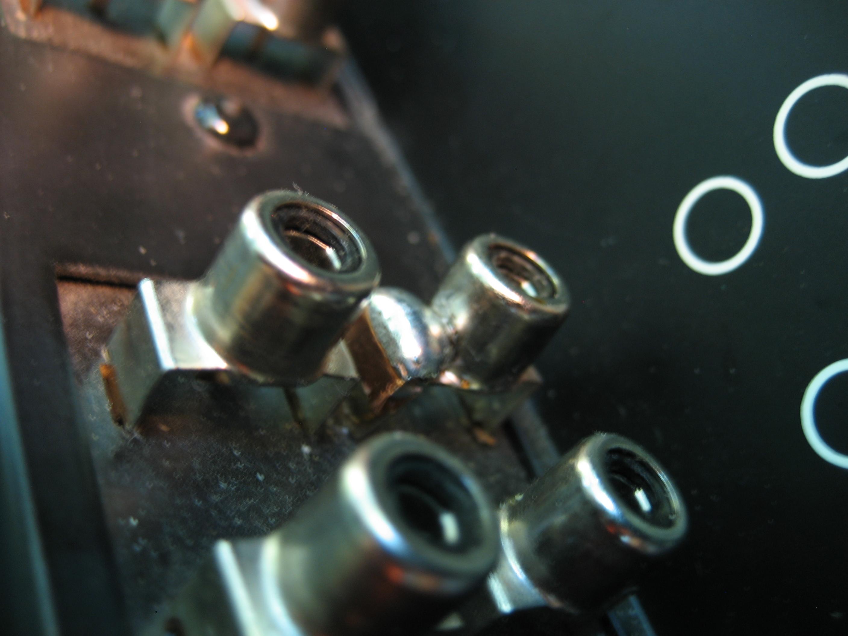

This thing has those vertically mounted input jacks that are supported only by their solder connection to the PC board. Some previous owner pushed down way too hard, I guess when plugging in their turntable and in so doing, lifted the ground pads off the traces. Close inspection makes me think the solder was reflowed once before to repair but it failed to provide any extra holding power.
The attached photos of the Phono In jacks are "afters" (except the broken main pre out jack), I did not think to take any "befores".
I laid a little braided solder wick over top of the worst broken connection and liberally applied new solder. Seems to have done the trick, at least for now.

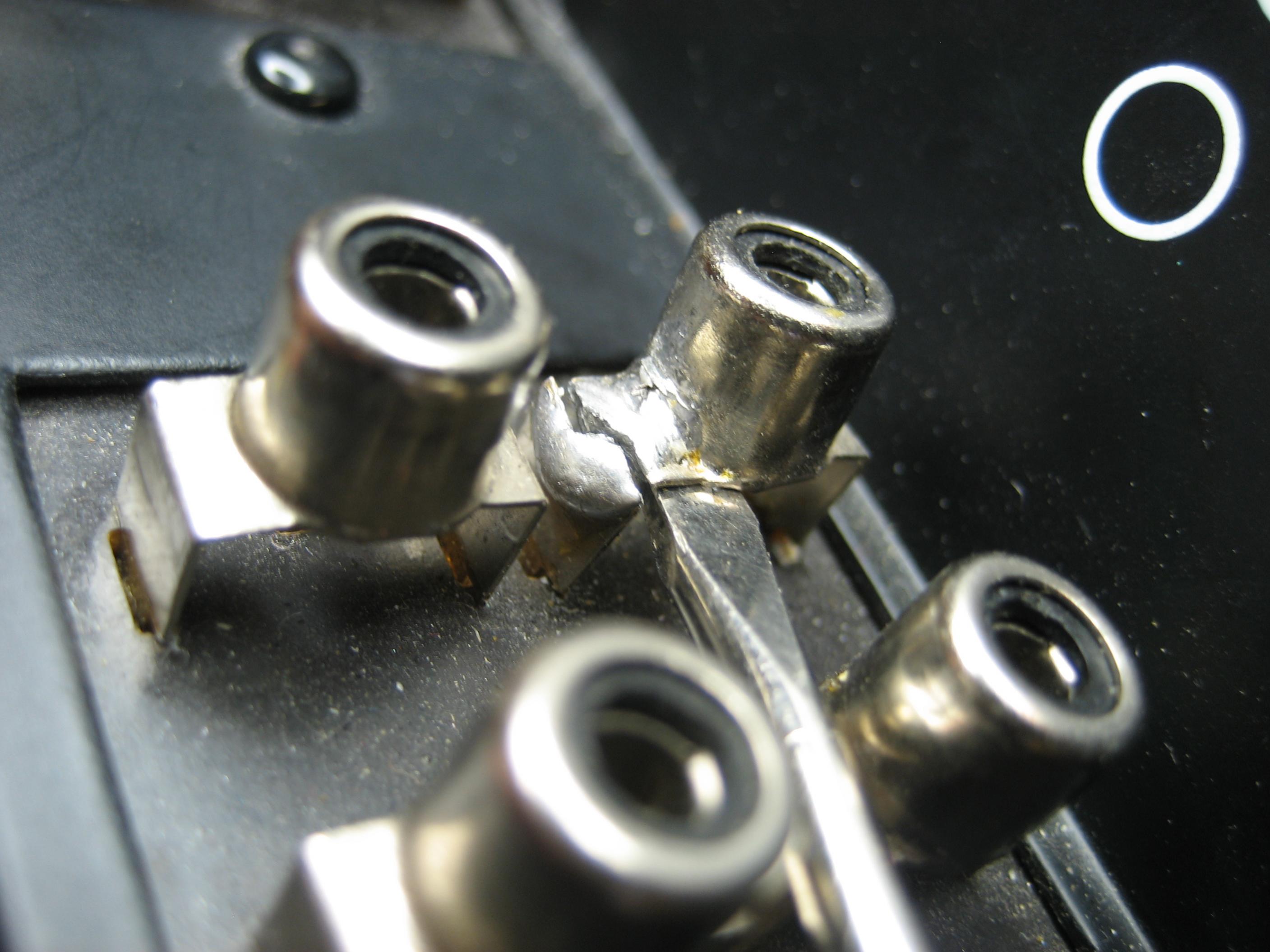

Although it functioned, I also found similar damage to a main pre-out jack. Worse actually because whoever connected their power amp not only lifted pads from traces but broke the external metal portion of the barrel that takes all the stress. A solder repair was attempted but it has obviously failed. I am thinking about a way to repair/re-inforce it because my intention was to pair this with a power amp I have and offer both for sale.
There sure is lot of room inside these things. Looks like they quit building while on the way to a 3020.

The near empty board is an inexpensive way to develop and manufacture lower volume items like preamps for the budget market. Just omit the power amplifier sections and speaker related features, fit a smaller power supply and rework the rear panel of an integrated amplifier - add a simple feature or two.....voila!

Good stuff 🙂 I think the braid should be fine. What I would do is scrape the print for some way around the connections and use the braid method. The second picture, top right connection has that classic ready to fail look to it... in the picture it looks as though the solder is cracked most of the way around.
Thanks for pointing that out. Looks like a picture says more than in the flesh because it looked fine first hand. I did do some scraping around the connections I did repair and will do so again
I made a repair to the broken main output jack. I used a small piece of copper sheeting (used for architectural roofing) cut to size and bent at 90 degrees. There was no way I could have soldered it onto the inside of the jack so it went on the outside. Had to use a lot of solder, but it's holding (again, at least for now) and despite its crude appearance, an RCA plug fits onto it fine.

I looked more closely and found several places where the jacks were partially lifted from the board. I guess the previous owner was a little ham fisted. Re-soldered them all so it's good to go.
