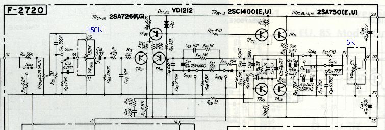

I haven't seen this previously but my Sansui AU-717 has a quad gang pot with 150Kx2 + 5Kx2. See the schematic attached with the 150K coming first and the 5K last prior to the power amp.
Any advantages with this arrangement as I know the AU-517 only uses the 150Kx2 at the same location? I'm just curious.

It increases the signal to noise ratio at volume pot settings below the maximum, it was quite commonly used in higher positined products in the 70's and early 80's. Normally, the power amp would fully amplify the preamp noise even when the volume setting is minimal, in this manner, the output of the preamp is also attenuated, making the total apparent gain of the combination smaller at lower volume settings, therefore there is less noise. The pots have a slightly different taper in the case of the AU517 and 717 because of this, to produce similar attenuation vs. pot position.

This tape, into center resistance, allow the loudness contour actuate into low levels.
The Loudness compensates human ear losses into bass when you play into a very low volume...some loudness also increases a little into high frequencies..but mainly into low end.
Because of this tape...when you play your equipment loud.... swithing the loudness control on and off you will not perceive differences in sonics.
Equipments that do not have this tape works with the loudness engaged all time long....no good that, because will start to distort very soon...bass reproduction uses almost 60 percent of the entire power.... as soon reaches the limit will clip.
