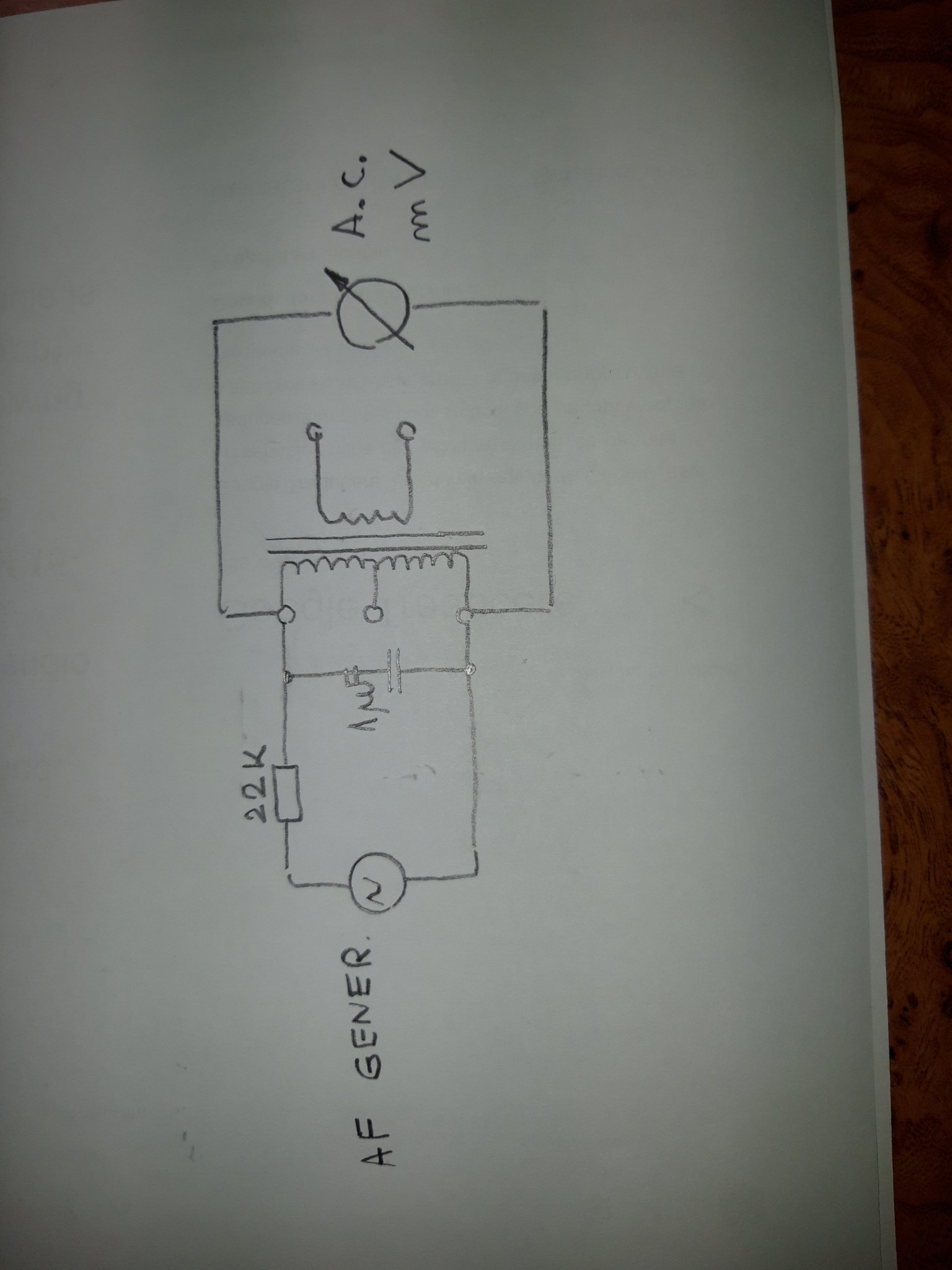

Try the 1uF condenser ub resonance method, the LC circuit is powered by an audio generator with a series resistor of 15-30k and with the frequency determined following the resonance from Thomson's formula is inductiveI have a pair of custom made PP output transformers on EI130 laminated core. The core is a common laminated silicon steel core used in mains transformers. The number of primary is 2 x 1600, the number of secondary turns is 2 x 80. The turns ratio is 20.

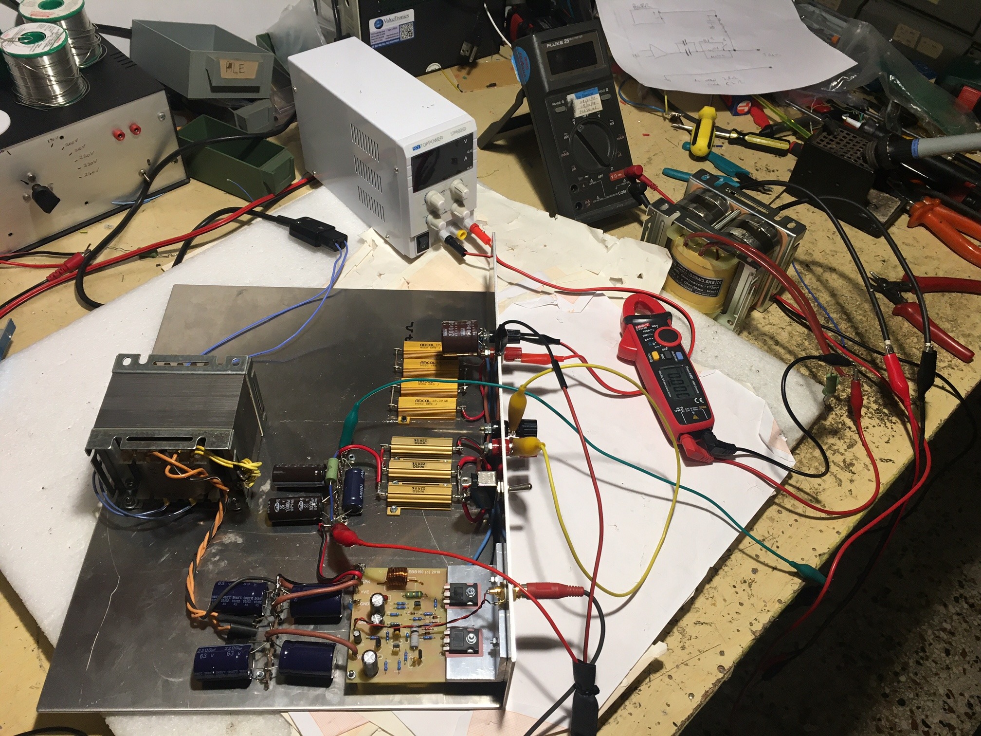

About dc current in OT , in photo th proto of test set ( almost finished), it is complete with a ss amp to drive the OT on secondary
Walter

I measured the inductance of the half primary with this method, it gave 16mH. Is it acceptable?Try the 1uF condenser ub resonance method, the LC circuit is powered by an audio generator with a series resistor of 15-30k and with the frequency determined following the resonance from Thomson's formula is inductive

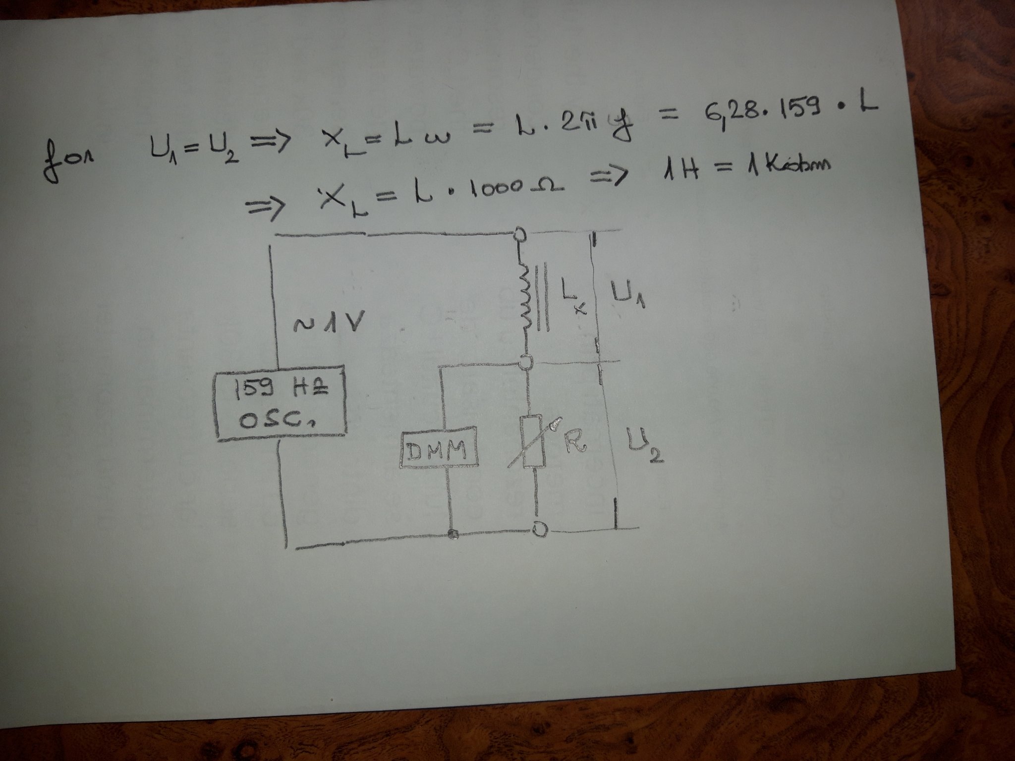

The values of the two inductors found by you cannot be real, from the OT data given by you, the inductance is probably about 30-60H. In addition to the resonance method, an inductor can be measured with the circuit in the photo where the resistor R is adjustable to equalze the two voltage U1 and U2. If the value of the resistor R is measured, the conversion 1H=1Kohm results. Ipracticaly built this device and it works flawlesslyI measured the inductance of the half primary with this method, it gave 16mH. Is it acceptable?

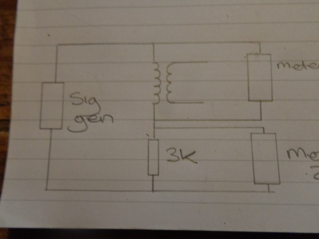

The simplest method of measuring L I've found is wiring the primary of the OPT in series with a resistor, see attached. Connect a sig gen - 20hz to 100khz to them , alter the frequency till you get both meters showing the same AC voltage, then use this formula - R divided by (6.28 x frequency) = L. You might need to change the value of R, but this method works. I've verified it by checking L on an inductance bridge.
You want L primary to be a big as poss, around the 100H ish mark is typical for your average OPT.
Andy.
