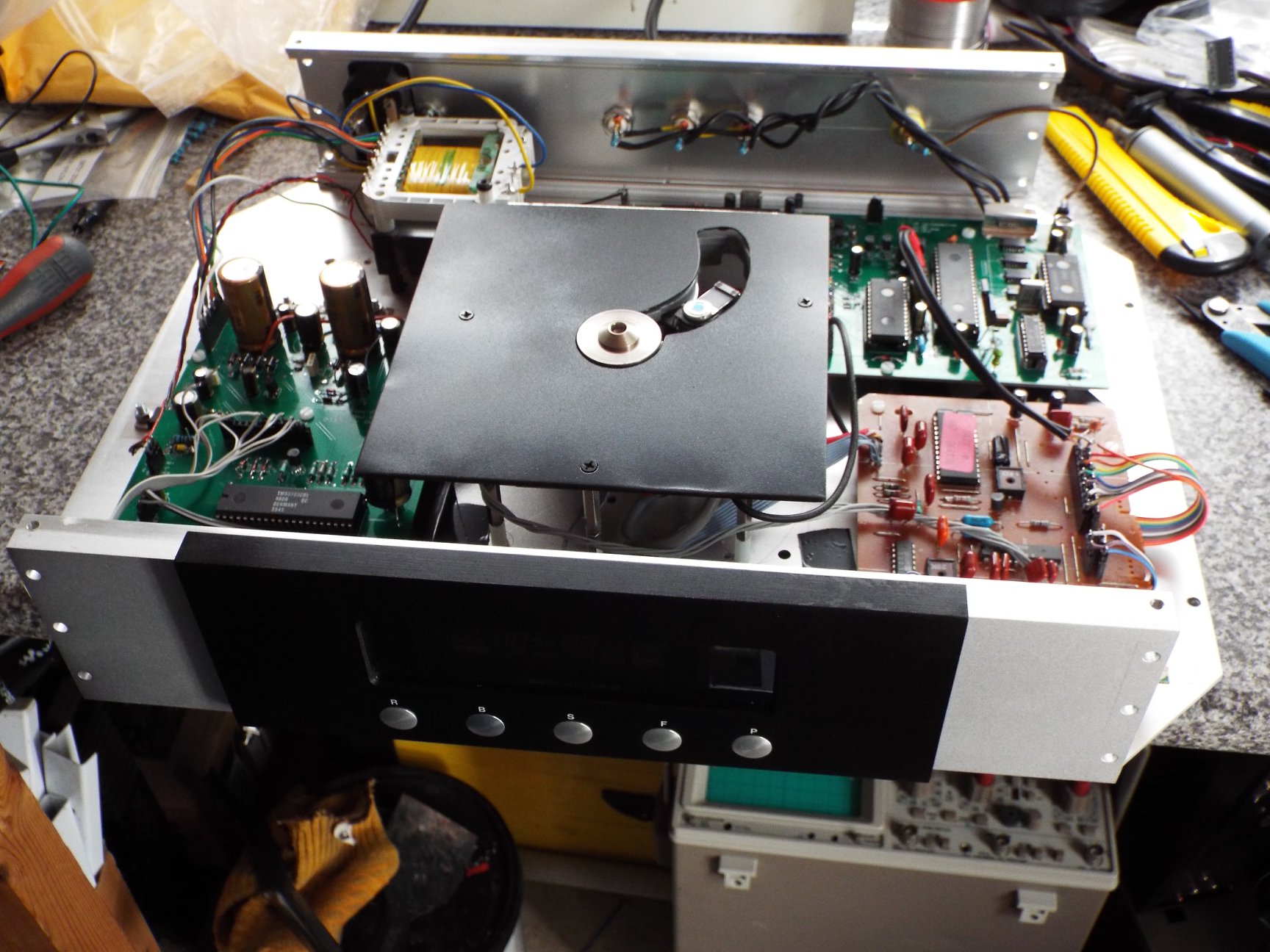

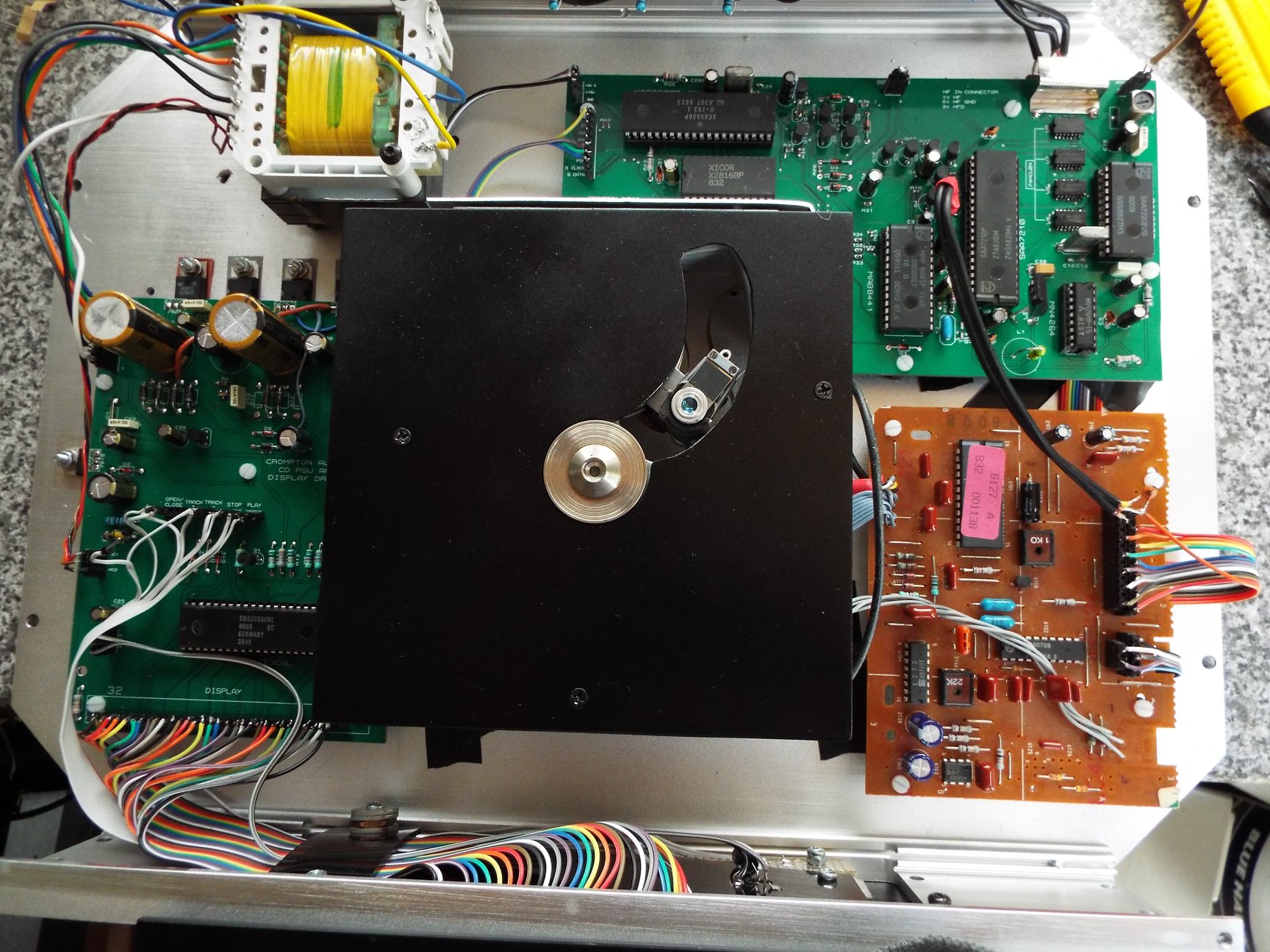

I've just finished a full recap and service on my recently acquired Philips CD100 vintage CD player.
After overcoming a few unexpected issues the player now reads and plays well part from the fact that towards the end of a disc, say track 10 or 11 on a typical album, the player starts to make a strange high pitched ringing noise.
It sounds just like running a wet finger around the rim of a wine glass! Up to around track 10 it is silent and then beyond that point the ringing noise starts.
Has anyone here ever experienced a problem like this and what did you do about it?
I adjusted the turntable height (raised it a little) and it seems to have cured it.
