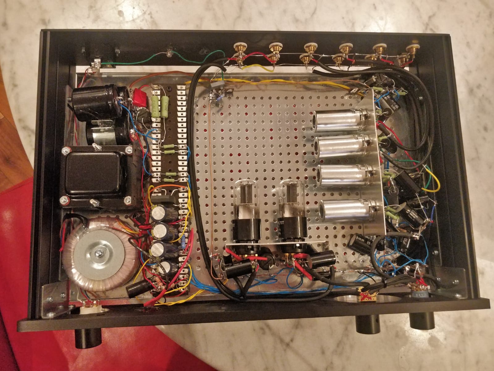

I've built three identical phono stages based on the Phono Dude phono stage which uses 5755 input tubes. The strange thing is one hums when I plug in the turntable, the other two are silent. The builds are exactly the same. I'm using the same record deck, power amps, speakers, and mains leads. Absolutely everything is equal.
Without the phono leads from the deck plugged in all three have identical low noise and no hum.
The only objective difference I can pinpoint is the grid reference resistor on the input tube is around 1cm longer than the other two. The 5755 runs with a directly earthed cathode.
Any tips anyone can give me are very welcome. Thanks!

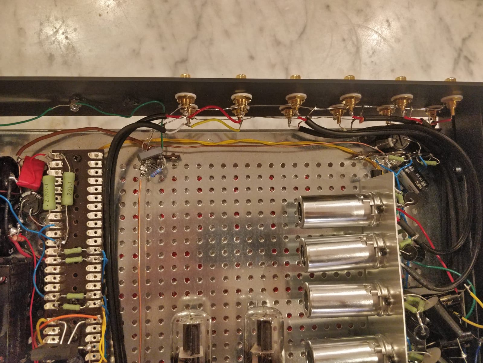

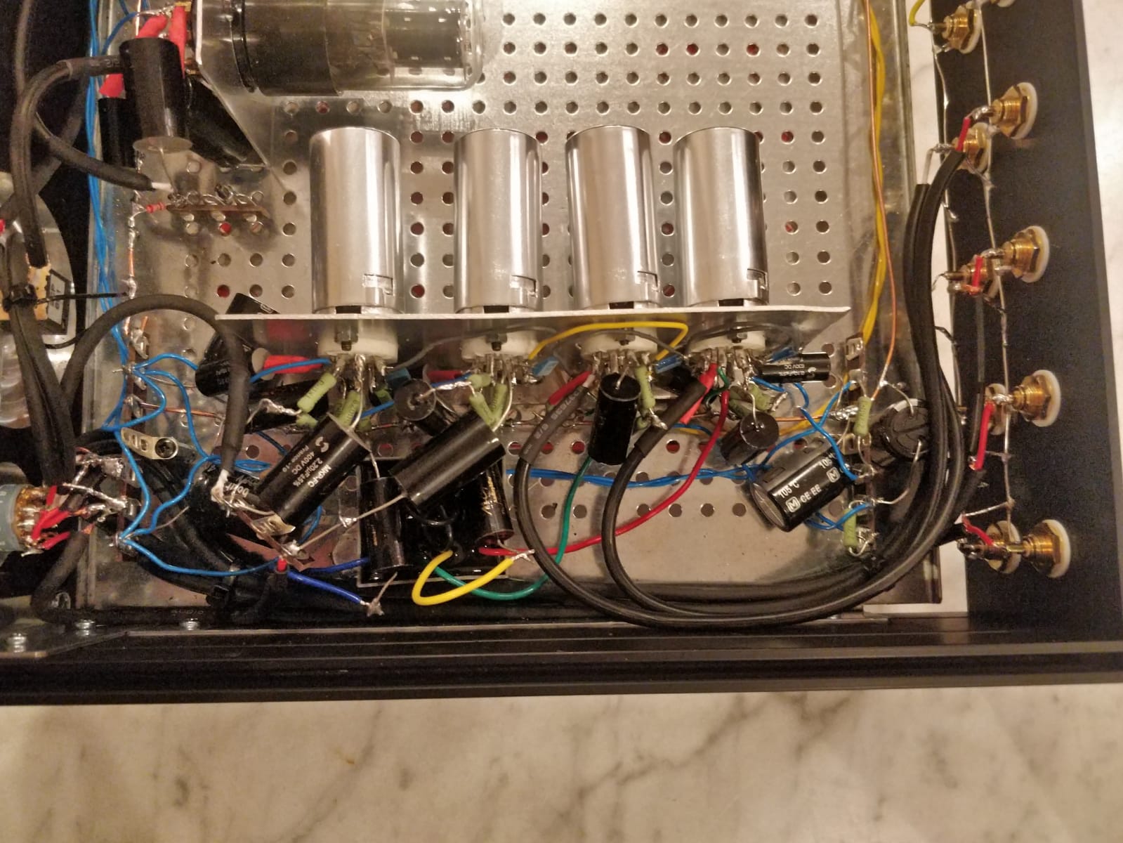

Ok. Attached are 4 photos of the pre /phono and here are a few more details:
1. Heaters are DC regulated with 40v lift
2. The main power supply is earthed via a 2.5mm copper bus
3. A 1.5mm copper bus bar goes to the line stage at one end, and the phono at the other end.
4.All input /output sockets are earthed at point of entry and then to the star earth where the two buses meet and where the power supply is joined to the earth lift connection to earth
5. The difference in the phono cathode connection is maybe 10mm between the cathode and grid reference resistor on the humming example, 2 mm on the quiet ones.
6. All the sockets are correctly floating from the chassis
7. The transformer wires are colour coded so connected correctly
Thanks for any help!
