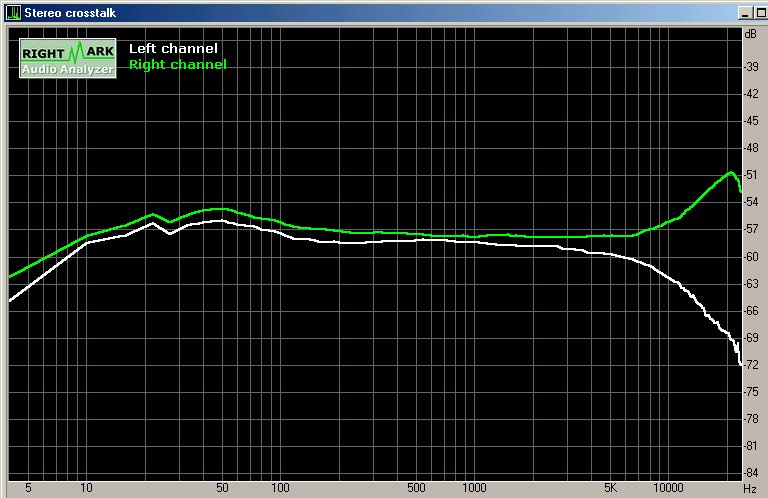

This is the image of crosstalk result from tests on my power amp (actually a Technics stereo receiver) using RMAA. Notice how after about 5-6Khz the crosstalk increases on the left channel but decreases on the right channel. Why is it happening so ?
I would expect the crosstalk to increases or decrease on BOTH channels not go in opposite directions as is shown in the picture.
A- Have you run a basic loop-back to be sure your soundcard and connections are not at fault? I have found that those 3.5mm mico phono plugs that you have to use with soundcards can be a source of priblems -- including crosstalk. Some are better than others -- it seems random.
B- measure the resistance of the two resistors, then of the resistors plus the wiring connected to them. Be sure they are the same for both channels.
C- swap the left/right connections at each stage to be sure the problem remains in the left channel of the amp and does not depend on the test setup connections.
D- be sure the soundcard mixer software has disabled all the effects and "features".
I'm mentioning all this because I've found that wierd results can sometimes be attributable to the set up glitches. I one spent a couple of days looking for high distortion in an amp when the real problem was in the soundcard.

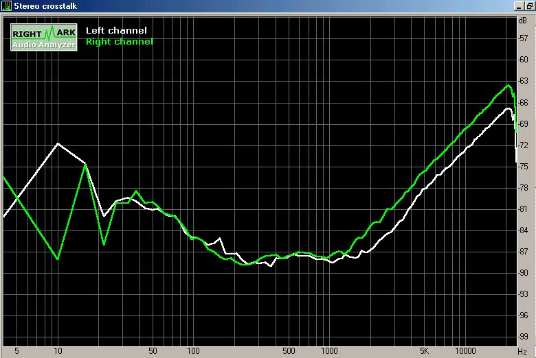

That was probably it. The connections to the resistors from the output terminals were probably goofing up things. I re-did them and the measurements make more sense now. Here is the crosstalk of the amp now -

it may well be that the differences displayed on loopback between channels could be exacerbated when operated into the different impedances of the test amplifier.
Your crosstalk is not good - what is the composition? My last commercial amplifier had 91dB channel seperation - at 20KHz, using a common power supply. At 91dB + the composition doesn't really matter.
Greg
I get a little lower X-talk on my SC card with the loop-back, but not much.
I think you have to subtract the loop-back figures from the amplfier's graph. A pain in the neck and not very exact depending on how accuratly you can read the values off with a ruler. I would just look atn the 1k and 10k points. RightMark has no function to do this for you -- you can't even get a data file from the graph.
This assumes cross talk is cummulative. If not, someone let me know please, so I don't get led astray.

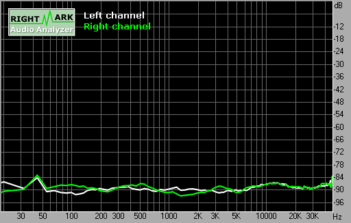

I attached the crosstalk from the soundcard i am using now, it is
a "m-audio delta 2496", not too expensive and not built for gamers...
Have you verified that your loopback-cable is not defect/unshielded ?
Full report:
http://www.lf-pro.net/mbittner/rmaa/M-Audio_32b96.htm
Mike

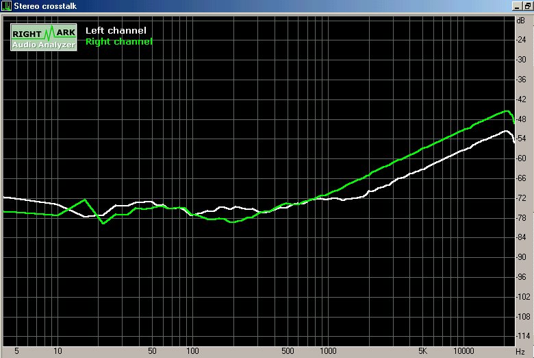

I was operating at about 3W rms into a 5-ohm resistor. Maybe my amplifier vocabulary is bad but not sure what you mean by composition. Its a Technics Stereo Receiver - basically a chip amp with Class H+ configuration.
This is a pic of the no-load xtalk. Its better than the one under load.
This brings up another question - is it normal for xtalk to increase under load ? And this is a very light load as compared to what it can take (100W into 8ohm, I know it is 4ohm stable).
edit:- Note that it is following the trajectory of the soundcard's xtalk.
