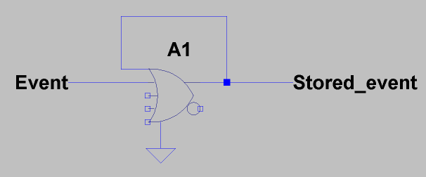

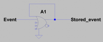

I have a fault signal, at the moment 3.3 V logic but this is negotiable, which I wish to store. A simple OR-gate will solve this, but only until the supply voltage is cycled. An MCU would be a simple solution but here is the real issue, I don't even have 1 mA to spare, at least not continuously. Any voltage level yes, but current no. All glue around this lives on a few uA.
It can be OTP.
It does not have to be fast. The fault condition signal will be present for several seconds before the power can be cycled.
Any suggestions?

Diode couple the supply to the OR gate and supply the gate from a backup cap or backup battery when in standby.
Sorry, not allowed to use batteries due to risk of leaks. 🙁
Any solid-state solution? Ultra-low-power OTP memory?

Use a purpose designed backup cap. Very very small and would power it for months. Remember the gate uses zero power (apart from internal leakage) and even a 1uf film cap would power it for far longer than you might think.

Preferably indefinitely. If someone takes it out of service and installs it five years later, it may be/is still damaged.
Less than 10 uA. I can store some energy into a capacitor if the OTP/circuit which stores the flag/fault-bit takes more current than that for a short amount of time. Problem is Iq or just the current consumption when active but not writing the flag/fault-bit.

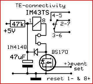

Probably the simplest way is to use a bi-stable relay.
Ones exited for a (very 1ms) short time it stays there.
To reset it has to be connected to a voltage of opposite polarity.
Since it needs power only for a moment you can store that in a chemical.
Something like this,
