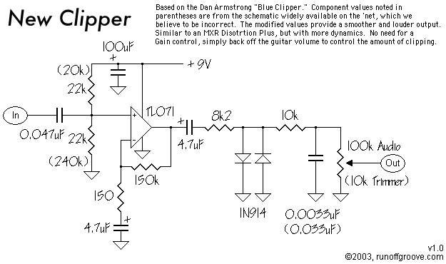

I built this distortion project, and I can't seem to get it to work. All I get is silence (i can hear some noise when I turn the 10K pot and when I insert a jack, but no guitar sound). I swapped the two diodes for IN4007's because that's all I could find. I also swapped the op amp from the TL071 to a 741 from Radio Shack. Could these swaps cause this problem?

Should work fine, although a little limited because the 741 is far lower spec - but it should work.
Measure the voltages round the chip - presumably you've connected the correct pins?, and the chip is the right way round?.

Yeah I got it to work (I had routed one of the wires wrong), but its not very loud at all. I guess maybe I'll order that chip. Would the diodes make any difference? Also, one of the 22K resistors is getting really hot is that normal?

No, the diodes won't make any difference - but there's no way a 22K resistor can get hot off a 9V battery - if it's getting hot, it's not a 22K. Even directly across the battery, it would only dissipate 0.004W.
OK I'll check the bands, it might have been in the wrong bin or something. Unless I grabbed a 22 instead of a 22K. Thanks again for the help. I will check on it.
Yep, that was it. wrong resistor. I will have to get the right ones and give it another try. Thanks
Actually I believe the Diodes do make a differance...I believe The diodes limit the output voltage to 0.7v......
I have noticed this with pretty much every Distortion unit I have built that uses Clipping Diodes on the output....
If you use LED"s you will get much more output (1.5v) and a more Nu-metal sound....if you get rid of the diodes all together it will be a lot louder but the overdrive might not be very pleasant.....

I was wondering if I could use some 10 or 15K resistors in place of the 22K resistors. I believe it still halves the voltage, but I don't know the whole purpose of those resistors.

Thos resistors create a Voltage divider to give a Voltage referance at the input at half supply....You can use pretty much any 2 identical values accept too low a Value might cause your battery to drain quicker than usual....it should be fine with 15k....
Cheers
PS: you can also replace the 150k resistor in the feedback loop with a 100k-250k Potentiometer wired as a variable resistor which will let you dial in the ammount of gain you want, You can even put a switch on the Diodes so you can Enable/Disable diode clipping , or even put different diodes on a switch so you can get different Diode clipping tones , you can even use Mosfets as Diodes clippers but I like the sound of LED"s....

Minion said:Actually I believe the Diodes do make a differance...I believe The diodes limit the output voltage to 0.7v......
Which of course they do, and that's why they are there - but I was refering to using 1N4001 type rectifiers instead of 1N4148 type diodes - which I presume is what he was asking? (check the context of the previous posts).

Actually you would increse the 150k resistor to get more gain...
Actually the way the schematic is set up the gain is allready at 1000x (150r and 150k in feedback loop to set gain) which is plenty for an overdrive (Even overkill), but more Gain isn"t going to make it louder cuz Like I said before the Diodes on the output are going to limit the volume as they clamp the output voltage at 0.7v....Try takeing out the diodes and see how much louder it is , just too see that the curcuit is working correctly ,and if it is much louder then try LED"s because they will clamp the Output voltage at 1.5v which is double the output Voltage.....
Most Overdrive curcuits of this type have an aditional Clean Gain stage after the Diode"s to make up for the loss in Volume , you can do this your self by putting two of the same curcuits end to end minus the Diodes on the second stage.....

The issue with the circuit is that the input impedance is way too low for a guitar. The input impedance will be determined by the two 22k resistors in parallel, so it will be around 11k. A guitar amp should have at least 500k in input impedance in order to not load the pickups too much, so you should use two 1M resistors to be good.jman 31 said:Thanks so much for all the good info guys. I have one more question. If I was to lower the value of the 10K resistor that is between the diodes and the 100k pot, would I get more volume? I am not getting enough volume as compared to when the box is bypassed. Or would there be another route I could take to increase the gain?

Also Like I have said twice (no one seems to listen) is your output Voltage is Limited to 0.7v because of the Diodes which means that your Volume isn"t going to be very loud...Some Guitars put out more that 0.7v by them selves without a Booster so In theory the Curcuit could make your guitar quieter than without the curcuit....
runebivrin : Is right though, the input impedance is too low for proper signal transfer from your guitar through the curcuit...
Try adding a 1- 2m resistor from the input to ground...
If that doesn"t fix the Volume problem you are going to have to switch to LED"s (like I also said before) which will double your output Voltage, OR add another gain Stage.....

No Problemm...Impedance is a very hard concept to grasp at first, but a Basic rule is the input impedance of a curcuit should be at least 5 to 10X the impedance of the signal it is amplifying for the signal to be transfered without loss.....
The ouput impedance of a Guitars pickup can be anywere from 5k to 100k so the input impedance of a guitar preamp should be at least 500k but 1M seems to be a standard value.....
Impeance and resistance are very simular accept Impedance changes with frequency.....
To set the input Impedance of a opamp curcuit you would generally put a resistor (of the Value you want to set the impedance to) from the signal input to ground .......
So if you want to set the Impedance to 1M you would put a 1M resistor from the input to ground......
Look at this schematic and see how there is a 2m2 resistor to ground at the input.....
http://www.generalguitargadgets.com/pdf/ggg_dist_250_sc.pdf
Also notice how it only uses the Virtual Ground for the Input Voltage referance and not anywere else, were your schematic uses the Virtual Ground for every ground...Most pedal curcuit I have built used the Virtual ground only on the input.....
