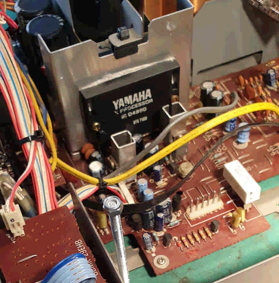

Hi, while restoring radio amply Yamaha R1000, I have found a problem in to DC DC Voltage converter Processor named "Yamaha stk7100". This device has 16pins and coverts from +/- 73VDC and 42,5VDC to +/- 42VDC and 24 VDC and 25 VDC in each specific pin. But it does not provide the valid voltage to the main amply stage, it should convert form +/-73VDC to +/-42 VDC but it works only for one branch/side respect to the zero, the other is left to 73VDC (-42VDC ; 0VDC ; +73VDC). Somewhere I have found that maybe Darlington STK 3106 (Maybe Sanyo) may be the corresponding/equivalent one for commercial brand.
Has anyone faced the same problem? Does it be possible to find a conversion table from this probably proprietary label from Yamaha to a commercial one, e.g. Sanyo or others? Thank you very much for each useful comment or reply and sorry for my terrible English and not being so experienced in electronics restoring.
