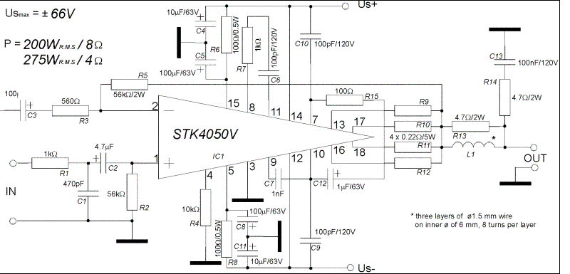

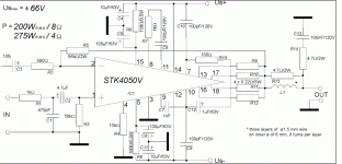

Q-6. R15?
There is a Sanyo datasheet,
And also schematics I've found on this forum (attached);
There is one question- what is the purpose of the 100 ohm resitor R15? There is no such resistor in Sanyo datasheet...
Q-7. Stopping oscillations
rljones posted: this;
Should I change the input resistors from 1K/56K to 1K/20K, and why exactly? Where should I put that 200pF cap- between ground and which point in the schematics?

Q-9. Part list
Considering the schematics and common sense, I have made this part list. Could someone be so kind to check the voltage and power ratings for the components?

R1 1K 2W 5% carbon film
R2 56K 2W 5% carbon film
R3 560 0.5W <1% metal film !
R4 10K 2W 5% carbon film
R5 56K >2W <1% metal film !
R6 100 2W 5% carbon film
R7 1K 2W 5% carbon film
R8 100 2W 5% carbon film
R9 .22 5W 5% ceramic
R10 .22 5W 5% ceramic
R11 .22 5W 5% ceramic
R12 .22 5W 5% ceramic
R13 4.7 5W 5% ceramic
R14 4.7 5W 5% ceramic
R15 100 0.5W lin trimmer
C1 470p 500V ceramic
C2 4.7u 160V electrolytic
C3 100u 160V electrolytic
C4 10u 160V electrolytic
C5 100u 160V electrolytic
C6 100p 500V ceramic
C7 1n 500V ceramic
C8 100u 160V electrolytic
C9 100p 500V ceramic !
C10 100p 500V ceramic !
C11 10u 160V electrolytic
C12 1u 350V electrolytic
C13 0.1u 400V polyester film
A-Parts list
Over kill on your cap voltage!!!!
C1, C2, C3 are all low voltage stuff like 1~2V so 10V caps are good for that and will save you some money and space.
C4, C5, C8, C11, C12 are way too high, suggested value on schematic is 63V which is way more than enough.
C6, C7 50V should be more than enough.
C9 and C10 should be double so if using a 50V rail, use 100V caps
C13 should be what is shown on schematic, 120V
Resister wqattages are way too high!!!!!
R9, R10, R11, R12 are good, leave them at 5W
R1, R2, R3, R4, R7, R15 could be 1/8W but 1/4 are easier too handle.
R6 and R8 are 1/2W as listed in schematic.
R5, R13, R14 are 2W, agin as listed in schematic.
Input voltage as stated above is about 1~2V max and Input imp. would be fairly high which is good.
Q-1,2,3 can all be done with on IC like the HA12001 (which is out dataed but good for examples) which can disconnect the load if the amp gets too warm (load = HEAT). It can also (because it uses a relay for load disconect) remove the load incase of amp shorting or disconnect load if load shorts. It also has a delayed on and almost instant off so pop noise is unheard of.
Sanyo recomends a 8 Ohm load so I wouldn't attemt any lower unless you want to lose a STK. High ohm speaker is easier for amp to drive but going from 8-16ohm will cut output power(W) in half.
Don't worry about Q-7 until you have built the amp then you can check for oscillation and fix it then.
Having a regulated PSU will not yeild a hole lot of inprovments for all the work and space that would be required.
BTW I have no Idea what R15 is for exactly, looks like a snubber network across pins 7 and 10? anyone want to correct or verify?

Possible oscillation problems in the near future...
Thank you for the info!
If I got it right, the IC HA12001 solves the problems of overheating, short protection and pop noise? I didn't mannage to find the datasheet, nor a single thread on this forum... Are there any better solutions? Any links?
Regulated PSU is not worth the effort? Is the float voltage regulator too bad? I guess that 10000-50000 uF cap will be enough?
Does anyone else know the purpose of R15? I'll put a 100 ohm/0.25 W trimmer and see what happens...
I'm working on a PCB at the moment, and I do things nice 'n' tidy; so I'd like to know where should I put that cap if it turns out that I will be needing it. And what about that input resistors???

I believe this cap goes from the right side of R5 to ground(the side of the resistor that goes to R9), thats the impression I get from the post you linkined in your first post.
BTW these stk amps sound just fine to me, the main problem is people either thinking these sound bad, heared it in a crappy design or are massive audiofies.
Oh and a newer up to date amp could be the TDA7293 (100W 120V 4-8Ohm load with low THD.)

Re: Re: One STK4050V Warm
Thanks for the reply, will check on that..BTW I've read somewhere in the post to install 200pf cap on the circuit as a solution to the OSC.. can somebody highlight where's there correct place to install this cap. I will try that as part of the t/shooting stage.
TQ.
EWorkshop1708 said:
Sounds like oscillation in one. If both channels are identical, they should be same temp. Make sure you have zobels and small caps to filter your power rails
TQ.
satcure645, i saw your first post, and I started typing a reply when, all of a sudden, my hard drive died.
Please wait a day or two (I need to recover the data), I have answers and complete instructions for all of your questions! 😉
I'll be waiting.....Thanks Again...
BTW the Hum already gone as my amp input cable (going to the Mixer) is sitting on the Main Transfo which producing the Humming sound during the test-currently only heating problem which I believe due to oscillation..need to be solve.
Both module are identical and both connected to same power source (+- 56Vdc 100VA) with 20000 uF per rail/40000 uF for both.
To start.............
Put a 200pf cap on the input of each amp. It filters out high RF frequencies, so only the audio itself goes into the amp.
*Highly recommended for ANY AMP is to add a HV 0.1uf capacitor (bigger if you can) to the power supply rails closest to the amplifier. I'd recommend 0.2uf to 1uf or more if you can find them.
Keep all input signal wires AWAY from the transformer!!! Keep the transformer away from the chipamp too. No need to have the transformer "inducing" currents into wires it's not supposed to.
EWorkshop1708 said:To start.............
Can you provide the "solution" on the schematic i.e 200pf on the Input and HV caps at the supply rails show on schematic as to avoid any future mistake - TQ.
Currently using 100nf/100v at both neg rail to gnd and pos rail to gnd. Power Supply designed based on NMOS 350W (Quasi Complimentery - under Power Amp Under Development Section). Caps change to 20000uF per rail.
