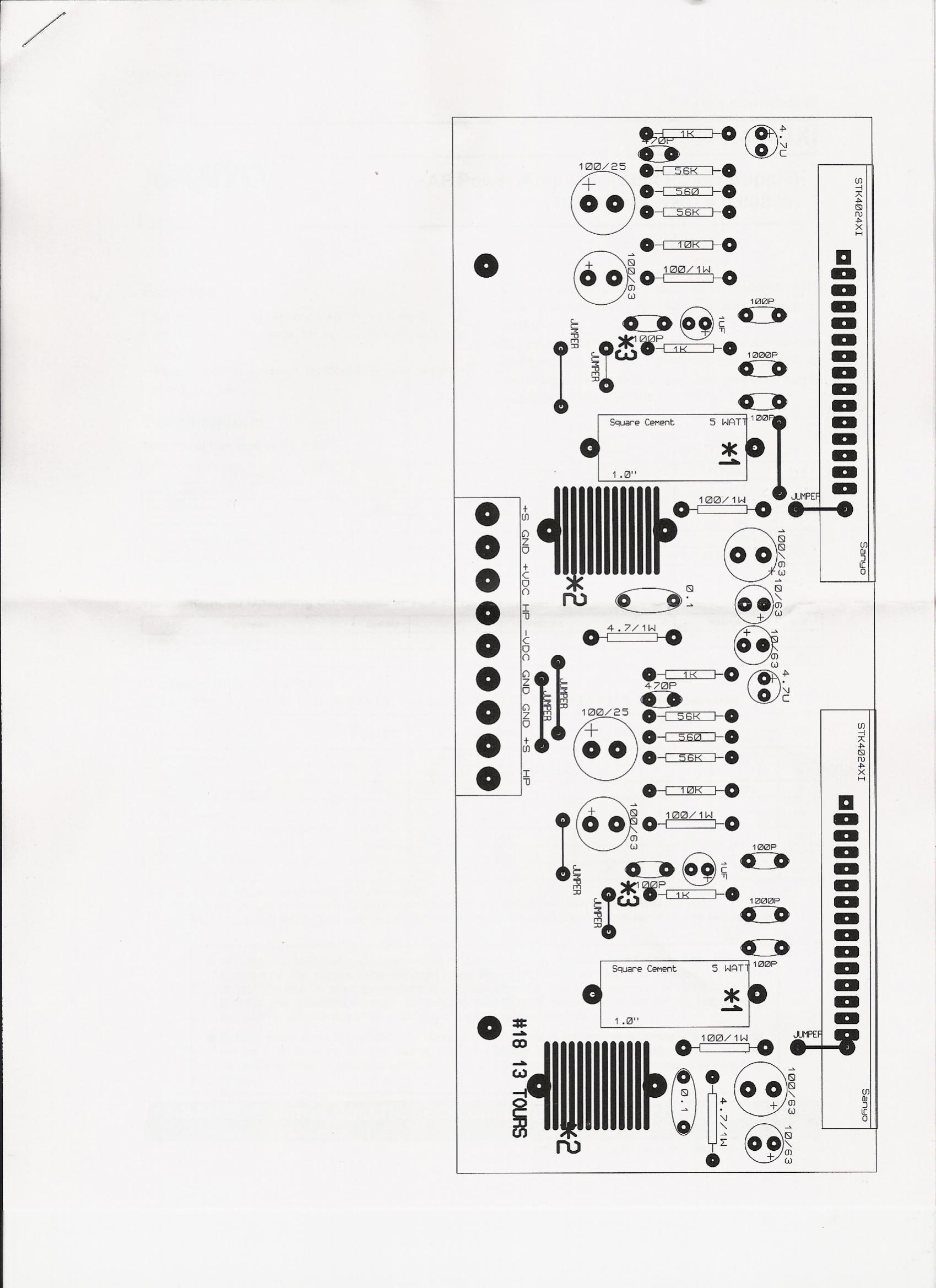

I bought these PCB with all components installed. I would like to know more about powering these. At 100 watts RMS into 8ohms per module, I was told that ideally I would use a torroidal 38-0-38 250VA.
I do not need that much power. Would I reduce the voltage, current or both to make them around 50 Watts RMS. I would prefer not to attenuate and at full power, be the loudest that I will ever use with a nearfield monitoring situation. I would also like to know what signal power I need to drive these. The PCB has 2 STK4044XI. My hopes are to use this pair to bi amp speakers.

I would follow the data sheet for all the circuit details.
http://www.datasheetcatalog.org/datasheet/sanyo/STK4044II.pdf
Perhaps aim for around -/+45 DC which suggests a 30-0-30 tranny. The AC voltage will be higher at low load anyway. 50 watts RMS/8ohm is 28 volts RMS or 40 volts pk/pk.
Power up initially with a bulb tester... just in case there are any construction errors... it could save damaging the STK's
The "signal power" (you mean voltage) needed for full output depends on the values of the feedback components. Thats the 56K and 560 ohm in the application circuit. They give a gain of (56000+560)/560 which is 101. So for 28 volts RMS output you need to apply 28/101 which is 277mv RMS. In practice that means line level and a passive volume control.

Can I expect good results from these modules? I would like to drive a Dynaudio 17w75 from one module and a dynaudio D28/2 from the other. I am hoping to exceed the quality of my Blue sky that used Tip 35 and Tip 36. I do not need much power. I am always attenuated while working at my desk.
I think they should be fine sonically. The internal equivalent circuit shows a quasi-complementary output (two npn) so that bodes well for sonics.
