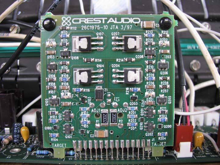

The Crest solution to NLA STK voltage amplifiers.
The Crest solution is the far better one.
I have on hand a number of STK 3082 II that are NOT fake. They were for a project that never got made.
I have actually never heard of the crest ones. Do they offer 1:1 copies, or are it mere substitutes?
What concerns me when looking at the crest ones is again cooling, or is a heatsink attached at the rear of them?
