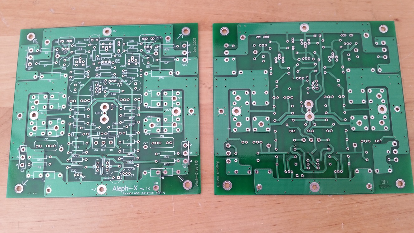

Finally i got hands on a set of Grey Rollins Aleph-X pcbs.
My first plan was to build just the original version with 4 FETs
But i am not shure. Maybe a little bit more power would be usefull 😉

My plan so far:
2 mono Amps
I have 2 toroids each 625VA 2x22V
24 matched FETs IRFP240, so 3 in parallel would be possible, 12 per mono, 24 stereo. I know, to much for the 625VA.
For the power supply i will use a CRC sheme.
I have a set of 60mF condensers.
68mF – 68mF – R – 68mF per rail. Doubble per mono, again doubble for the whole stereo amp.
I am not shure about the resistors, but i have Duncans PSU Designer to play with that.
Beside this i have one Fischer heatsink of about 0,2K/W per mono chanel
Using the Phill AX sheet i could see that lowering the voltage and increasing bias amperage will end in having more power at low resistances
So it looks (at least for me) that i have the wrong FETs and the wrong toroids 😉
Less voltage and IRFP044 might fit better to my ideas.

at least use IRFP150N .... that thingie is replacing two pcs of IRFP240
when speaking of numbers ..... we are speaking of xconductance/Rout ..... read - both current capacity and damping factor
regarding number of mosfets - I agree - everything under 3pcs in each quadrant is just waste of time - either make it overkilll (or overkillll or overkilllll , depending of load) , or don't make it at all
hmmmm.... that is this kind of overkill i would like to avoid.
Overkill may end in over*s*kill
On the other hand, if i have the 3 FETs per quadrant why not using them.
Wiring 2 will be the same as wiring 3.
The worst thing which can happen ist that i will have to add a second heatspread or/and my toroids will have not enough power.
Just another question. I somewhere read that Q5 and Q/ should have a heatspread to. I have an aluminium U-profile out of whcih i can cut a small heat spread.
Two of them glued back to back should fit on the footprint on the PCB.
Any advice how much K/W the heat spreads should have?
What about Q6. Should it also be cooled?
Somewhere i read that it would be better to mount Q6 together with the FETs on the big heat spread.

according to that schmtc , it is wise to clamp Q5 and Q7 together with screw , as it is obviously intended on pcb - just put isolating pad between them - silpad is good enough for that
that should improve offset behavior , in temp. domain , these two mosfets being in input LTP
regarding R in CRC - usually there is 0R1 for R
if you're using 0R1 you can freely put through such current to achieve 2.5W of dissipation (100% deration factor ..... or 50% , depends how you look at it )
so , for 0R1 that would be (by P=I^2 x R) 5A
if you need more power for R cell , just put few resistors in parallel - say two of 0R22
now you have formula , calc by your self
yes, read about this.
My idea was to add a heat sink between the two.
although i am a mechanic i can handle such (simple) calculations 😉
My question was more how much load i can add on a resistor which is marked with 5W
Just after i have asked this i had an idea.
Why not simply having a look in the datasheet 🙂
I found what i am looking for.
My resistors will resist 5W up to about 70 degrees Celsius ambient temperature.
Up to 200 deg this will drop to 35%
So the 5 pieces 5W each in parallel will be good for much more load than i have.
regards Joachim

i have a list with collected tips and hints.
There i found a notice from someone who had troubble with DC ofset.
Mounting Q5 and Q7 on a heatspreader solved the problem.
Maybe *mounting them together* (isolated) was the solution, not the heatspreader.
Cant find the article at the moment.....
What about Q6a?
Leaving on the PCB or mounting it isolated on the big heatspreader between the FETs
I also have this on my little list. Doing this should minimize DC ofset while warming up.
What about Q6a?

beg your pardon, i have been 'out of order' for a few days.
Meanwhile i have found the article. I think it's well know here.
Aleph-X 100w Amplifier Construction Notes
Mounting the device on the big heatsink was not for cooling but to keep it at the same temperature as the FETs. This should improve the behavior while heating up
I think i will mount it without the external wiring first.
Maybe i will try it later on.
One extra bore an taping will be done easy.
Beside this i will give the 3 FET solution a chance when i have collected the bits an pieces i did not have yet.
