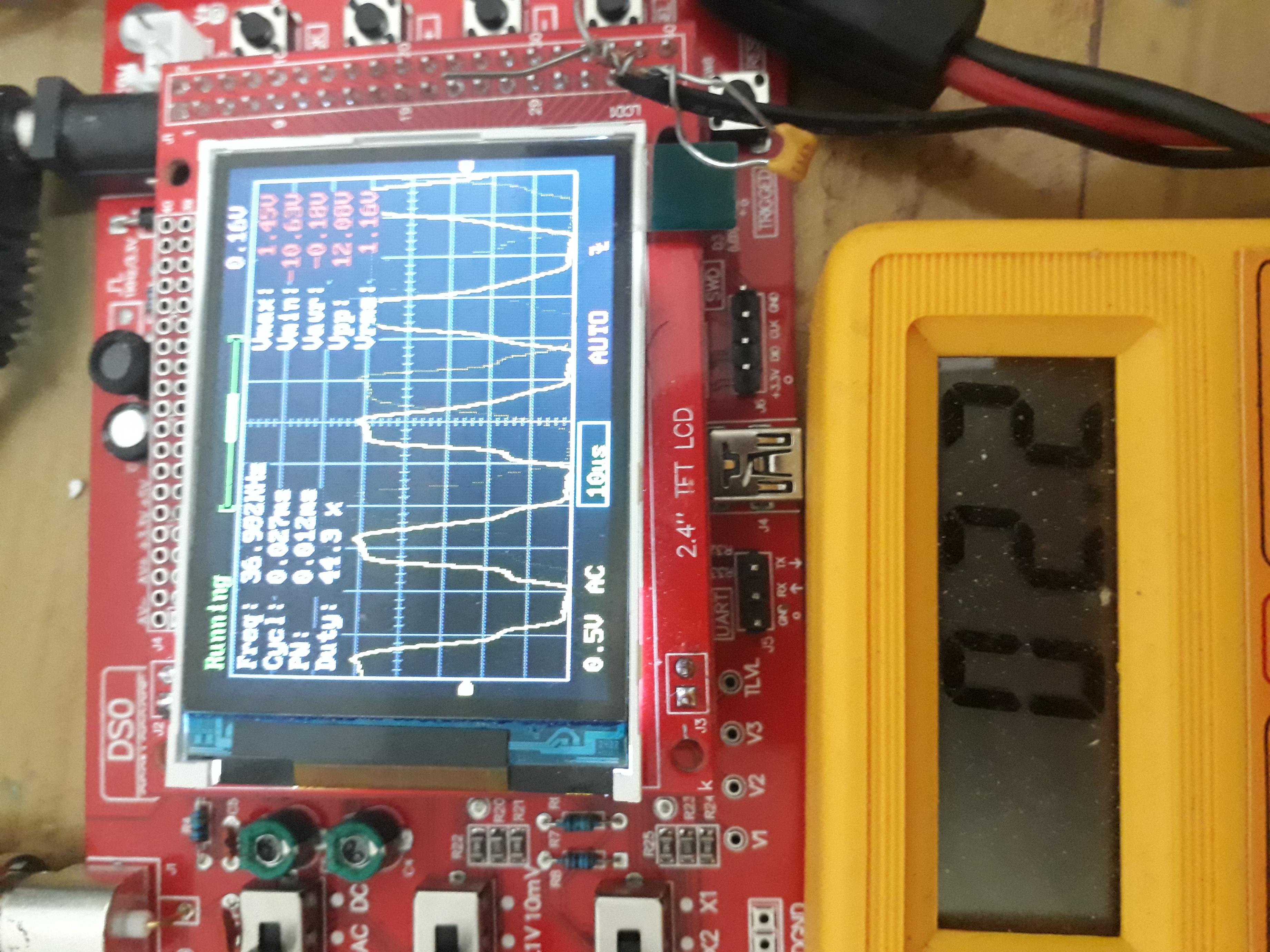

I just use mcu for making smps and i tested that
The result was good
I'll make a simple board soon
I just have a problem about gate driver
As you know when mcu work with 5volt and that pwm have 48% dtc,output is about 2.2volt.(like result of my test)
I try to use tc4427 as push pull gate driver but it need 2.4v(min input signal's voltage) to work
Now i don't know it can work with 2.2Vac or not
You know?

Drive a high speed open collector comparator to boost the drive voltage.
The amplitude of the signal at 48% isn't 2.2v. If it reads 2.2 with a multimeter, it's likely very near 5v in amplitude.
Rockford drives their TC4420 drivers with a 3v signal (ground to 3v).
The internal diagrams are sometimes misleading but it appears that the inputs are simply FETs. If you can reach the threshold for that FET (5v amplitude will), the driver will switch.
