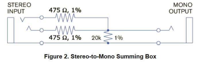

100k is way too high, that will completely attenuate the signal. Something like 100 ohms will be a nice balance of attenuation, op amp protection, and noise considerations.
EDIT: If you have to buy a cable, then just a Y cable should work. It is pretty simple to make a cable with series R, since a single resistor will easily fit inside the connector hood.

That's easy enough to do, but instead of buying a prepared splitter cable obtain three RCA phono plugs and a length of twin screened cable.
Solder a (physically small) 1K resistor to the centre pin of each of the stereo pair of RCA plugs.
Connect the signal wires in the twin screened cable to the free ends of the resistors.
At the mono RCA plug end connect the left and right signal wires together at the plug's centre pin.
Connect the screen wires that come from each of the stereo RCAs together at the barrel of the mono RCA plug.
(If you should experience a hum, disconnect one of those screen wires.)
P.S. Choose thin twin screened cable. Thick cable may not fit into the single (mono) RCA plug.
I believe the inclusion of a large value resistor (10 K) between the junction of the 1 K resistors and ground is intended to increase the level of the signal available at the mono output.
I have found the convertor circuit to work satisfactorily without this resistor. However it is easy to include it in my instructions in post #7. Just connect it straight across the terminals of the single (mono) RCA plug.

You may believe what you like, but it will certainly have the opposite effect.I believe the inclusion of a large value resistor (10 K) between the junction of the 1 K resistors and ground is intended to increase the level of the signal available at the mono output.
What I actually read was that the larger this resistance (up to 50k), the more available signal at the output.
However, I suppose that is wrong as well!

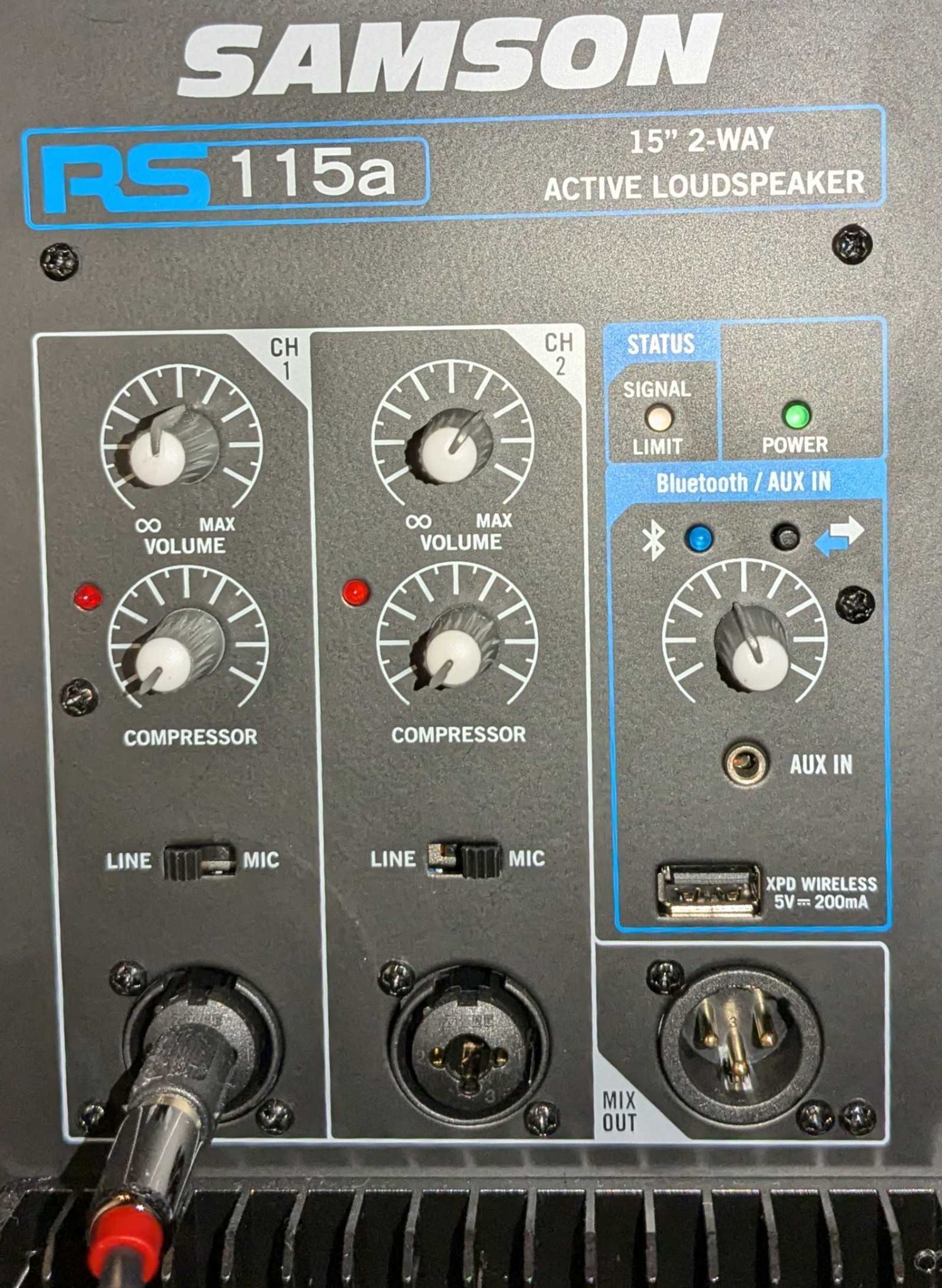

A good point, I should have been more specific. There are other inputs, it's just none of them are stereo, except, possibly, bluetooth.What kind of PA speaker only has a single RCA input? It should XLR inputs or at least 1/4" TS inputs.
In case there are more inputs available on the speaker the simple solution you may have overlooked is to just connect both mixer outputs to the speaker and let it do all the summing.
My speaker is a single Samson RS115A. It has RCA, XLR, 1/4", and BT, I just was not sure if that would help. Good point on the bigger size of XLR and even 1/4" though!
So, here is the porn shot of the back side of the speaker with all its hookups... Actually, now that I am looking at it, I feel stupid: there is an AUX IN in the BT box right there, it is probably stereo...
