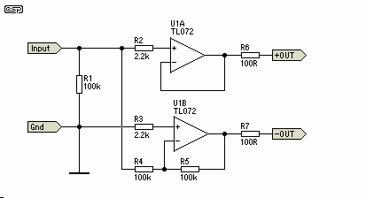

The usual way of bridging is inverting one input channel and connecting the - on secondary together. connecting speakers to the positive speaker conection one channel inverted now acting as -

here is a simple bridge adapter.

Best way to get optimum power for your mono 8 ohm speaker is to sum the 2 stereo signals to mono, then invert one signal and run the amp in bridge with the 4 ohm taps.

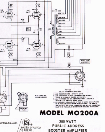

That is exactly what Bogen did with their MO200, which is a dual 100W amp on one chassis.
All secondaries are connected in parallel.
Look it up.
Here is the critical detail.
In which case all the 16ohm taps become 8, and 8ohm become 4. (if you have them)

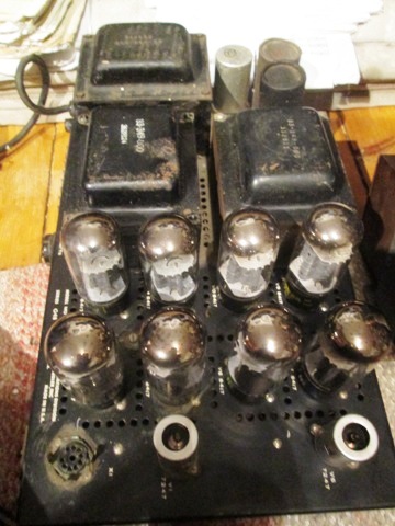

I will do the same with my new stereo PPP 50W amp in order to be able to run it as a 100W guitar amp when needed.
It becomes like ONE single channel amp with 2 quads of output valves in that case (8).

Single input but with 2 phono inputs paralleled.
They go to 2 seperate AF amp and driver stages, then 2 seperate amp channels and 2 seperate output transformers which are then paralleled.
The thing knocks out a guaranteed 200W RMS no problems at all. although not quite down to the claimed 8hz from the factory originally.
Once modified it's a distortion free 220W RMS, but of course most people prefer (like me) to seperate the 2 channels and turn it into one almighty great kick-A 100W per channel amp.
They are starting to get rare and expensive suddenly even in OEM PA shape.
It's the most compact 200W industrial valve amp ever made, & was used to power shaker tables.
The compactness of course make it a pretty big nightmare to work on, but we do manage it (eventually!).
I reckon it's one of the best classic amps of the 60s, easily outshining anything from Mac, Dynaco, and right up there with the "magic" sound beasties you can't find anywhere today.
(We tested it in a shop, back to back against "the best" and there is nothing like it in the "hi end" production that matches it)
Well, the Bogen 200 is a dual mono amp, so both channels get the same signal.
But the OP wants to input different signals (stereo) to the two channels and then parallel the outputs.
Doesn't that make a difference ?
