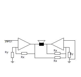

You can bridge any amplifier with differential input using only a resistor. The resistor is from one output to the differential of the other amplifier. I think on ESP there is some examples.

Can you show me a diagram? It's fine even drawn by hand.You can bridge any amplifier with differential input using only a resistor. The resistor is from one output to the differential of the other amplifier. I think on ESP there is some examples.
Here is a practical example. The output of the master amp is fed via a 33K resistor to the inverted input of the slave amp, while the slave amp's input is shorted to ground. The master and slave amp are identical.
In short, the output of the master amp is fed through the same resistor value as is in the normal feedback path. This is a very simple way of achieving a bridged amp, and many commercial amps get away with a simple bridged/non-bridged switch on the back of the amp. I am not sure but think that Bryston did it this way as well. You can also find an example of this method in ESP's website.

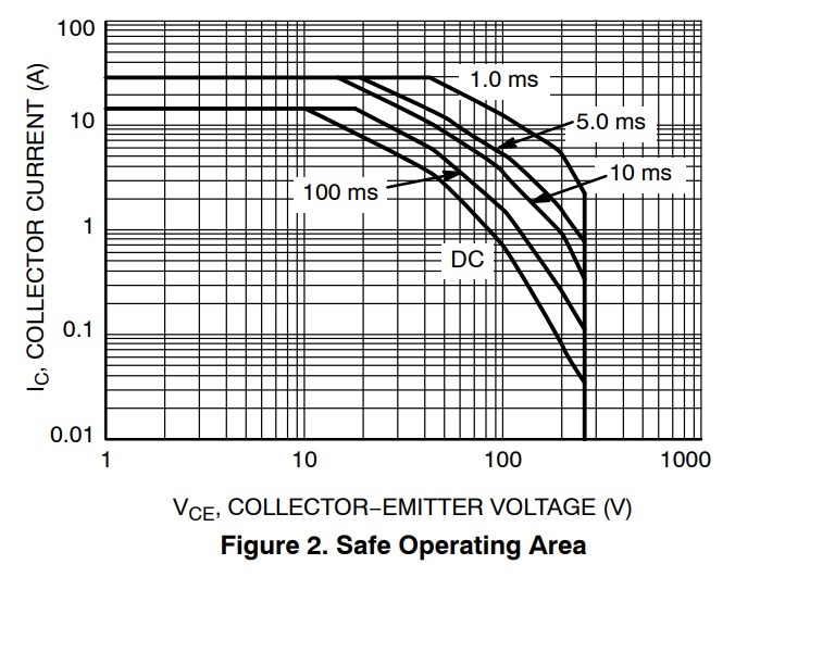

Take what Ostripper says above seriously. The amplifier has to have the capability to run the higher current, else you will simply fry them.

A diagram of the same. The output across the speaker would be twice that of normal operation since they run out of phase, and therefore the power would 4x that of the stereo amplifier.

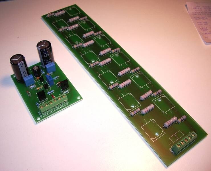

There may have been some tweaks over the years, but attached is the original schematic. There is really no need to bridge this amplifier, it was just something interesting that was asked on this forum many years ago. I tried it, it worked and that was it, been there done it.
Before anyone comments that I should have done this or that, I am not revisiting something that has been archived since 2010, and I happen to have the data at hand on an old CD and just shared it for interest’s sake.
