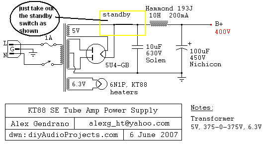

hey i have scrounged together all my parts now ... i was going to go with the jensen signal caps but the kimbers are cheaper so i just ordered those from parts express.. I am starting to make some layout considerations and would really like to have the tubes forward. Normally I know that the mains tranny sits comfortably between the output trannys' but with the choke and huge capacitors I am not quite sure what to do. I will post some pictures of layouts that I am sketching up as soon as I get the time. If anyone has photo's of their finished se kt88 amp that they can post links to that would be greatly appreciated. I know a lot of people have this amp built. Maybe I can just copy someone else's layout.
Last big question. Is there a way to make it so I don't have a standby switch? What needs to happen so I can get by without one. I assume it is mostly related to capacitor voltage ratings but what should they be? I would like to have a simple lone power switch if possible.
thanks guys![/QUOTE]
as i understand STANDBY is so you can let the filament heat up before you apply power to the plate. you dont need it than just take it out.

hoerath7, I am deciding against a standby switch since it's going to be overkill in that the rectifier tube will have an inherent "soft start" as the filaments heat up in the start up cycle before it goes to the amplifier tubes.
