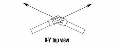

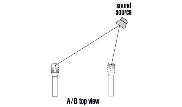

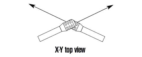

The stereo effect depends on (a) the difference in time of arrival at the two microphones, and, (b) the difference in frequency balance picked up by the two microphones.
Compared to recording with microphones facing straight ahead but separated (A/B), recording with microphones angled to each other but with capsules coincident (X/Y) will have less stereo width.
The reason for this is that since the angled microphones are positioned at the same point in space there will be no differences in timing. The entire stereo effect is created from the differences in frequency balance.
