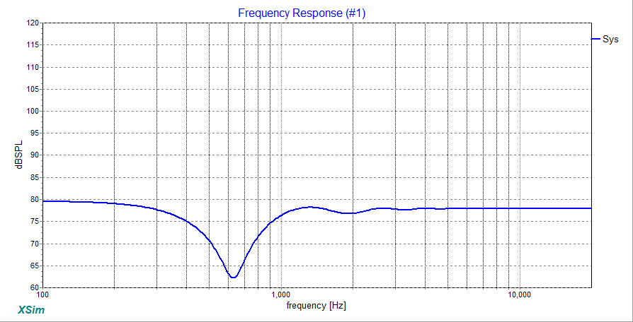

With a cross point around 500 Hz, I would be concerned about off-axis performance given your suggested driver spacing. For an application like this, I would normally try to maintain even off-axis response since people are more likely to be way off axis with TV viewing or background listening. If your listening positions are only directly in front the speaker, this may be less important to you though.
Just a rough model using one side driver and the woofer, but at 500 Hz 12 dB/octave cross and 19.5 inches of horizontal driver spacing, at 20° off axis horizontally you are looking at something like this:
How it all combines in real life when both left and right are playing along with the woofer is harder to predict, since it would vary based on where something is in the soundstage.

If I understood you well, the pretty high crossover, lets say at 500Hz and the spacing will be the cause of that dip at ~630Hz @ 20 degrees hor?

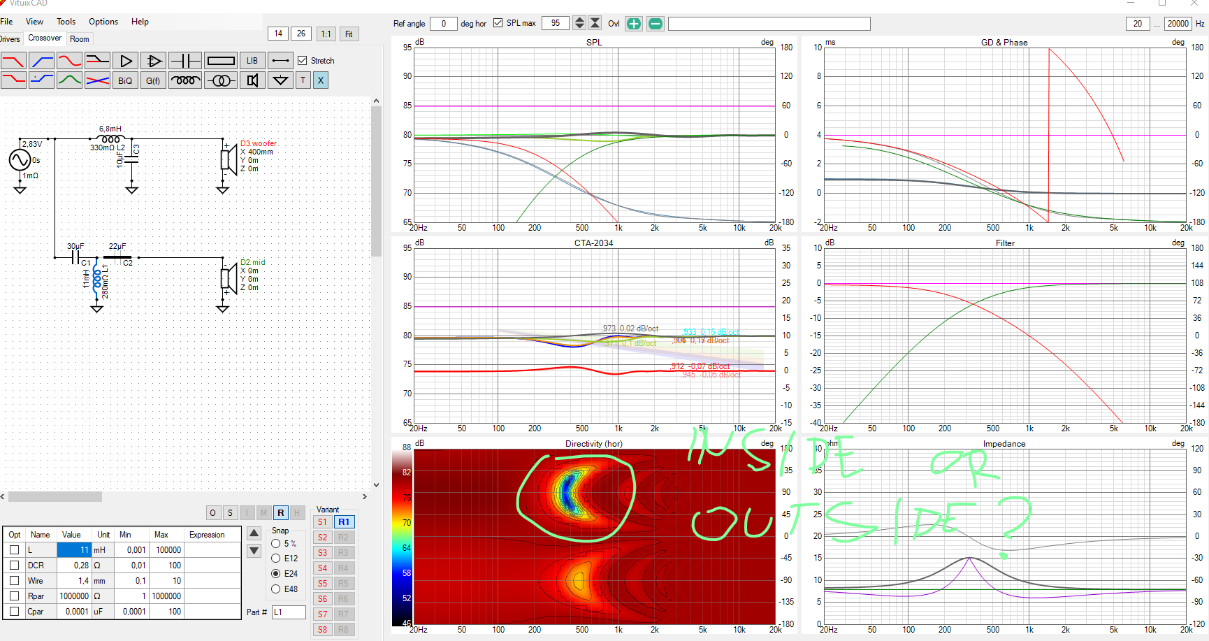

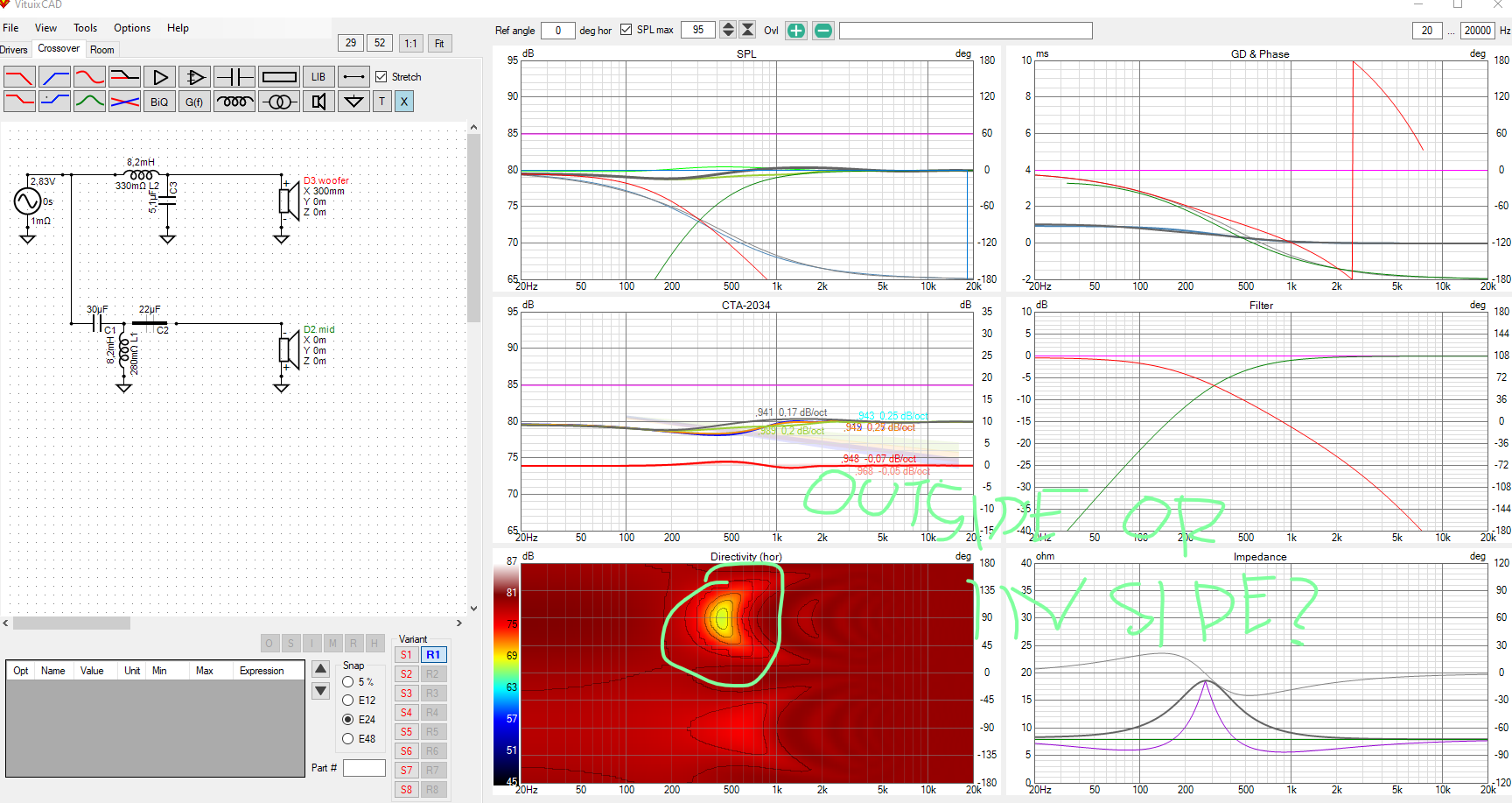

Ok, I tried to sim this quick n dirty. Now more questions, than answers.
With 300mm X spacing between woofer to mid c-c, everything seems manageable, crossover at ~300Hz, that bump on 1khz is BSC, so do not care for now.
With 400 mm and ~350Hz crossover it gets uglier:
The main question is if that anomaly on ~500Hz is inside the listening space or outside???
300mm c-c it is not much uglier than some reviews on ASR.
I would like to experiment of this one, but the drivers are expensive, and I will have no use for 8+8Ohm DVC woofer if this will not work.
Yes. It's fallout from the varying distance to each driver as you move off axis. Typical suggestion is to keep drivers at 1/4 wavelength spacing at the cross point (or under) if you want good off-axis behavior. This often can't be done in practice, so most designs have some amount of trouble along the axis where the drivers have spacing. This is normally the vertical axis, so in reviews there's often a restricted range on that axis and much worse performance than horizontal. Since you've flipped spacing to horizontal, that's your trouble axis.the pretty high crossover, lets say at 500Hz and the spacing will be the cause of that dip at ~630Hz @ 20 degrees hor?
You can mock up your design with other drivers if you have some handy. It doesn't have to be with the final ones or even with a dual-voice coil driver. You can use a summed signal for the woofer if you have an extra amp channel handy and some other parts around.
It does not look asymmetric, it is 2nd order both of them. Or is it asymmetric because of the actual tweeter slopes are more aggressive?It will happen on both sides of the pair. The reason it looks better on one side is mostly because of your asymmetric crossover.

I was looking at the separation in phase.It does not look asymmetric,
That is not a bad thing. You can use it to advantage 😉
...it is hard for me to admit, but I still do not know how to read and what to expect from phase charts, but I do understand what the wave phase is...I was looking at the separation in phase.
In this case one being ahead of the other gets them to meet up more to the right or left. You can wave your mic in front of them and find the peak, then tilt it on the simulator by offsetting the crossover a little at a time.
You are talking about Z depth? In that case difference in Z has to be substantial to have some influence.In this case one being ahead of the other gets them to meet up more to the right or left. You can wave your mic in front of them and find the peak, then tilt it on the simulator by offsetting the crossover a little at a time.
Understood.Consider that if one is out by a quarter of a wavelength at 500Hz, it will have to travel 17cm further than the other to be in phase.
But what I see that in my quick sim everything seems to be ok with phase
Why don't you try delaying in vituixcad to change the phase alignment. The polar map has a sudden colour change which looks worse than it is.
Thanx - I will when have some time. But just as the study. In the production I don't want to be dependent on delay, as this is passive design. Active is too expensive for me and I have some amp boxes around.Why don't you try delaying in vituixcad to change the phase alignment. The polar map has a sudden colour change which looks worse than it is.
