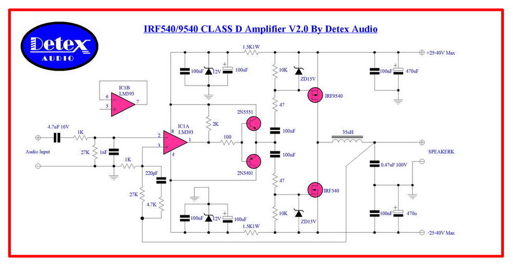

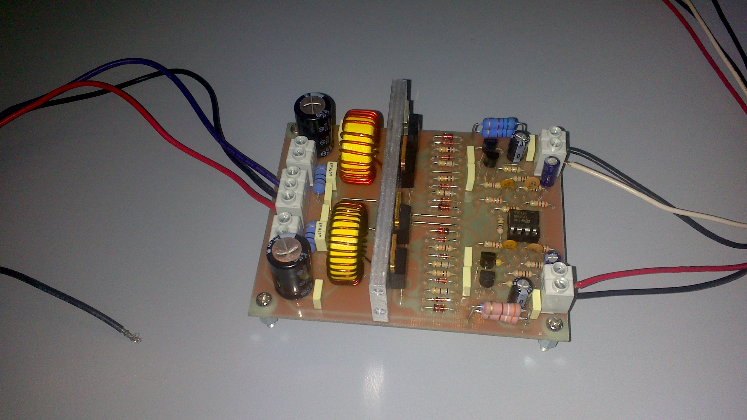

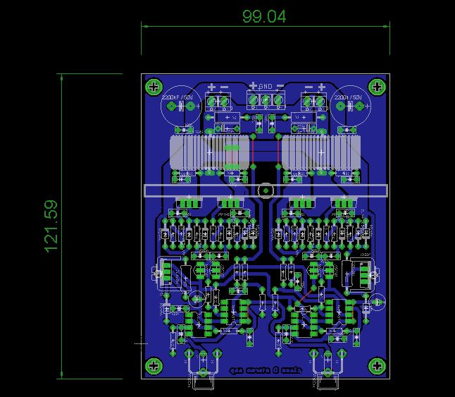

hi to all.
i found this schematic on internet
and i made a stereo amplifier with the eagle cad
this is the pdf file for realize it!
View attachment schematic.pdf
View attachment Top.pdf
View attachment bottom.pdf

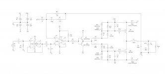

I think the only solution is to use two n-channel mosfet, but the circuit should be modified to use an IR2110 .... this version uses complementary pairs
May be you will never encounter MOSFETs blowing up on power turn on - provided your power supply voltage does not rise too fast.
For that reason these kind of capacitive coupled PMOS/NMOS amps have a bad reputation of easily burning up, beeing more sensitive with higher supply voltage.
