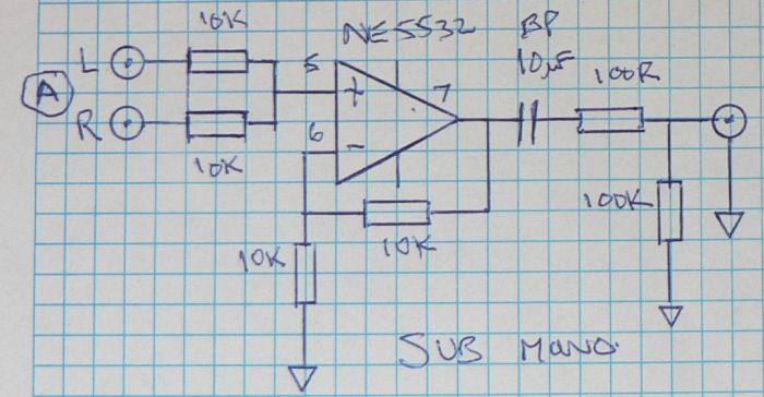

The kit is a C-Note bookshelf speaker (stereo) and the Amp is a Dayton Audio KAB250v3. So the amp has 2 sets of speaker leads, but I will only be using one tweeter and woofer. I have built the crossovers, but want to know how to wire the speaker from the Amp without causing any amp damage. Should I just pair the -ves together and do the same with the +ves or do I need to build a stereo/mono converter? thanks! Tom

I thought the TPA3116 had to have a speaker load on both outputs so best to wire 1 channel to the tweeter via it's HP xo and the other to the woofer via it's LP xo.
You'd have to mix the stereo to mono on the input but that wouldn't work for the on board Bluetooth which would be stereo which means the sound to the tweeter and woofer would be coming from opposite channels. I wouldn't think you could mix the Bluetooth signal to mono on board.

The Bluetooth would be stereo, i.e. left and right channel. The only way to get mono out of it is to have mono from the source. There's no way I know to get mono from the stereo power amp output.
Of course you could find the Bluetooth output on the module and cut and shut to add mixing at line level but very risky as it's all SMD components.
For analogue in it's easy and only requires two 10K resistor with one on each channel input and then joined after the resistor. You do lose 6 dB so may need a gain stage after it. See these resistors at point A to 5 on the attached circuit.
