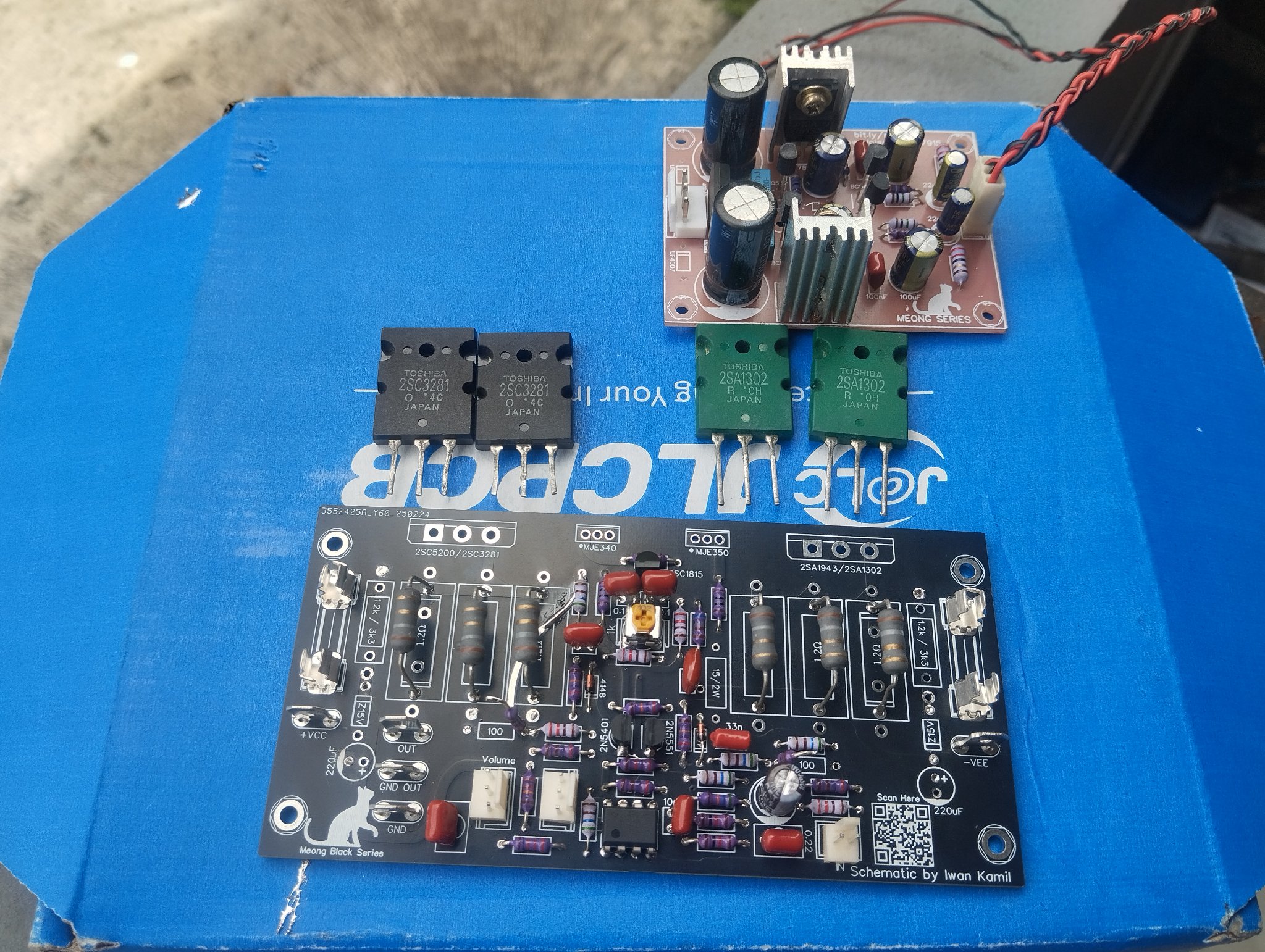

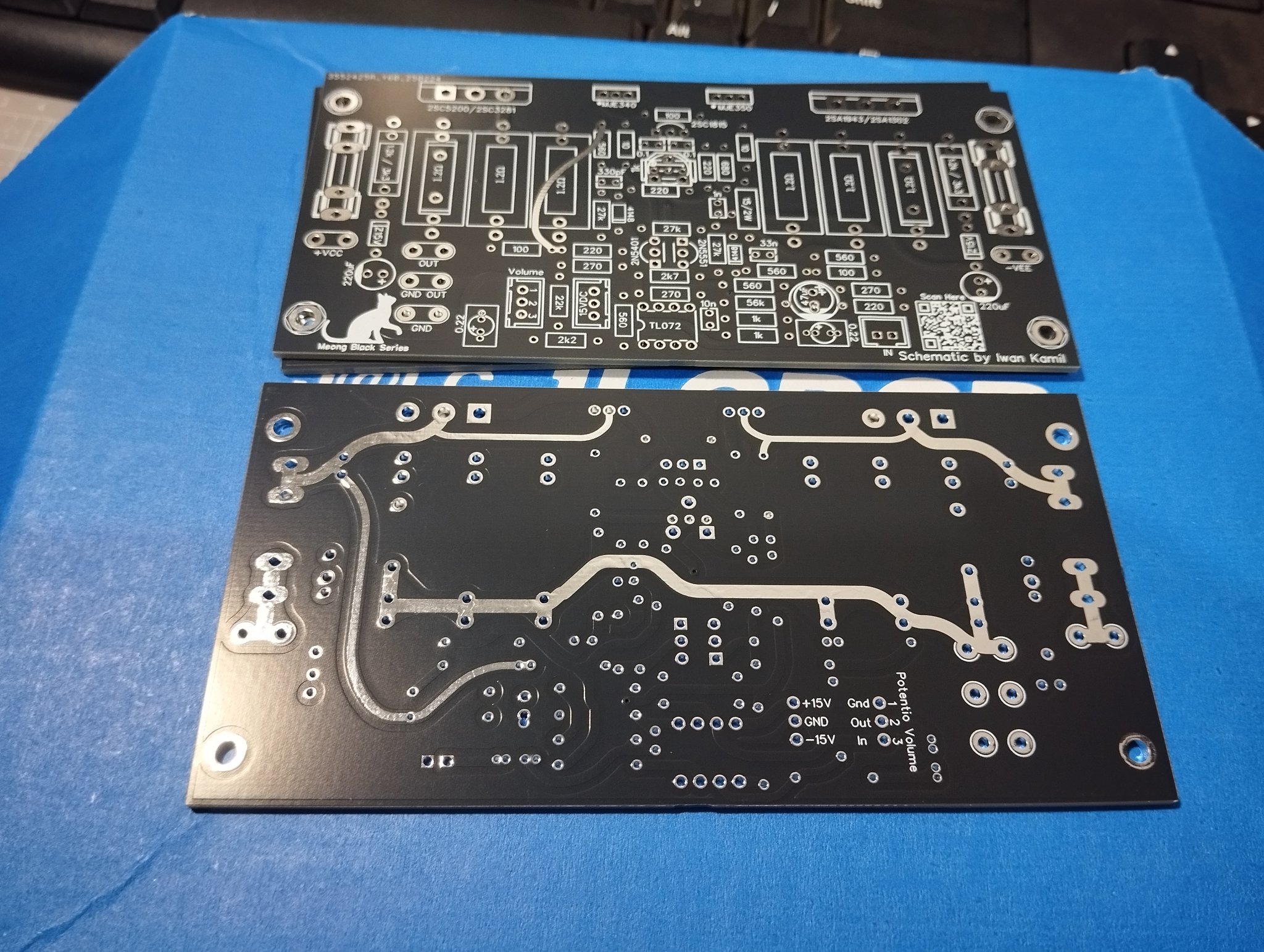

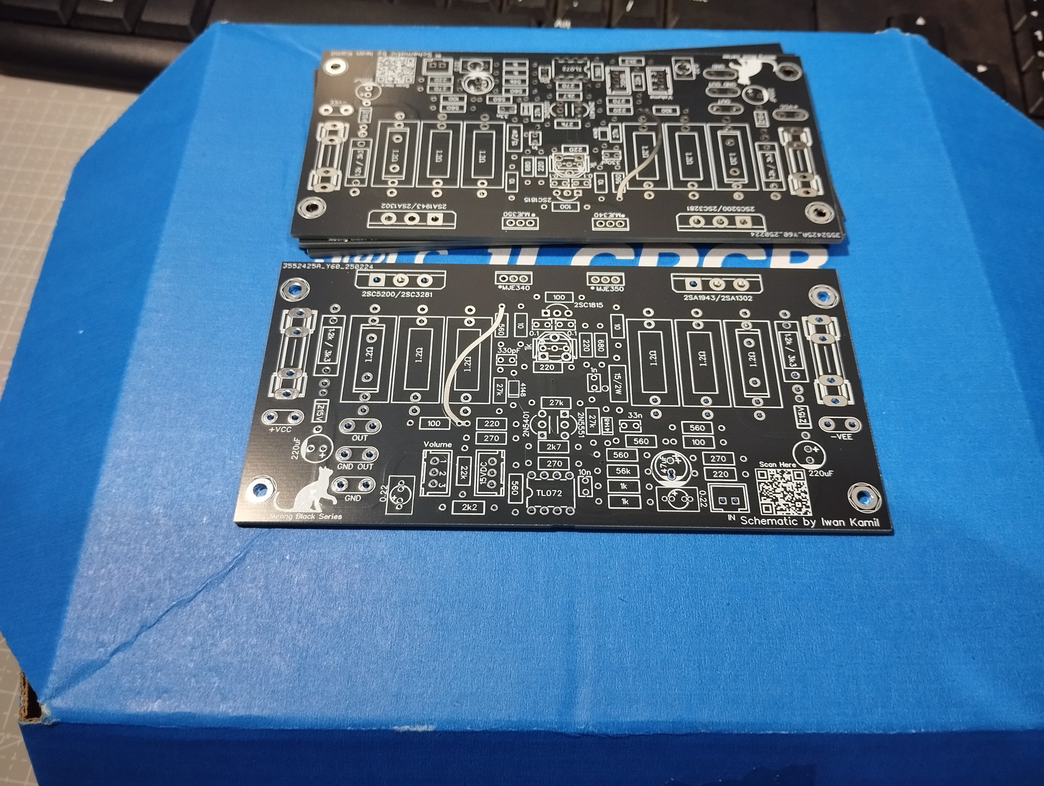

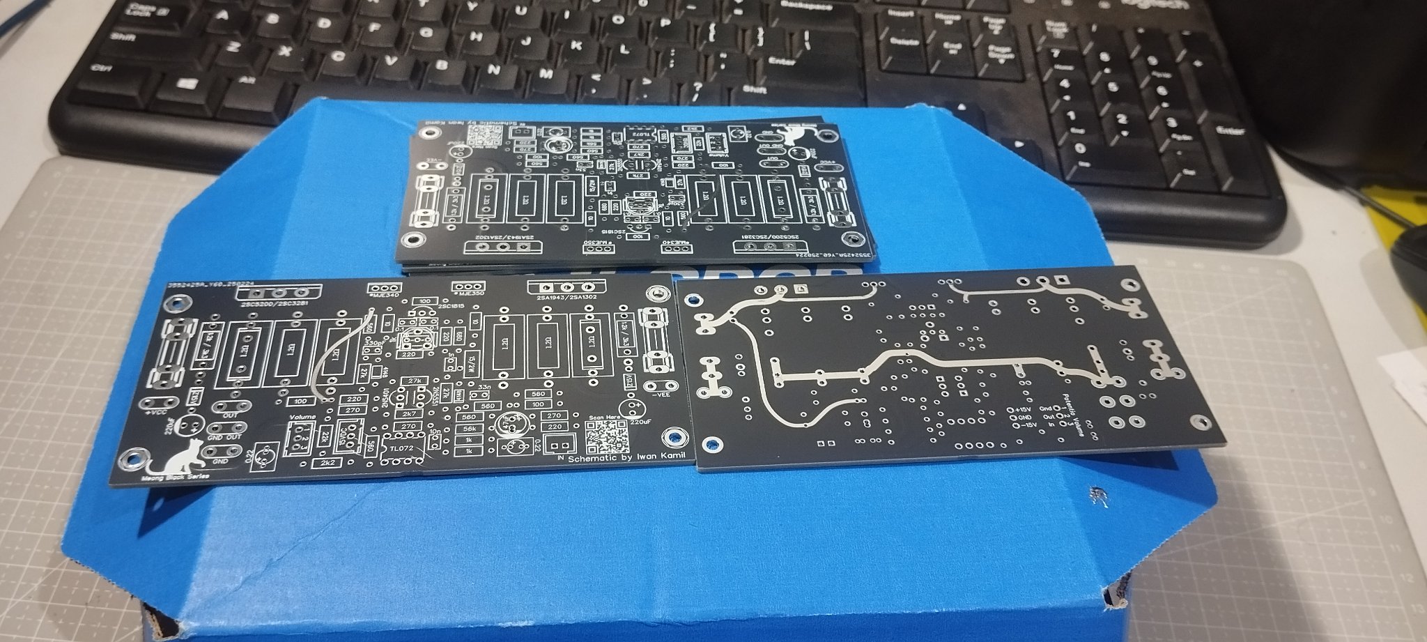

I want to share the amplifier schematic designed by Mr. Iwan Kamil. Hopefully, you like it 🙏.
According to Mr. Iwan Kamil, this schematic shows a "Stereo Amp Full Range 80 Hz—5.5 KHz" equipped with a bandpass and bias control set. Those who follow Mr. Iwan Kamil on social media (Facebook) must be familiar with the functions of these components. See the schematic in pdf no. 1.
Maybe some people think that this schematic is simple, just an ordinary OCL. However, for me, this schematic is very authentic. Each circuit has its own uniqueness. Please share with your friends to be creative with this schematic.
For the op-amp supply, you can refer to Mr. Iwan Kamil's tutorial on "Super Low Noise DC Supply" or use the references I have attached. see picture No. 5.
For capacitors C1 and C3, it is better to use tantalum or other types of good quality so that the signal is more linear. Resistors R15, R16, R27, and R28 can be replaced with 220 Ohm if using a 24 VAC CT supply.

thanks for the suggestion, if you think it's unsuitable that's okay. you can open the explanation on the YouTube link that I provided. this scheme is only half of the overall design. the design is made for design 2.1. and why did I write 80hz-5.5khz? because the creator of this scheme said so, I respect the designer or creator of this scheme even though I'm not sure that this really works in the 80-5.5khz range. thanks"Stereo Amp Full Range 80 Hz—5.5 KHz" .
Note that this is (for some reason) a very narrow bandwidth amp with filtering to exlude anything below 85Hz or above 5.5kHz.
It is unsuitable for any normal home stereo use.

I would be interested why the designer deliberately limited the frequency range to roughly voice only.
There is filtering in the amp to obtain this. If you remove the filtering you have a nice wideband audio amplifier useable for hifi.
So why would the designer do this? He is obviously not stupid so what was his aim?

It is "full range" only if you exclusively listen to AM radio, but then, why stereo?
A pretty standard opamp based power amp combined with a bandpass filter and an absurd title. And some little added weirdness like electrolytic caps bypassed with equal value non polar caps or the extreme voltage gain.
A PA amp perhaps?
A PA amp perhaps?

I actually don't fully agree, because the scheme has been simulated by our friends in the local group, but we will never know before trying it directly and listening to it directly. I will update the progress and I will inform you here as it is according to what I practice.
