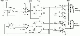

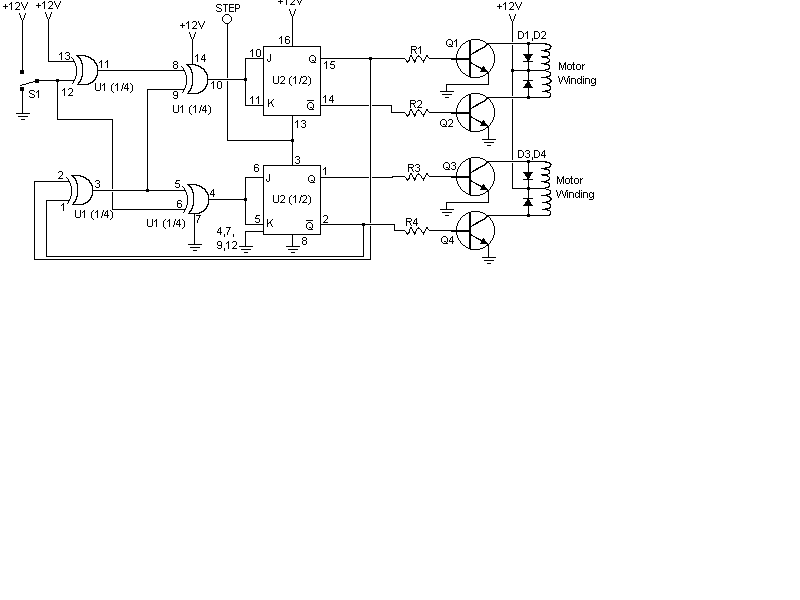

Steppers are not difficult to drive, but how depends on the job.
The steppers will drive threaded rods. Total travel is about 100mm (50 revolutions). With gas strut assist the torque reqd is within the range of $15 motors.

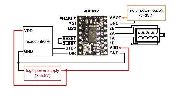

Lots of controllers on eBay but with no explanation
found this one Pololu/StepStick Stepper Motor Driver (RepRap RAMPS/Sanguinololu) | eBay
With this diagram.
Do you think I can replace the microcontroller with switches to simply supply 5V to the step and direction pins to make the motor go? or is the microcontroller supplying a complex control signal?
edit: oops just read the advert! I didn't see all the instructions before. Needs a pulse on the step pin.

Virtually all roads will lead to a microcontroller, though hardware logic/stepper motor ICs might do this job since it doesn't appear overly complicated.
TBH you really don't seem to have a clue, and its 25 years
since I looked at this stuff but just looking at that diagram
a couple of things are obvious to me :
1) logic 1 or 0 on DIR controls step direction.
2) The motor will step 1 step on a logic transition 0 to 1
on STEP. It doesn't do anything 1 back to 0 and will
step a further 1 step on the next 0 to 1 transition.
For what you want the controller doesn't have to be complicated.
I could build it with 25 year old technology, though programming
a very basic microcontroller is far more flexible in application.
I could do that if I had the time to learn the microcontroller.
Holding torque of the motor on each step is an issue, or not.
rgds, sreten.
