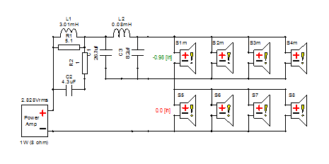

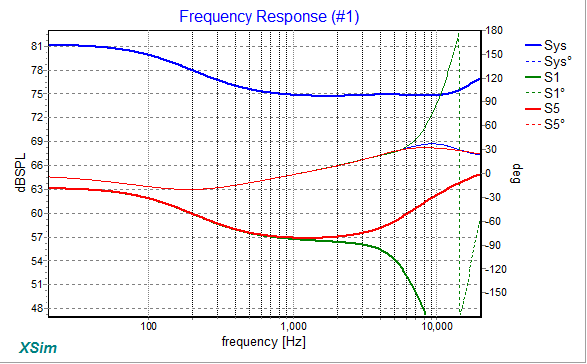

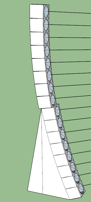

I have played around with XSim lately, and came up with a line array with a stepped baffle. Half the drivers playing fullrange, and half low passed at something like 5k hz(?).
The drivers stay in phase up to 6k hz, and at that point there's a ~7.5db diff between them.

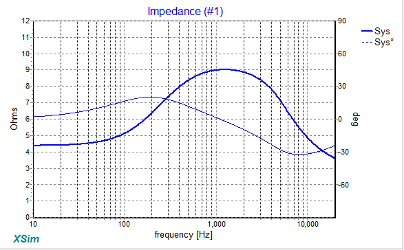

Didn't use any driver data as this is kind of just hypothetical. Used 8 drivers in the circuit just to get the right impedance.
Pros and cons of doing something like this? Time smear? Comb filtering? Smaller difference in critical distance between low and high frequencies.
(2^2 * 3000hz)/700 = 17.14m
(1^2 * 12000hz)/700 = 17.14m

Hi, M8e, i do not understand the circuit, cannot see, where lines knot and where they only cross. Anyway, it seems, that thy plan becomes right, if thou exchange the step for a ramp, say use filters of first order. This is used, see CBT and Krassolito! As we are in a digital forum, i should also mention Horbach-Keele, which also has a symmetrical driver arrangement but uses finite-impulse-response filtering.
There is no crossing lines in the circuit.
C1, L2 and C3 is a series 3rd-ish order low pass adjusted to phase match as far as possible(or at least match by a few degrees.) But then do "whatever". As it's series circuit there is no 0.5 way "gain".
L1 and R1 is a BSC circuit.
C2 and R2 is to adjust the high frequency response. Really just to compensate for the weird response caused by the series low pass doing "whatever".
Not really sure what you mean with a ramp. But I had I had in mind an focused/concave array, where the low passed drivers is offset forward. The simulation uses 0.98 inch, but that's just what I ended up with.
Usually in line arrays the bass is the only stepped part. The issue is vertical lobing.
Imagine a time-coherent/aligned 2-way speaker, with a tweeter over a woofer. As you turn the speaker, your head remains in about the same distance from the drivers as if it was in front, so there's reduced phase effects and lobing.
Turning the speaker on it's side however, and now you are only aligned with the drivers when directly in front of them. Turn the speaker one way and you are much closer to the tweeter, the other, the woofer. This problem is actually made worse by the stepped baffle.
You'll have better vertical dispersion of a line array with a tweeter and mid in the same plane. See the early Genesis towers. I hear they had terrible crossovers, but the images are sound, or the larger Nola's or the Keele line array.

@eriksquires: In case I haven't been clear. All the drivers would be the same and all off them in a vertical line(seen from the front). ie the drivers playing fullrange would be closest to ear level and the low passed drivers above/below those driver.
Thanks! A ramp has a smaller steepness than a step of a stairway. We hear frequencies and as such wavelengths continously, as broad as over one millennium and as fine as the inverse of a millennium. Wolves howl, sweeping frequency. I do not know any animal, which steps frequency, maybe a deer singing the octave overblowing. I do not understand, what thy calculations and most of their numbers, the two power equations in thy first post and the 0.98 inch, are related to.
I understand the confusion. Like, baffle step and stepped baffle could get lost in translation...
The ~1 inch is a literal step in the speakers front baffle, so the low passed driver(s) is 1 inch closer to the listener and the sound from that driver will be 74 µs (microseconds) earlier.
This compensates somewhat for the phase delay caused by the filter, so that the speakers can stay in phase up to 6000 hz. (and at that point there a something like 7-8db difference between them)

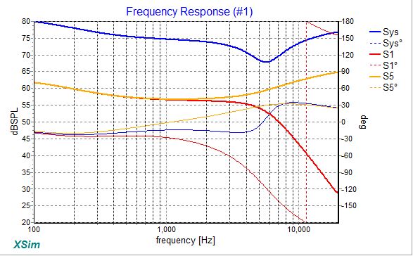

Without this step the phase response would look like this:
attachment.php
With step:
edit: Oops, different colors, and minimum frequency(10hz/100hz).

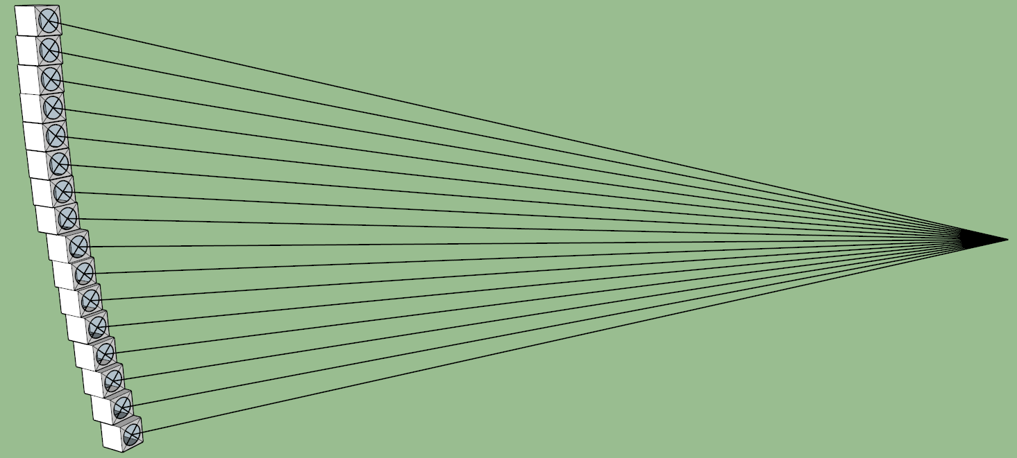

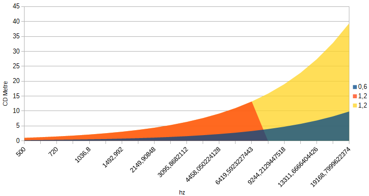

Made a graph to show what I mean with the difference in critical distance. Yellow is what would happen if all drivers played full range. Orange and blue is with the 1.5way filter.(orange low passed, blue full range)

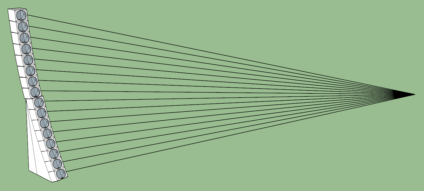

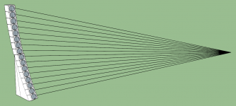

concave array
M8e,
I think your idea is definitely sane. There are several posters with experience with full range concave arrays that would say that you will end up with a very defined sweet spot...."head in a vice" listening experience. My own experience with concavity is limited to a top end of about 2500 Hz and I was left with uncertain results regarding this issue. But of course you are not going full range for the entire array.
I am not sure I understand what you mean by critical distance. Please define it.
I'm not sure if it's actually the right name for it.
It's the (theoretical) distance from the line where it stops working like a line source(horizontal dispersion, 3dB drop off doubling the distance) and instead starts to spread like a point source.(horizontal+vertical dispersion and 6 db drop off doubling the distance.)
But that's asuming a perfect line source and no walls/reflective surfaces, et.c...
What if one pointed the drivers horizontally instead of towards the focal point. Would that be less "vice"? Or make the array curved with an ~3 meter radius put pointing the drivers at an focal point at something like 6 meters?

OK "critical distance" is the near/far field transition point.
I didn't' worry about pointing the drivers as off axis response was not a concern at 2500 Hz. Since you are not going full range for all drivers you may not need to worry about that.
I would not make the focal point the same as the listening position. I tried 0.5x the focal point as you have suggested.

Focused array is an excellent option, so long as you are beyond the focus point.
Small drivers, no whizzers, less distortion, more volume, no phase problems.
Above, below, and beyond focus was still very good, just not the best.
I was surprised that the image was only as tall as the 3 middle drivers.
Best thing i've ever had.
I just wasn't using it right and was into way louder volumes and music a few years ago.
I had a 9 x 4" array concave.
Wide dispersion of a 4" yet cone area of a 12".
Expensive and difficult to make, but worth it if you are into full range drivers.
