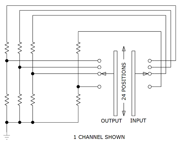

I'm pretty sure that ebay item in the first post is a ladder type 2-channel stepped attenuator. only two resistors per channel are involved to form an attenuator at any given position, that's why a 4-pole switch. I had one of these myself. The Chinese made 4x24 switch has a crappy detention feel that's hard and bumpy throughout the range, and the travel from step to step is somehow slightly unevenly spaced. The positive side is it does what it should quite well. The switch has make-before-break contact transition so the stage that follows it does not get its input open-circuited.

Nattawa:
Thanks for that diagram- it explains how the 4-pole switch is wired for 2 channels. I have a couple of those in my parts collection which I bought but never used - I really prefer the 'continuous adjustment' of a pot, but I know they don't track as accurately as a good stepped attenuator.
DIY-ing one of those switches (to get a 4-gang equivalent if needed) isn't my idea of fun, but one never knows what the future may hold!
