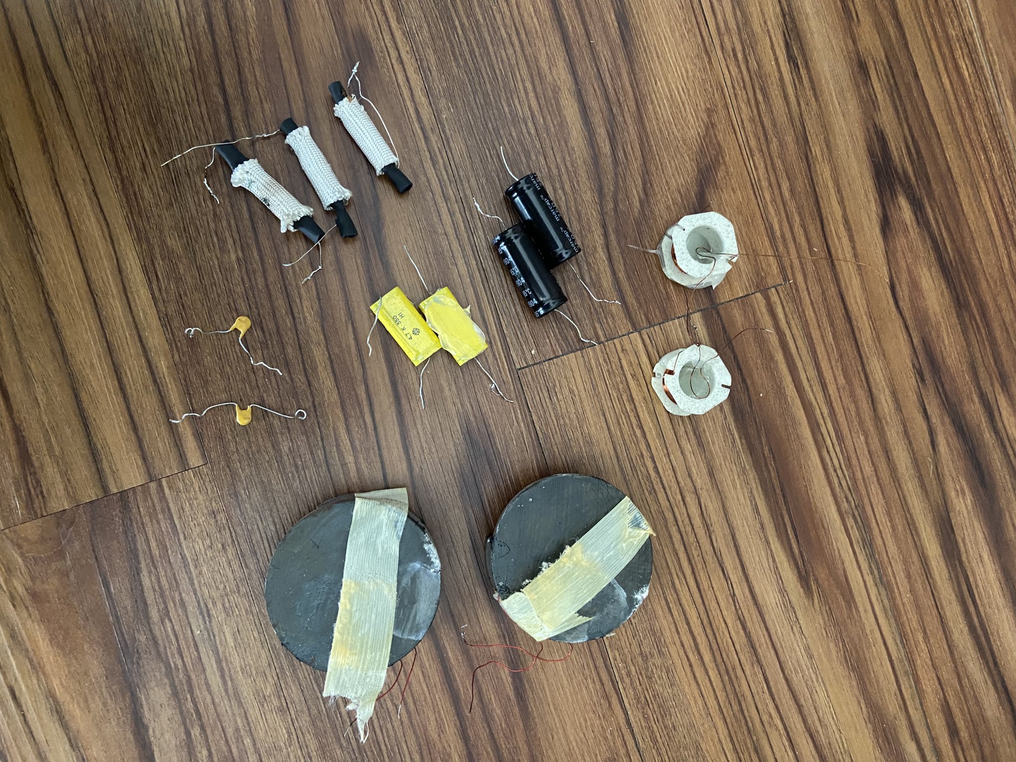

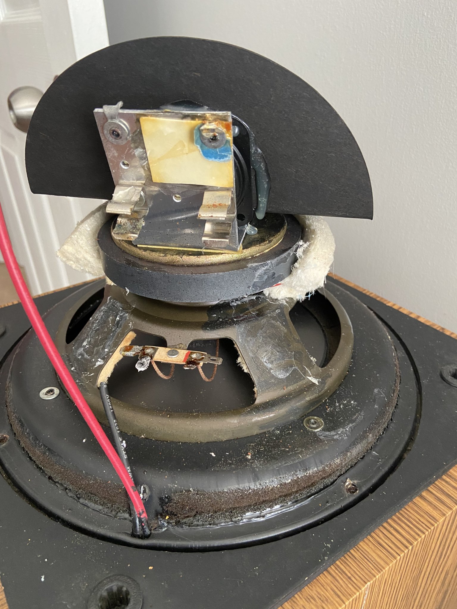

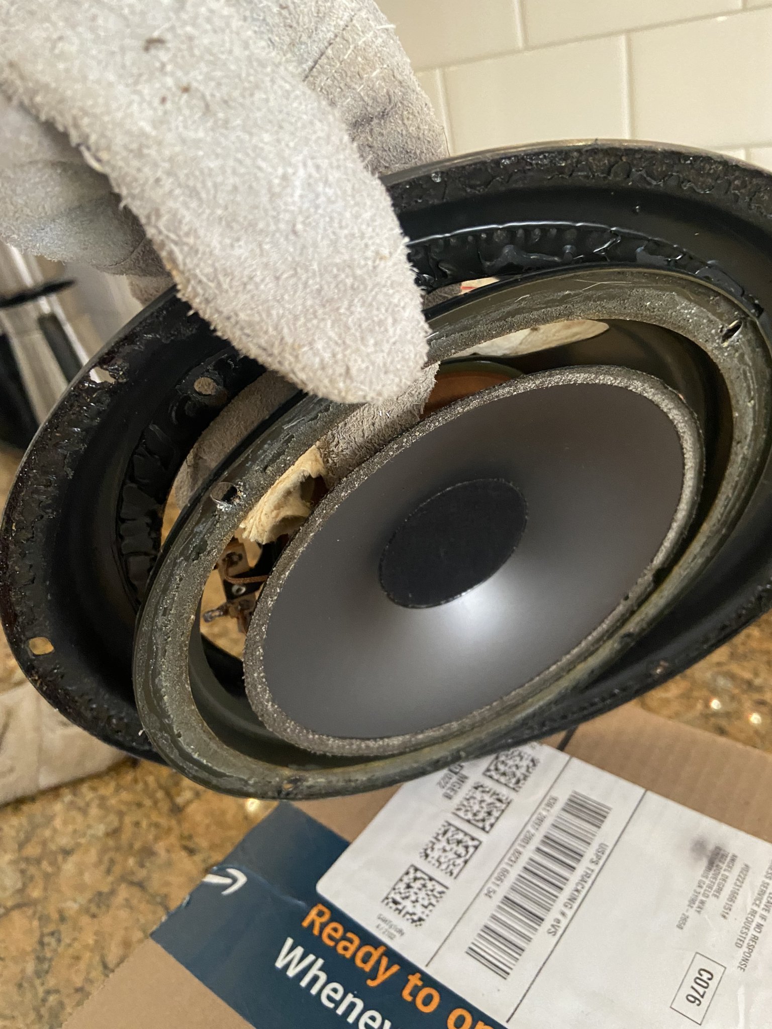

Removed all old xover parts. Woofers measure 4 ohms. One tweeter is 3.5. The other is 3.7.

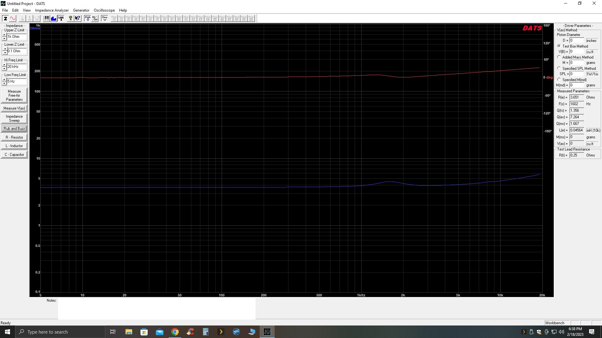

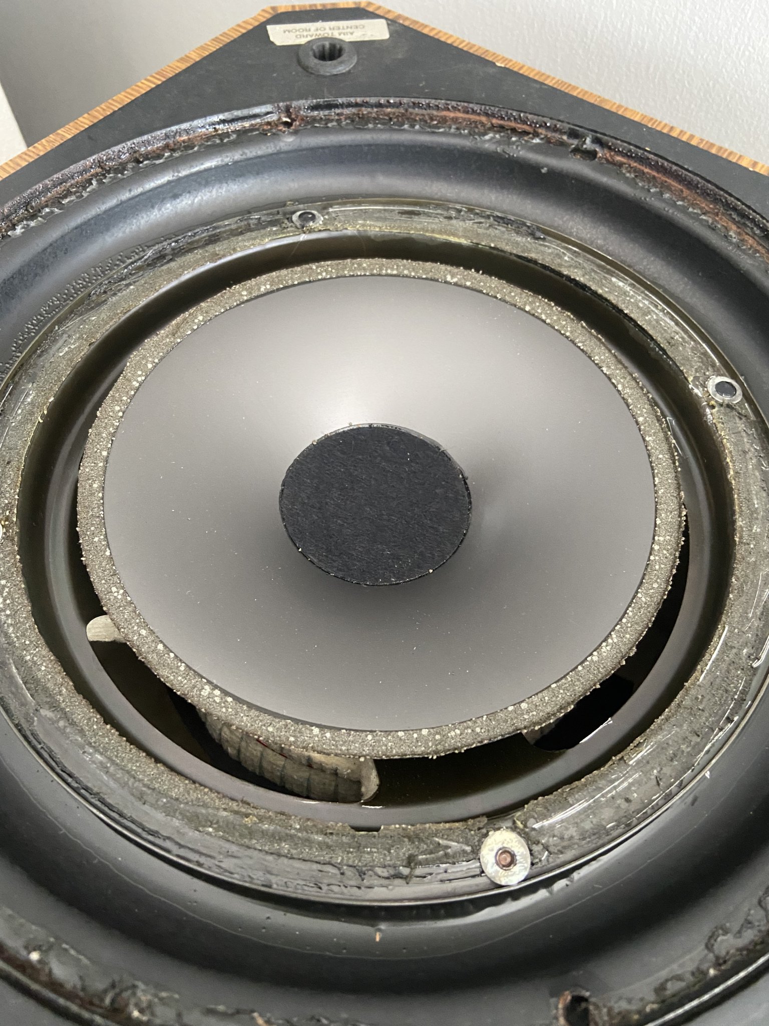

I'll run the DATS software on them once I've replaced the surrounds on the woofers which are disintegrated.
https://www.daytonaudio.com/product/1051/dats-v2-dayton-audio-test-system-discontinued

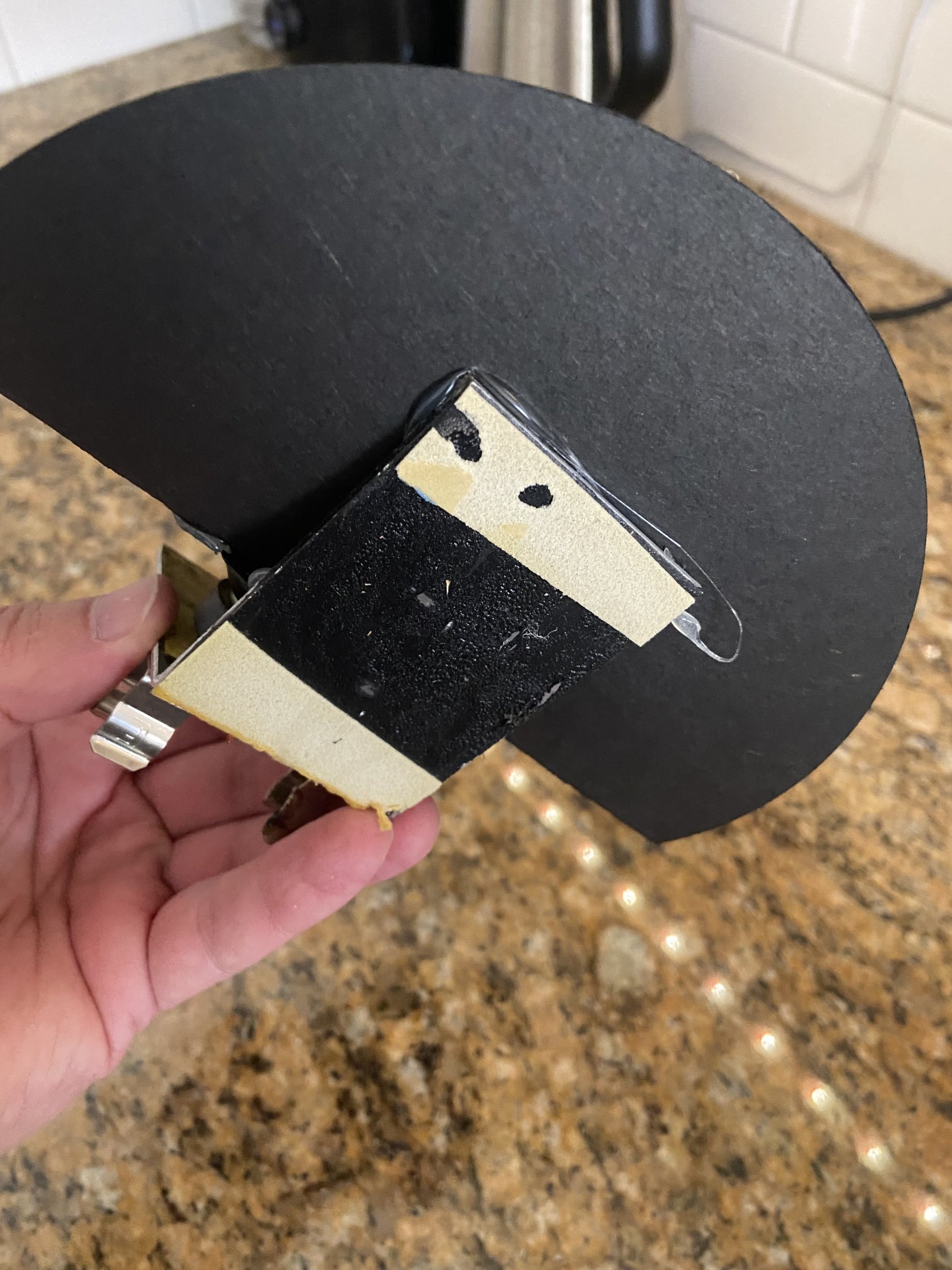

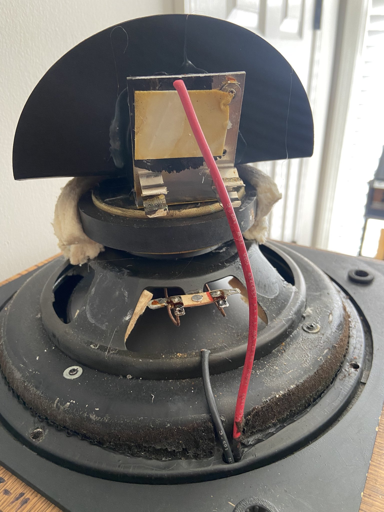

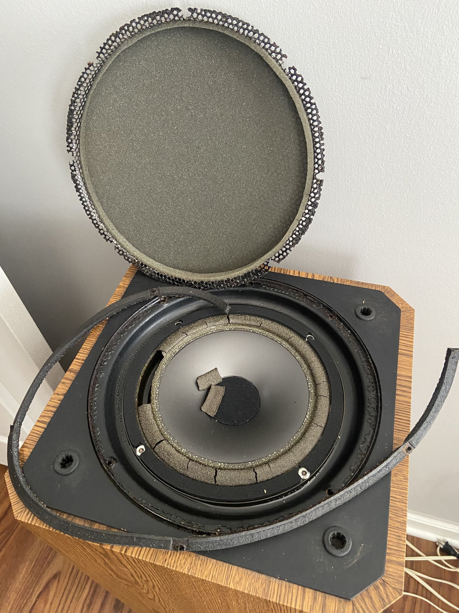

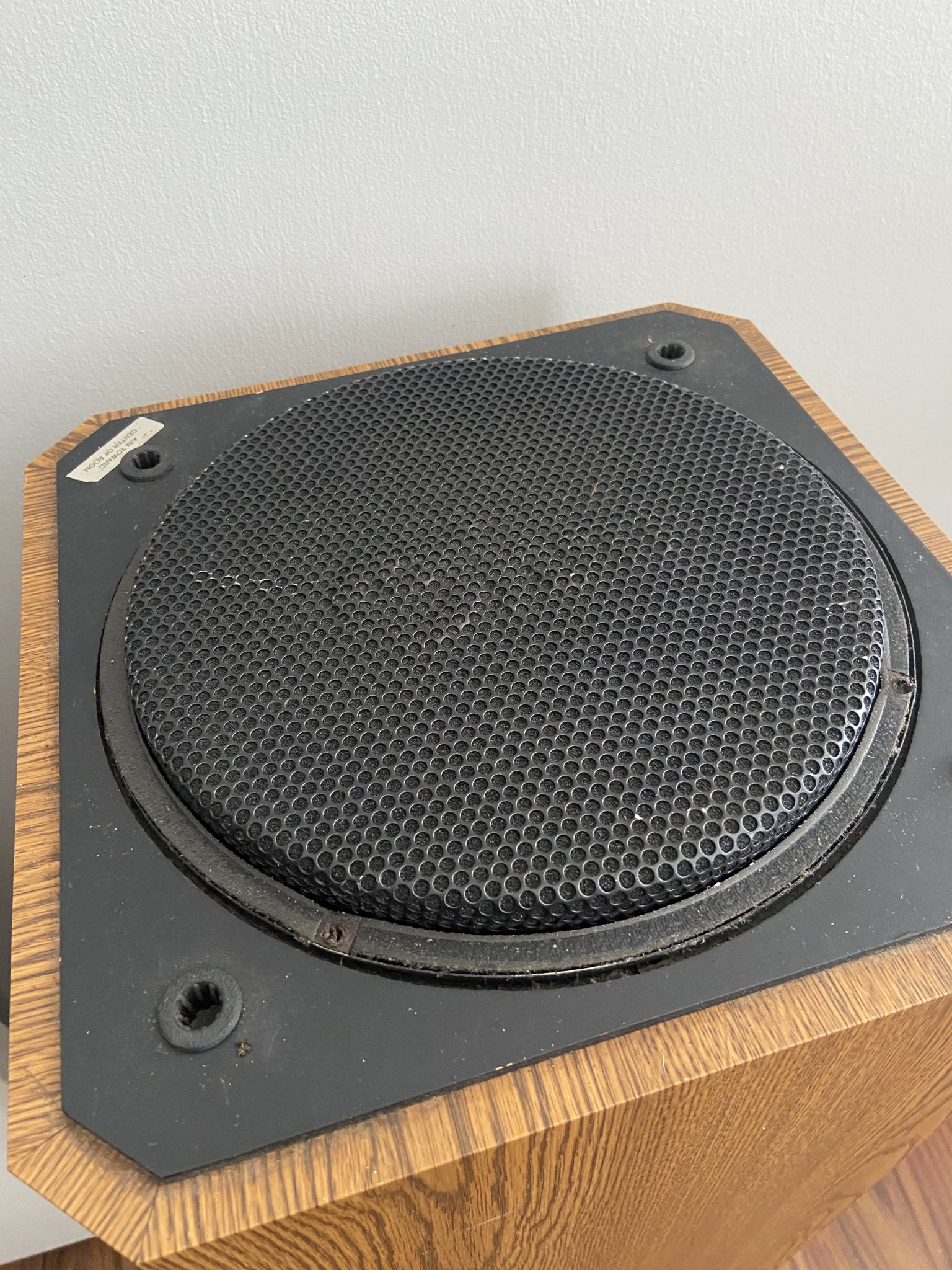

The key to EASILY getting these apart is a heat gun! Top and bottom of the mesh "cans", and the gasket material just peels apart with very little effort. Wondering now if I should just make it completely modern, with new drivers, and just keep the vintage cabinet. Woofer is 8". First pic is the "can" flipped upside down

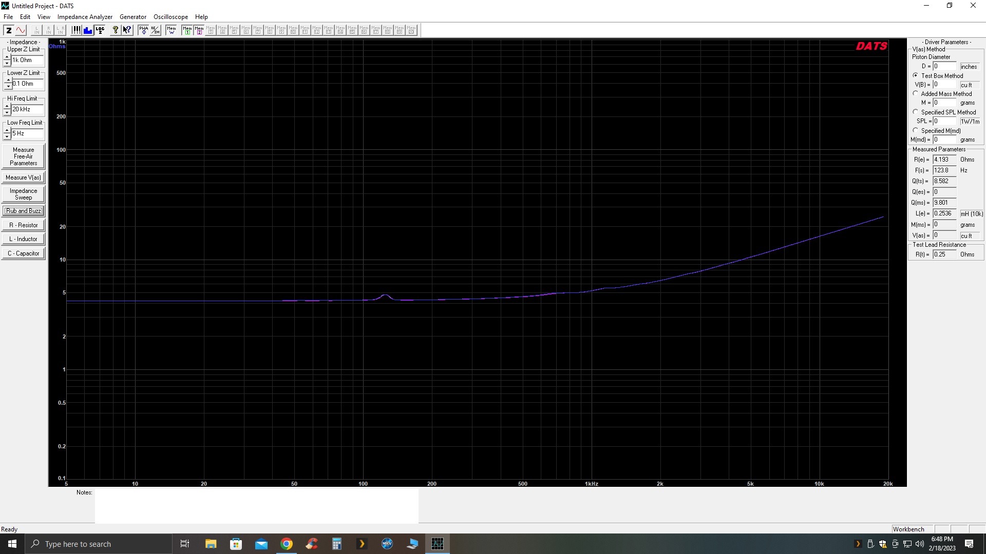

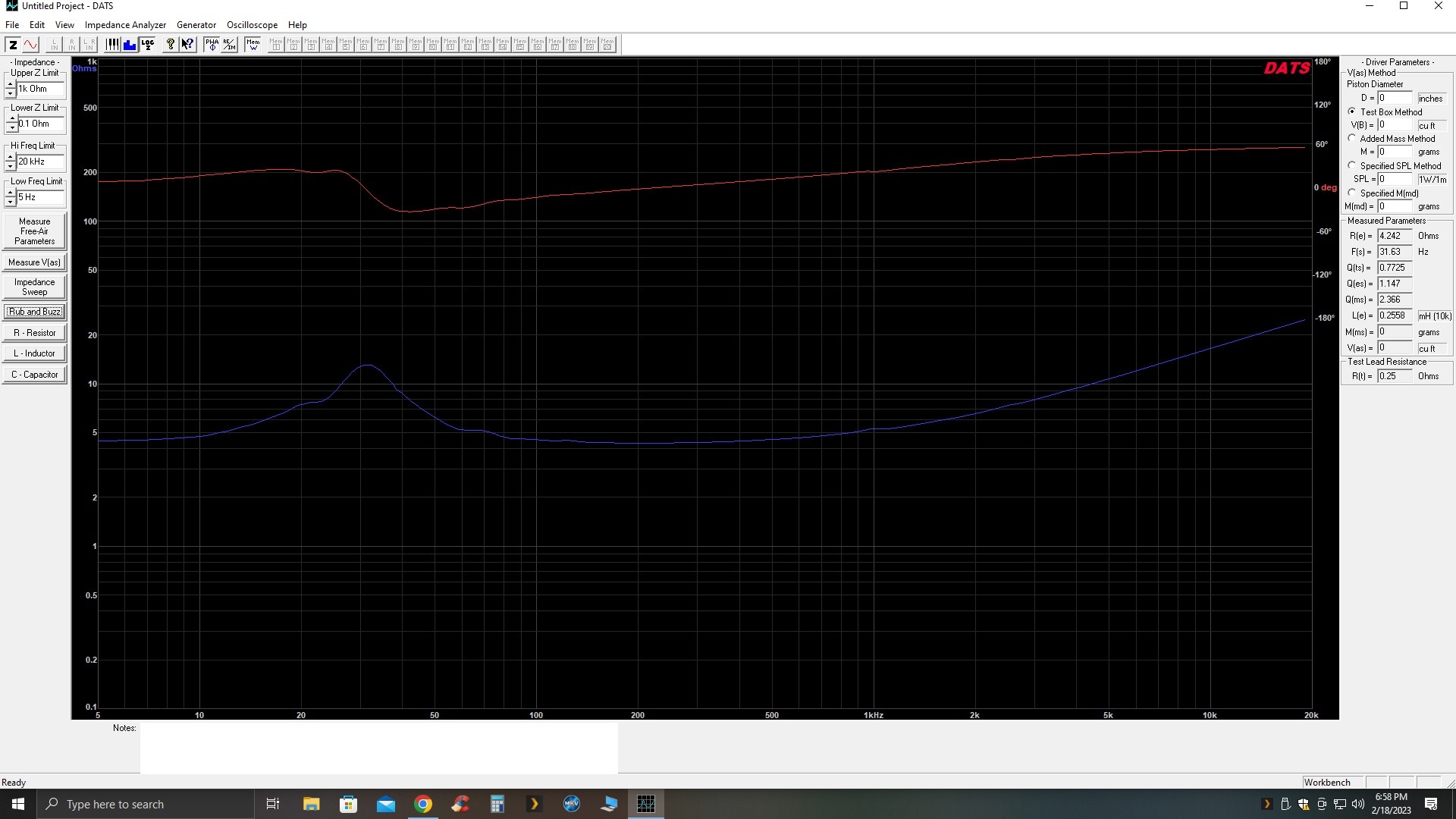

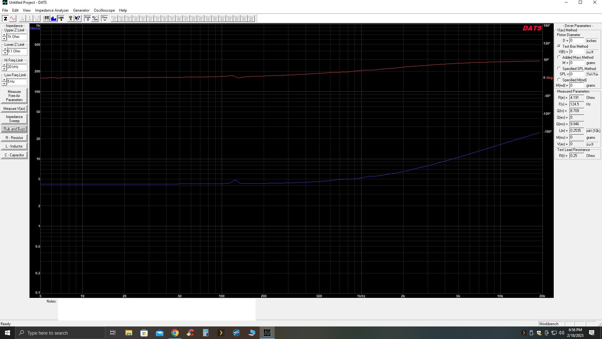

DATS results from measuring the drivers. Woofer tests were done just to see if they're worth trying to re-foam them.
Tweeter #1...
Tweeter #2...
Woofer #1...
Woofer #2...
Something wrong with one of the woofers 🙁

I think it is sort of critical to have a functioning surround if you are going to measure them.
The magnet on the driver at least looks to be a decent size.
Might be worth re foaming just to go through the exercise of doing it anyway.
Just measure the voice coil resistence first and see if they match.
Close enough for a re foam as long as the cones appear to move when centered.

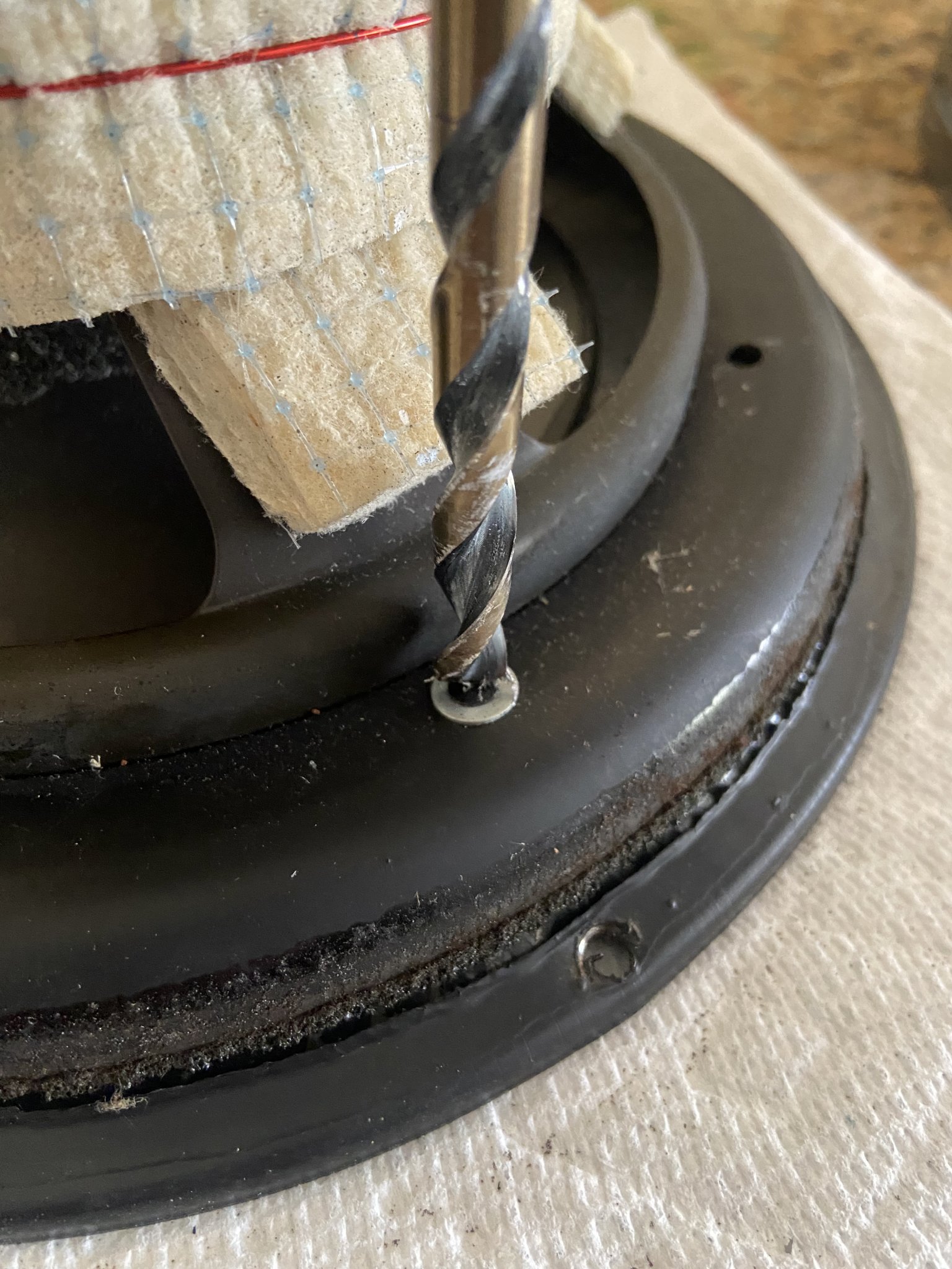

And then you have to drill those rivets out and then...
Who knows, maybe you can re foam that one without removing the rivets.

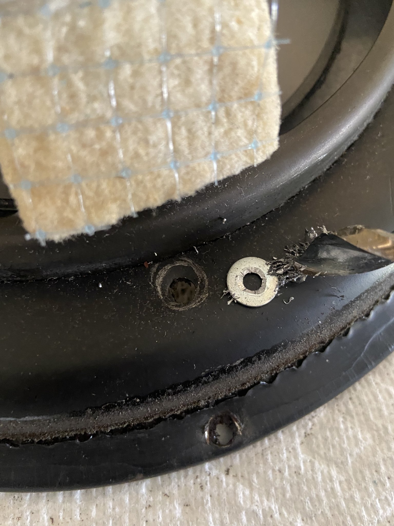

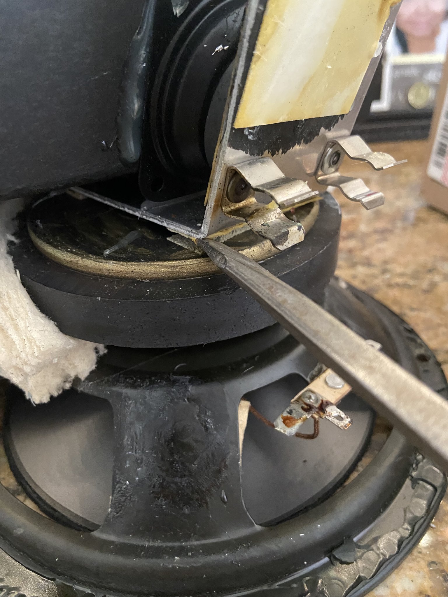

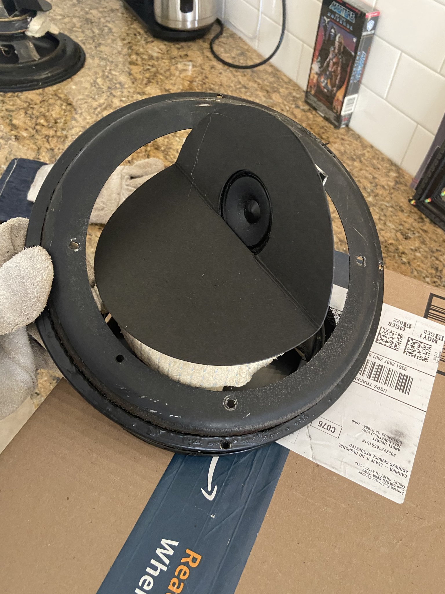

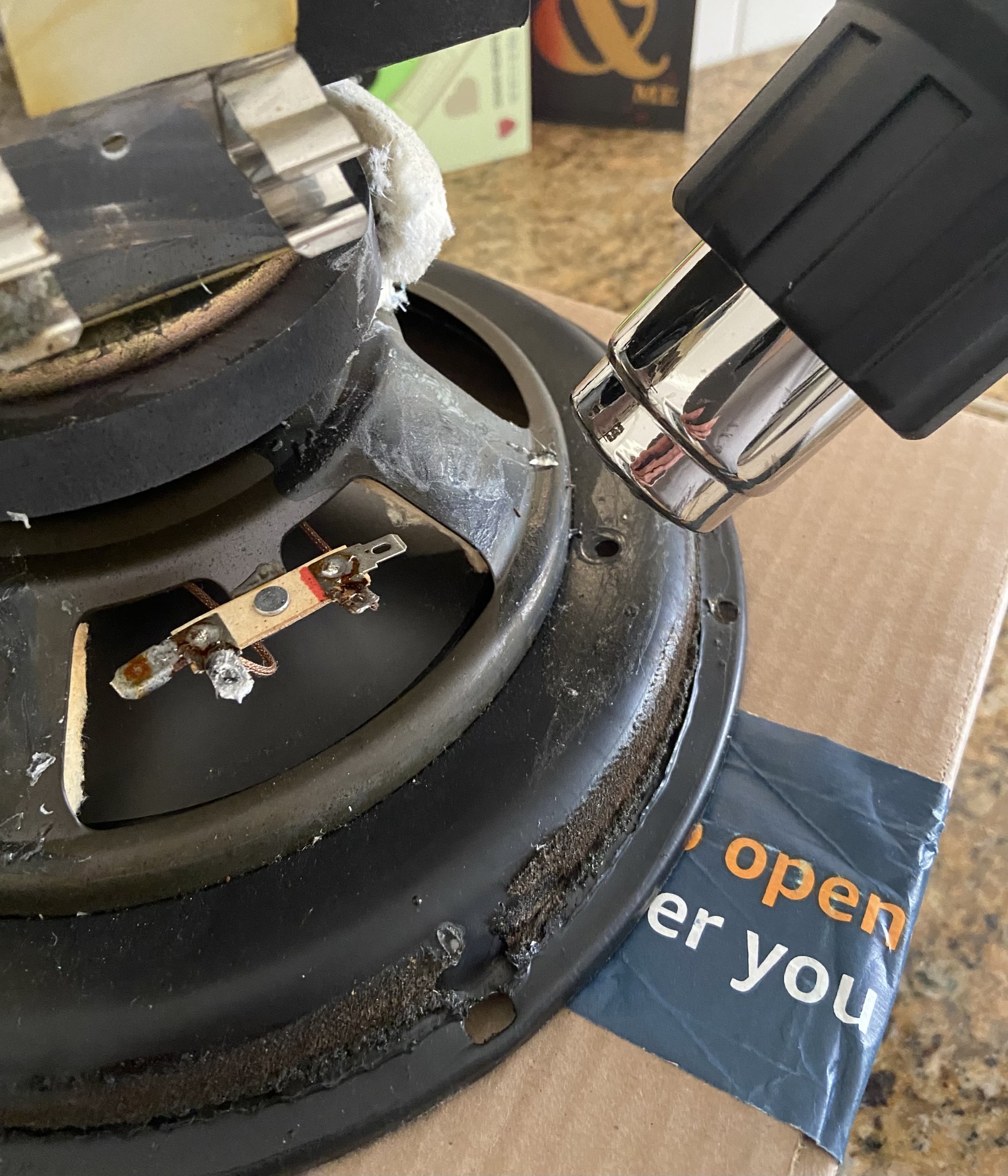

Decided I'd upgrade the woofer rather than repair this one. Drilled out the 4 rivets and used heat gun to soften the adhesive to separate baffle ring from woofer. Pried up on the tweeter to separate it from the woofer magnet...
