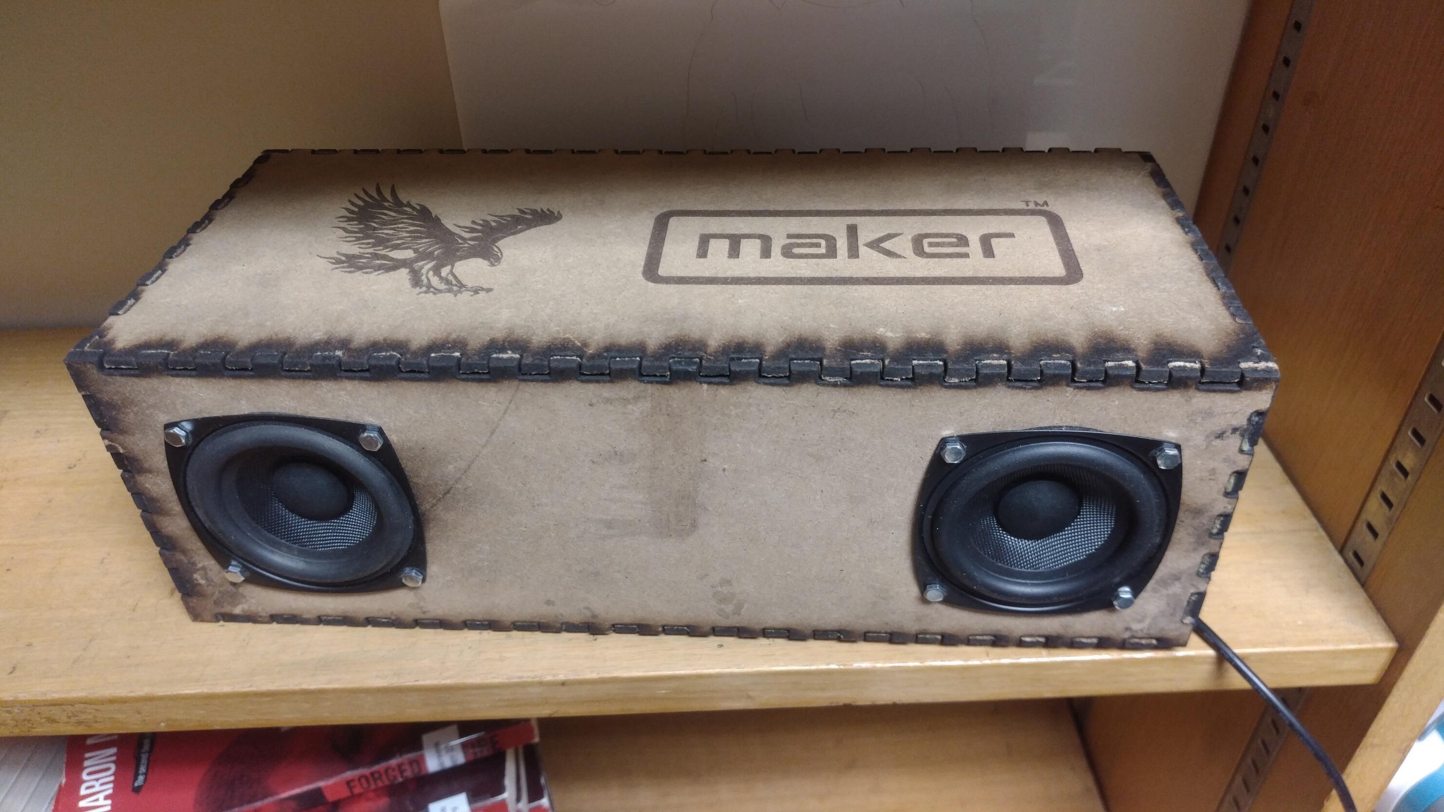

I just sourced parts for a similar project for my middle school makerspace. I too needed to keep the cost down, but wanted a decent sounding product the students would be proud of. Since we have so many old chromebook power cords, I chose the TPA3100 with bluetooth from Sanwu. The TPA3100 works well with 19v, has a reputation for decent sound quality, and was only $5. For drivers, I would have liked to use the B3S or Fountek FE85, but $20 for stereo drivers is too much. I just spotted the new HiVi C3N-III now as I look, but went with the Dayton Audio CE65W-8 for $5.20 each. The HiVi and Fountek both have suggested filters for optimal sound, but that would have also increased the cost. I bought a cheap set of male 5.5 mm barrel connectors for the power supplies and 5.5 mm female jacks for the speakers. The plan is to have the students design their speaker enclosure and cut it out of 1/4" birch plywood with the school laser cutter. Here is a great tool for designing finger joint boxes. The total cost of each speaker will come in under $20 if you have cheap cabinet material available.
Here is my hastily built test out of crappy fiber board.
