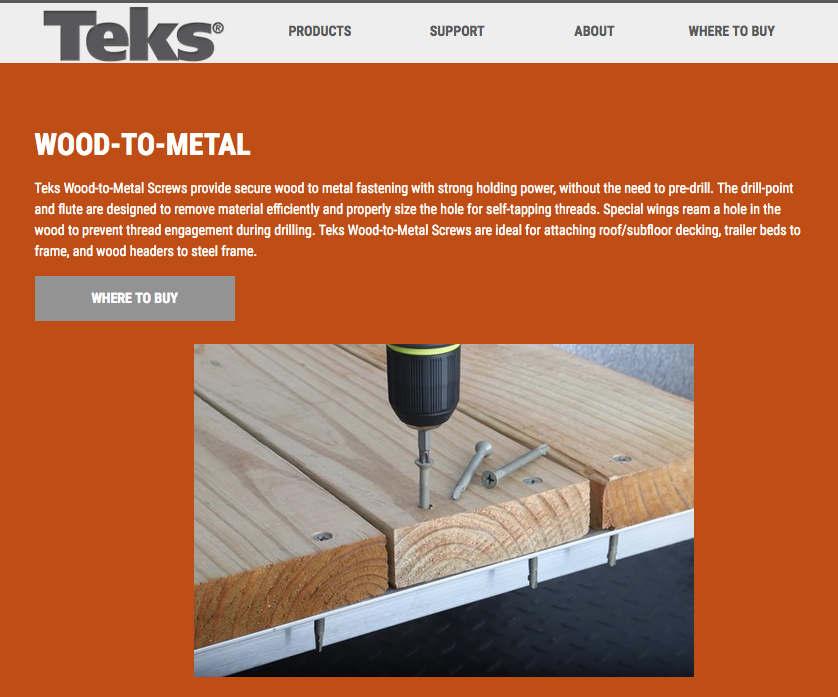

I LOVED when I could order big batches of specialty fasteners and fittings from McMaster-Carr when I managed a science lab…
I really like the idea of steel or aluminum square tubing frames for loudspeakers.

How did you attach the panels to the frame? I am thinking about using constructive adhesive along with a few screws to pull it in.
I would use a two-part epoxy , I would drill 1/2” holes in the tubes and use 1/2 oak dowel rods . I would drill a very small hole in the wood and then I would place the steel bars over those holes. I would cut the dowels about 3/4 of the what diameter of the steel tubes are. And when it’s all in place, put a small amount of wood glue on one end of the dowel and tap it into the hole of the speaker cab, and then mix up some fast dry epoxy and fill up the hole of the steel tubes and let it dry. It’s a lot of work, but after it’s done, nothing will pull them apart.

That is excellent joinery for sure! I am not sure I can get the requisite precision on the space frame welding for that. Unless I match drill.
