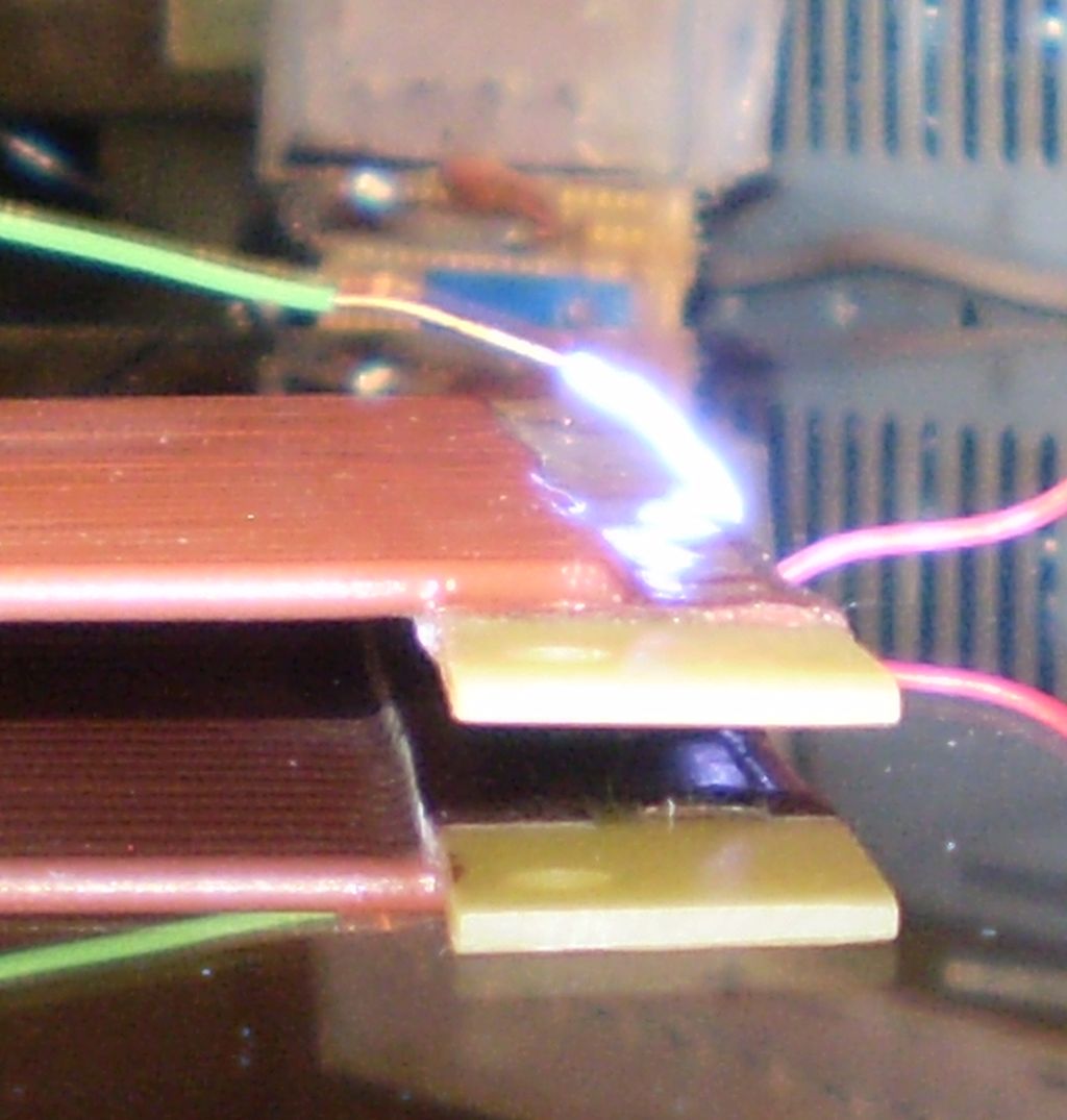

I am thinking about stator coatings for perforated steel stators. 😕
I sprayed liquid tape on a piece of copper and tested it with high voltage. It is hard to get an even layer and the result was arcing with a couple of thousand volts. Pretty useless for this purpose. 😡
It seems like acrylic clear coat has been used by forum members here. Rattle cans are quite expensive here and I dont know if I will get an even coverage. I am thinking about getting acrylic clear coat for floors. Then dipping the stators in it and then hanging them to dry.

Don't use any thing that is water based.
You won't get a good even coat by dipping and it will just be more of a mess than you realize.
Do use a Primer coat, Use only the red kind as it is loaded with Talc as a filler and this is good.
Red doesn't have Titianium Dioxide or Carbon black as a pigment, Gray and Black primers do, This stuff conducts at high voltages.
After the primer it is okay to use a thin color coat of your choice and after that finish them off with several coats of Clear.
You will need at least 8-10mil of thickness if not more.

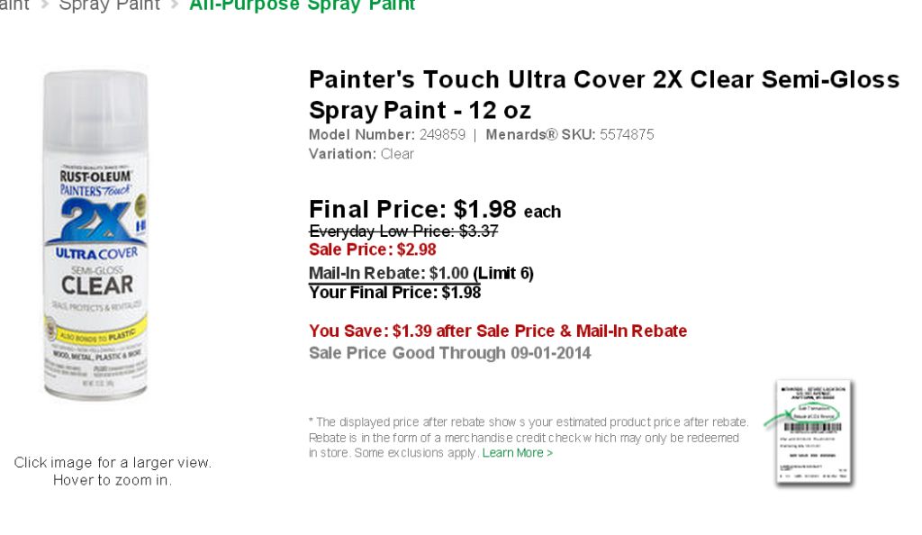

Yes, spray bombs can be costly unless you can find a good deal on them, clear is what you will need the most of.
If you have a sprayer then you can use Bulk paints of the automotive type.
Sometimes you can find the Dielectric Breakdown in their data sheets, as static charge and pump fires have been an issue in the past.
Liquid tape doesn't work worth a hoot for this application so don't waste you money on it I have already tried it.
I get 1500v to 2100v per mil of dielectric strength with common spray bomb Acrylic paints only if they don't have any pigments that are conductive as mentioned.

I had done this on my second set of wire mesh stator Desktop ESL's (they were black in color).
They worked great until I burned them up in some very extreme testing just to find out what their limits were, the limits were very high.
I had as much as 25Kv p-p across the stators before without any breakdown with a .150" stator to stator spacing and 5Kv to 7 Kv of bias on the diaphragm.

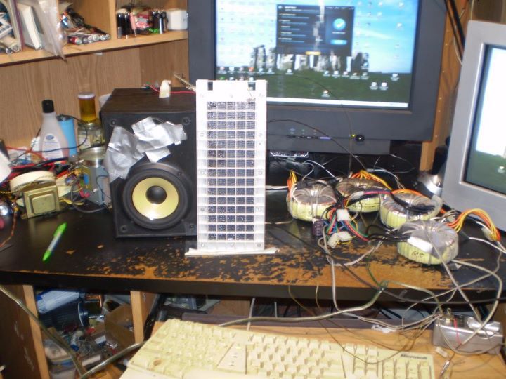

This thread shows my whole coating process using spray bombs,
A Segmented Stator Desktop ESL
Here is a picture sample of my results that can be found in the above thread and a Picture of my Powder Coated wire mesh version the very night I burned it for the last time. 😉

You want to avoid any sharp edges or at least get them covered at all costs!!
A sharp point from my wire mesh that wasn't properly insulated was the cause of failure of my best panels when they burned up.
There was no fixing them I tried.....Many times over!!!
There are close ups of this somewhere in these threads but I don't have the links of them handy at this time.
Once you burn the coating, the chance of fixing it is very slim!

I still have the wire mesh sample that I made in the pictures and it is completely flexible.
I get it out every once in a while to test it, and it has yet to form any microcracks and fail an HV tests just like in the pictures.
And, It has been about over 2 years now since I made it.

P.S. The best price I have on 2X clear here in the States is at Menards for $3.37 a can and I think it is on sale right now for even less at $2.98!!
Opps the picture I got was semi gloss but usually they are on sale at the same time.
I have some Semi gloss that I have been wanting to test as that stuff is loaded with Silicon Dioxide(glass powder)!! 😉
Yes, I just found the same in plain clear and it too is on sale, your in luck!! 😀
