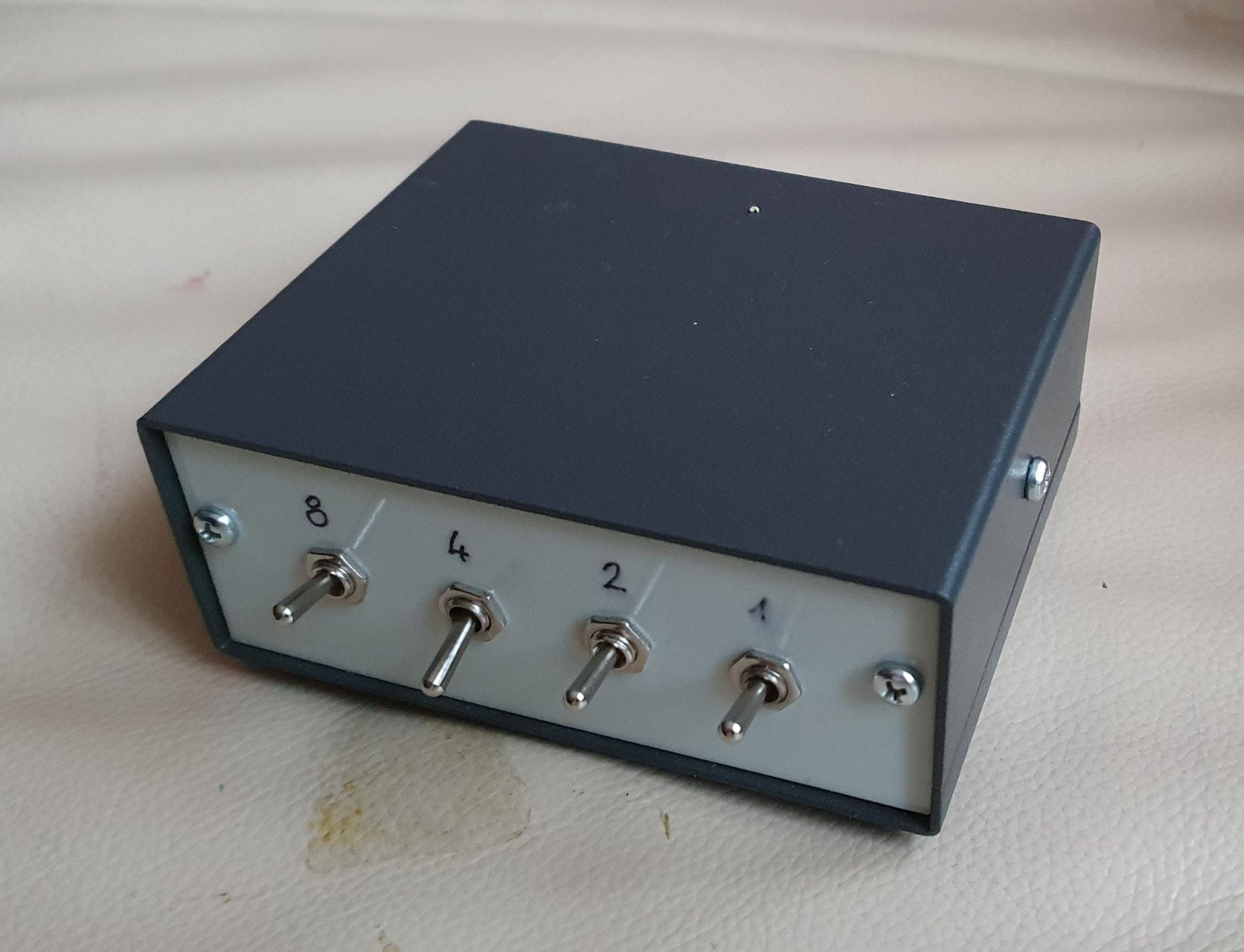

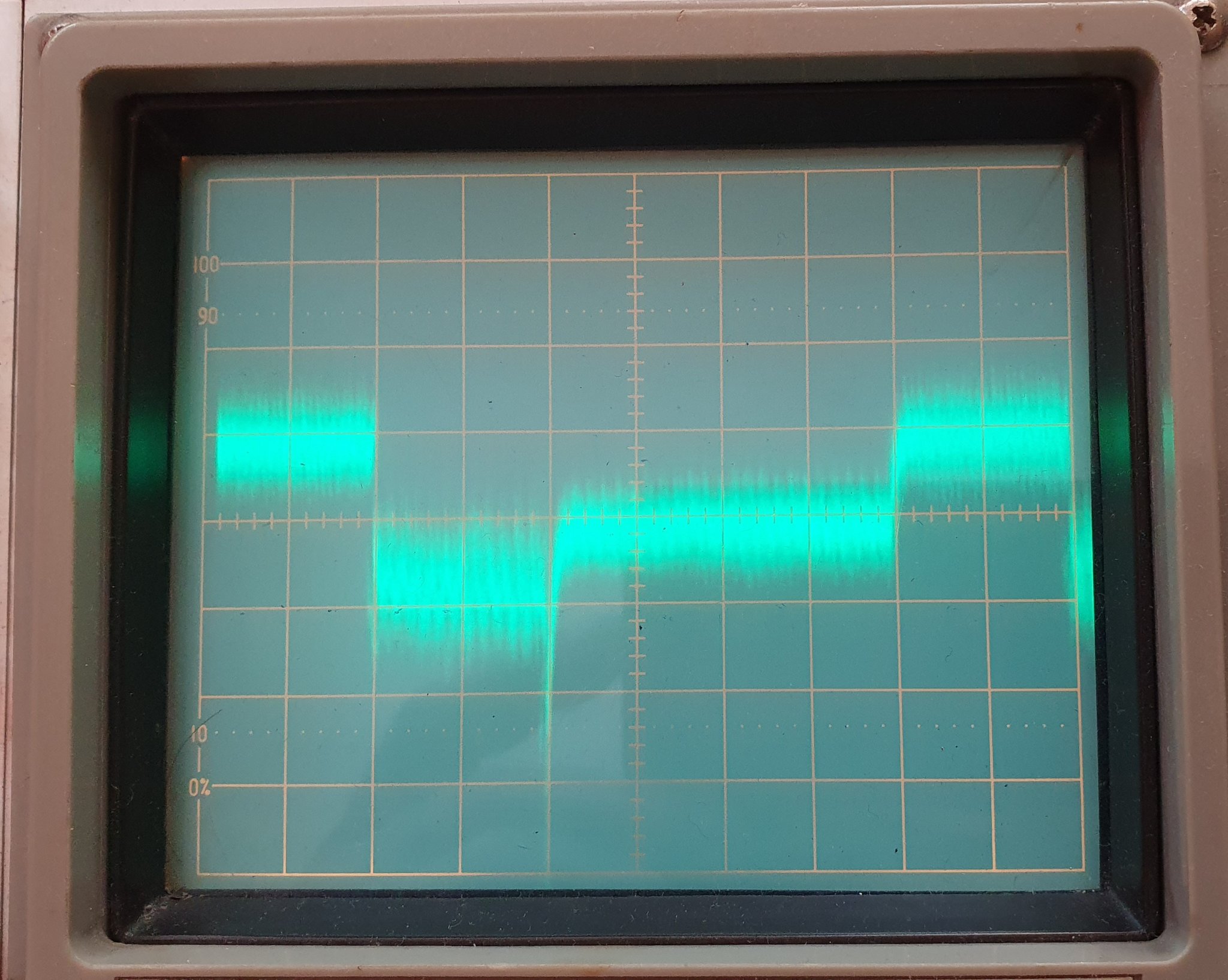

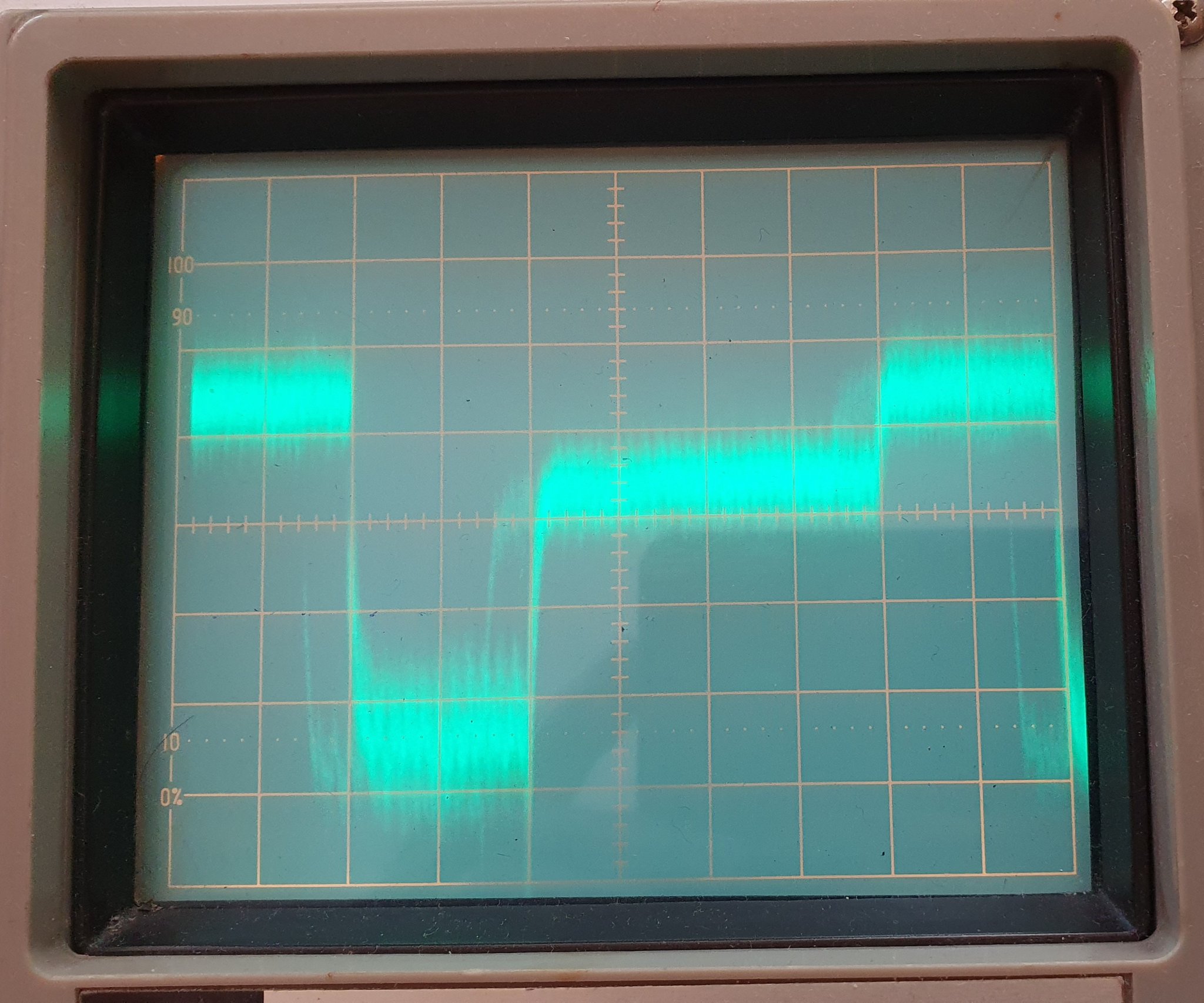

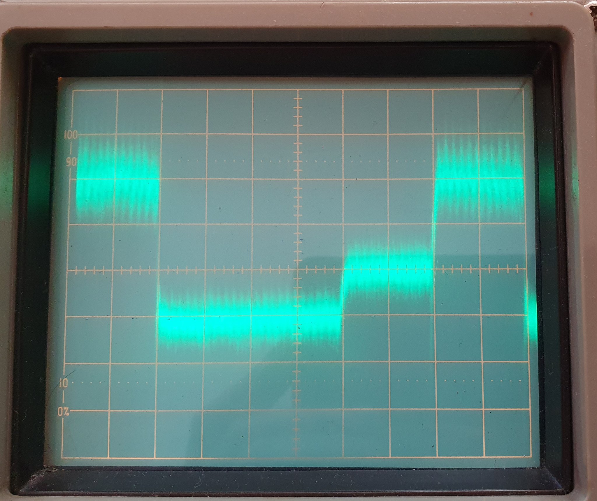

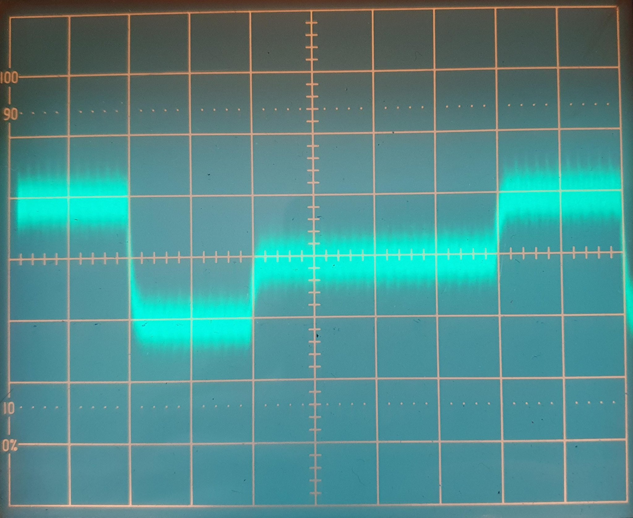

There is some progress. I built an I2S code generator device. It does essentially the same as the above mentioned DAC Linearity Test CD. It has four toggle switches A, B, C, D on the front panel, for selecting the bit # to be tested (bit #0 to bit #15). The output I2S signal is 12x WS interval bit #n -1, then 24x WS interval bit #n, then 12x WS interval bit #n+1.
For example, let's toggle switch A (weight 8), C (weight 2) and D (weight 1) that selects bit #11. The PCM binary code is 0000|1000|0000|0000. The output will be 12x 0000|0111|1111|1111, followed by 24x 0000|1000|0000|0000, followed by 12x 0000|1000|0000|0001. This 3-level cycle repeats. The resulting analog signal is on the attached picture. There is always 1-bit change, the magnitude is 1 LSB. The #n bit this can be visually checked.
I created it for checking the TDA1541A bit accuracy. Here the 15th bit weight is -2 mA, the bit #0 is 61 nA. After the I/V conversion @ 1.5 k resistor it gives 3 V for bit #15, and 91,56 uV for bit #0. It is difficult to view so small level change on an oscilloscope, for this reason I built a x100 amplifier (NE55434A). The resulting cca. 10 mV steps can be clearly seen.

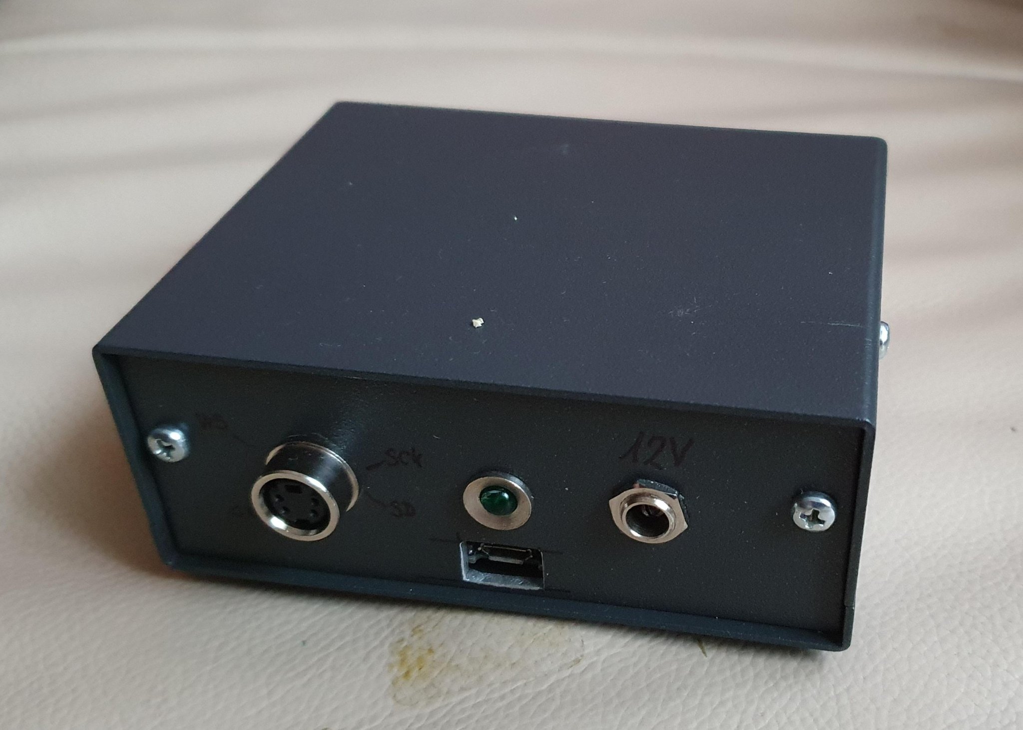

The pins of the Wemos D1 mini board are connected like this:
Switch A (weight 8) - D6 (GPIO12)
Switch B (weight 4) - D5 (GPIO14)
Switch C (weight 2) - D2 (GPIO4)
Switch D (weight 1) - D1 (GPIO5)
WS/LE - D4 (GPIO2)
SCK/BCK - D8 (GPIO15)
SD/DATA - RX (GPIO3)
3V3 - to toggle switches position "ON"
G/GND - to toggle switches position "OFF"
The board can be powered from USB or from the 5V pin.
The assembled device is on the pictures.

The analog signal zero crossing is at -2 mA at the DAC output, that is +3 V at the I/V converter opamp output. At this point the PCM code changes sign from 0111|1111|1111|1111 to 1000|0000|0000|0000, or 0x7fff to 0x8000 in hex. The MSB is also called "sign bit". This is the reason why is the accuracy of the MSB (bit #15) so important, because zero crossing is the most frequent event in any waveform and music.

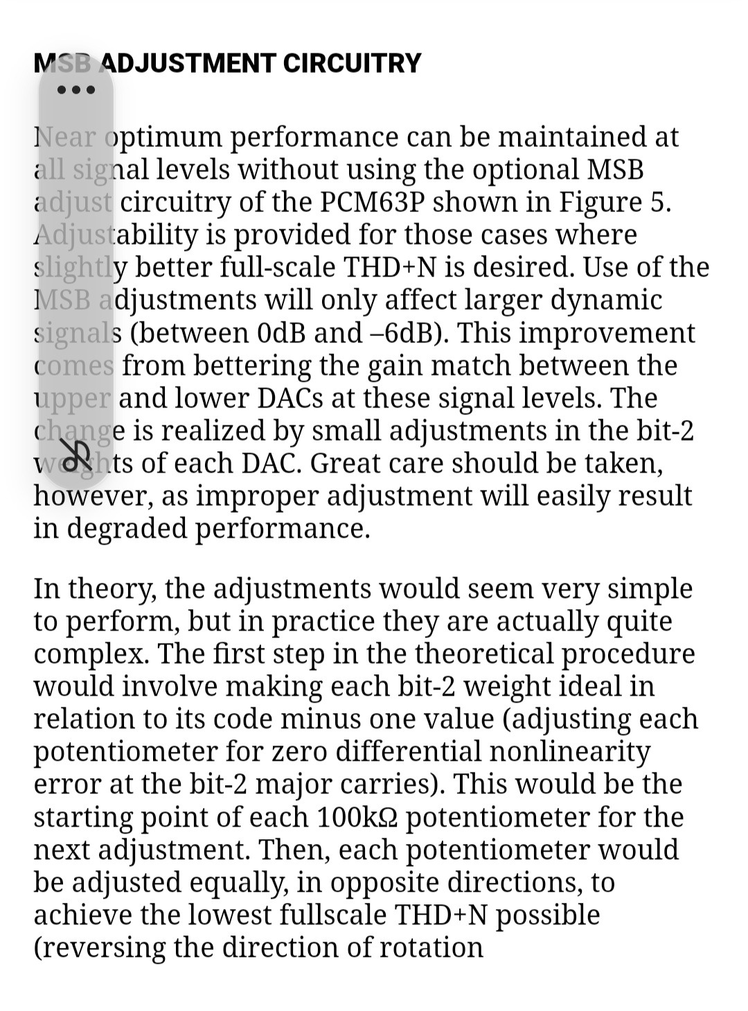

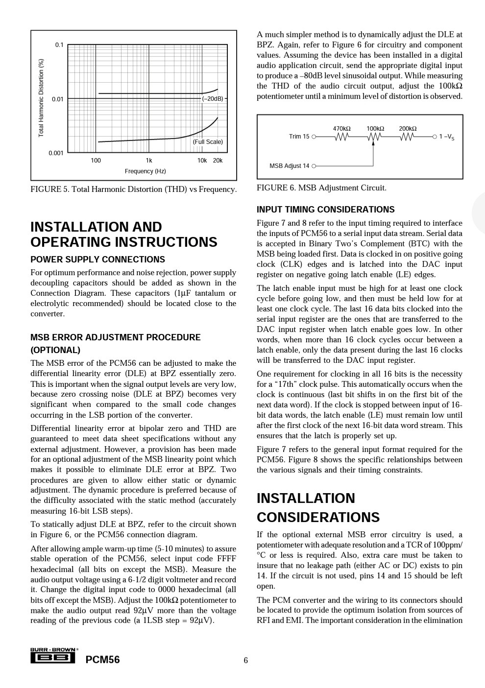

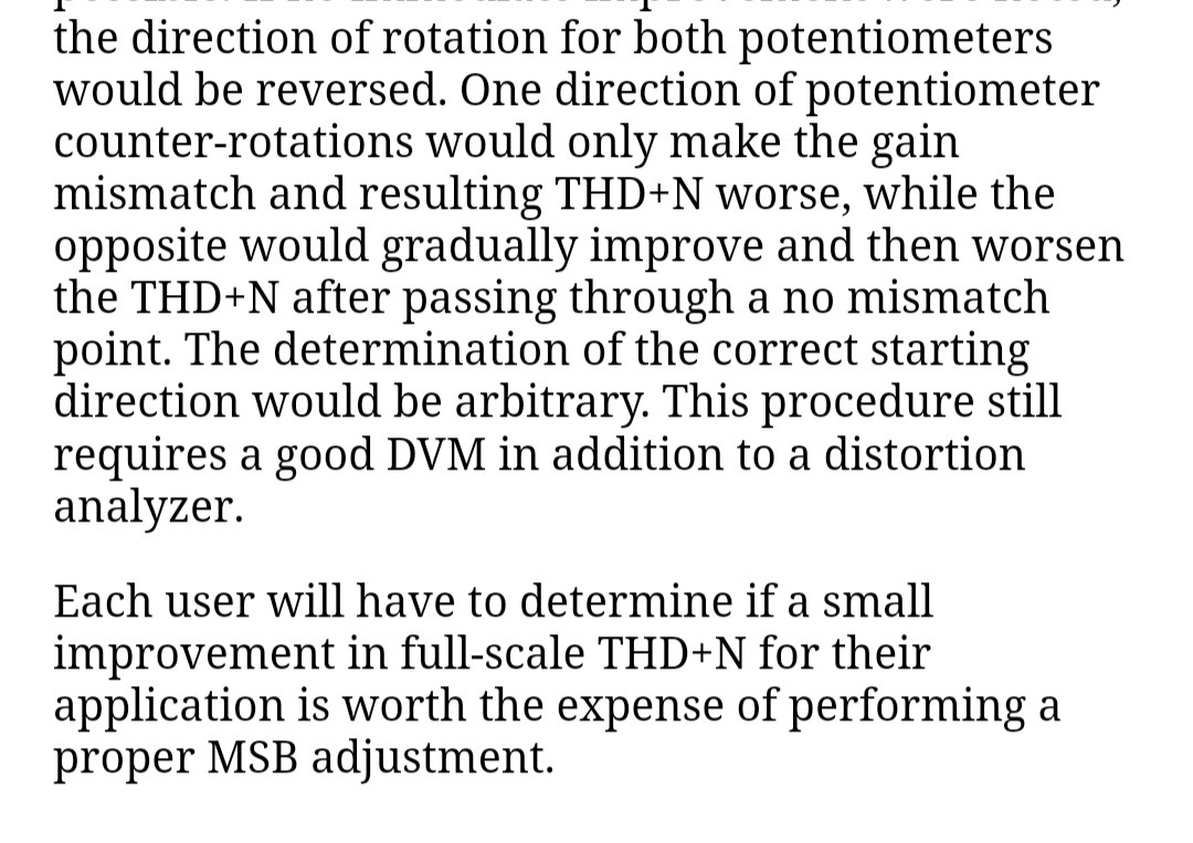

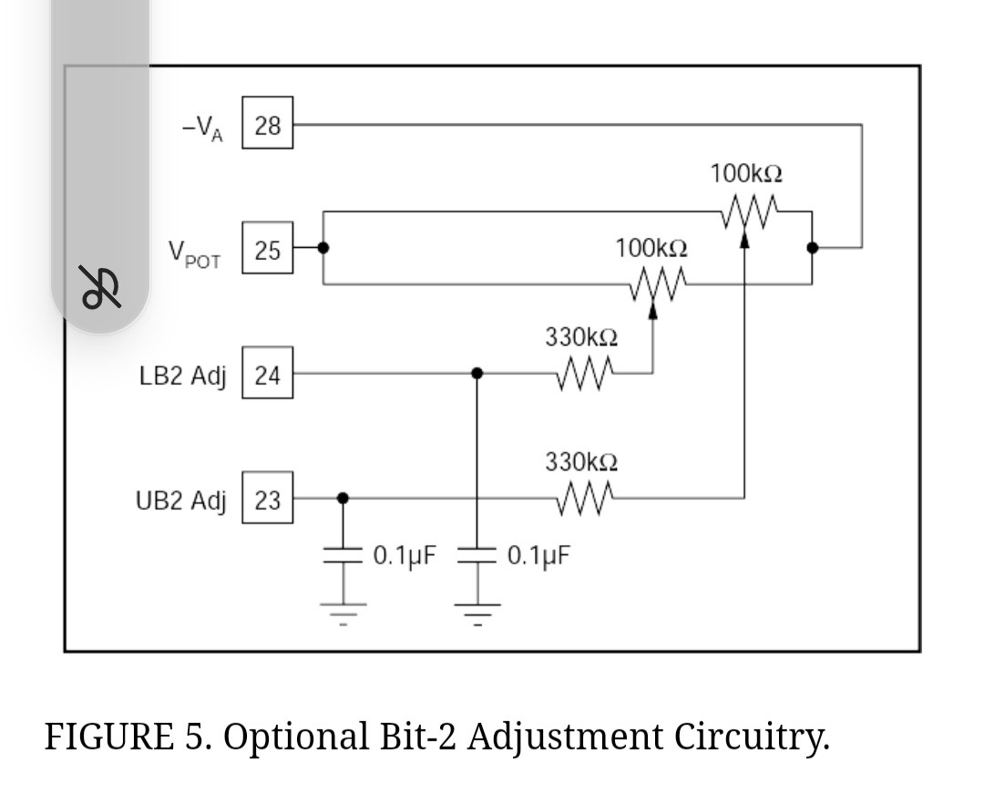

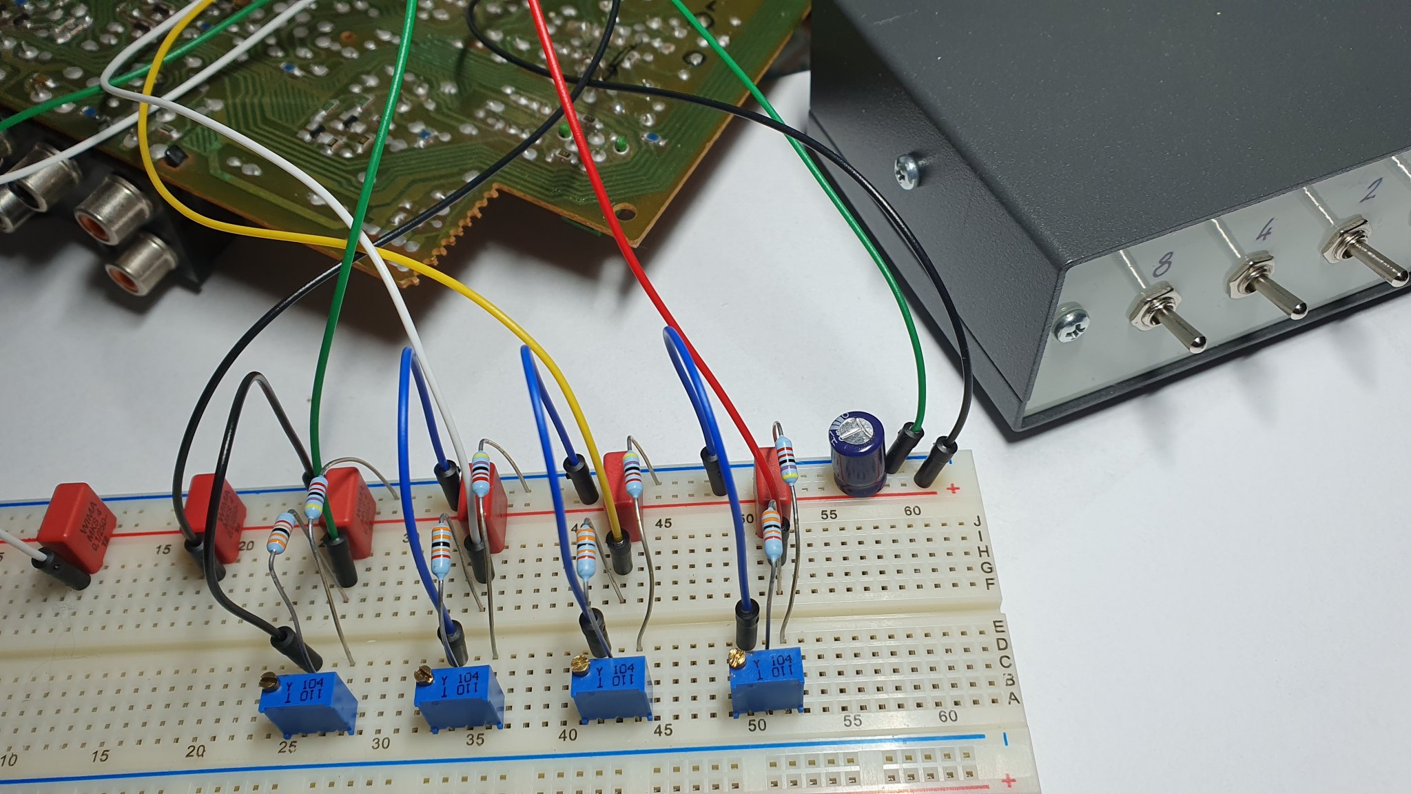

What I wanted to do with all this is to fine-tune the bit currents (or at least the MSB). It is possible to add or subtract a fraction of bit current through the decoupling pins. The idea came from the PCM63P adjustment method (see attached), although a bit different. I will open a separate thread on it.
