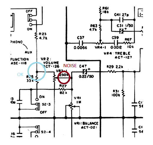

Hi. I've just replaced all the electros and bias a Pioneer SA408. Nice little amp from late 70'.
There's a noise. It has two layers: an almost continuous "ptz" and another glitchy sound that comes in like every 2 seconds. Sometimes other artifacts can be heard. The noise is above the hum at the background. At night or at quiet moments it's annoying. That noise stays at the same level no matter the volume. The loudness and other switches don't affect it either. The bass & treble pots do affect it. At least, that's how it sounds like. I'm going to make some recordings. This noise was before all the recap and such, but I've always thought that it was due to aged components or so.

Having said that. I have a poor-man signal tracer. I can listen the signal along the path, but I don't have any kind of equipment like o'scope and such.
Before the vol pot there's no noise at all. but right at the wiper there it is the noise. I don't understand it, there's a capacitor blocking DC. Is it some kind of AC noise generated by the preamp/amp section?
Even though there's no DC on the pot by virtue of blocking caps, the pot wiper's intermittent contact can still "gate" the audio off and on as is rotated. It's great to have lab equipment, but ears are useful, too.
I've desoldered the vol and balance pots, as well as the switch that manages the loudness and tape monitor functions. No luck.

It's the 56pf cap to ground at base of Q2. I removed it from one channel and no noise whatsoever. What is doing that cap? Any problems if I live without it or should I try another value?
God, I've even matched some BC560 to replace the SA798(Q2) and it turns out that it was a small tiny cap.

Both channels behave the same. With the cap there's noise. I increase it to 100pf and the noise becomes louder.
Without the cap, they are silent. I think I can very softly hear the noise when I put my ears touching the speaker. But I'm not sure if it's just my brain making it up. I have to check in a really silent environment. Even though, it would be negligible .
