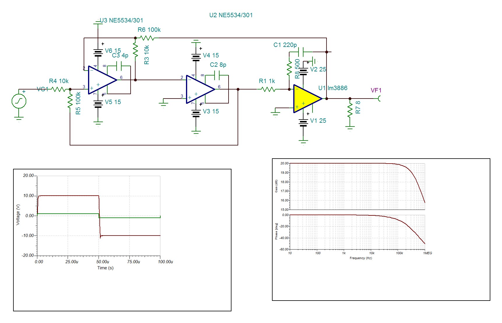

State Variable Power amp by LM3886
Disabled Account
Joined 2015

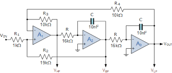

A state variable is a multistage filter that provides LP BP & HP as this
attachment.php
The idea is to replace the second integrator by the power opamp as LM3886.
attachment.php
For now I adjusted to provide extra 20db NFB for a gain of 20db. That is it can have 10 times less distortion than standalone with the same gain.
