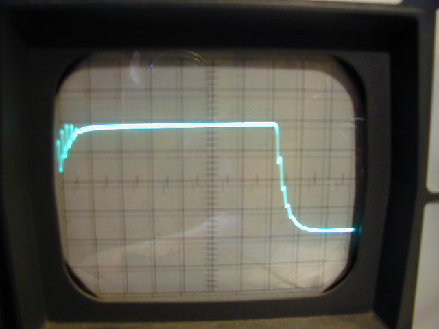

i fixed a STASIS2 and did change all outputs in MJ15024/25 for one channel. This channel shows the following picture when feeded with 10khz rectangle wave, Sinus wave looks ok.
Do you know what is the reason for, i already did change the driver boards and the power rails and did a complete resoldering on this output board without effekt.
how i should interpret this picture, is it spikes or oszilation?
thanks for your helps

i found , i have to give more bias, what should be the right value in V/DC across the 1 Ohm resistor after warm up ?
docjoe wrote 0,7 to 0,8 A which means 700 to 800 mV is that ok ?
I am worry about to give so much bias, now its about 100mV and temperature is 46°C

remove the fuse of the negative supply voltage and connect a amperemeter - total bias should be around 700 to 750 mA, so that your heatsinks reach 40 to 50 degree celsius.
I guess your setting is ok but a good stasis2 will not have spices nor oscillation as shown on your picture, so check the condensers on the driver board, even the small tantalum pieces will make the problem with oscillation. Whats about the DC offset?

That is oscillation, or at least a peaking condition stimulated
by the square wave. You'll end up screwing around with
compensation to get rid of it. I assume that the output RC
network to ground is still there.
I don't recall any tantalums on Stasis amps.
The bias should be set for about 25 deg C. above ambient,
and most of the time it works to about 50 deg.

I have exactly the same problem which gives me headache right now.
I assume the original Statis 2 output transistor is slower than MJ15024/25
http://www.diyaudio.com/forums/showthread.php?postid=723969#post723969
A brief. For CFP output stage, it works OK for output transistors with slow speed (mine is OK with TIP35C ft=3Mhz).
But with the same CFP cct, just changing the output transistor to the faster one (I change TIP35C to 30Mhz C5200), it automaticly becomes an oscilator. It oscilates at Mhz region. It seems it oscilates by itself.
Mr. Pass suggest putting base stoopers with values to be tried. I haven't got the optimal R value here, but what I'm afraid that base stoppers do not sufficient to counter this problem.
Anyone has other suggestion what to do with CFP+highspeed device?

The problem shown on the oscilloscope-picture was gone, when I give more bias, only bias to low thats all
